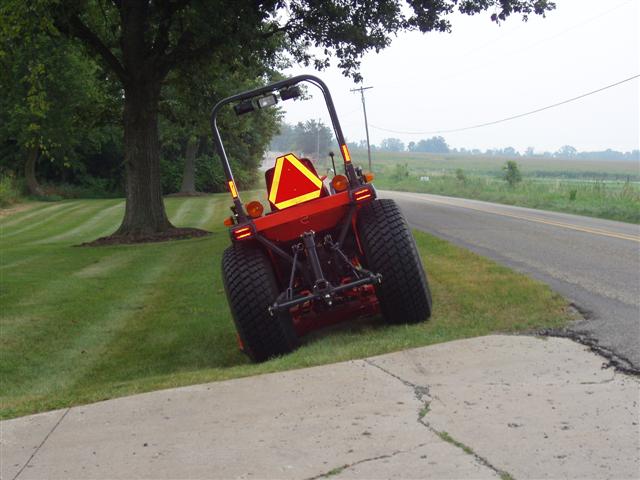

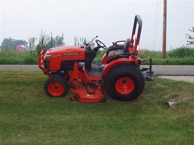

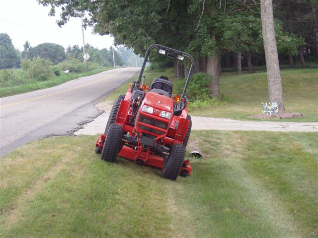

Charlesaf3,
I have a B3030 and even though my 3.5 acres is pretty level I do have a few spots that slope pretty good. Here is a picture of the steepest part of the "ditch" alongside of the road. I have never felt at all unsafe on this while mowing. Hope it gives you an idea of what a B3030 will do. I am very happy with mine. Good luck.

I think that is very true. I also think you are getting a false sense of security driving this bigger tractor. It won't feel as "tippy" as the 3030. I'll go on a limb and say the difference between the two tractors as far as tipping point is very small.
I'm attaching a very good document that explains all of this way better than I can. Hopefully it will give you some helpful data.
