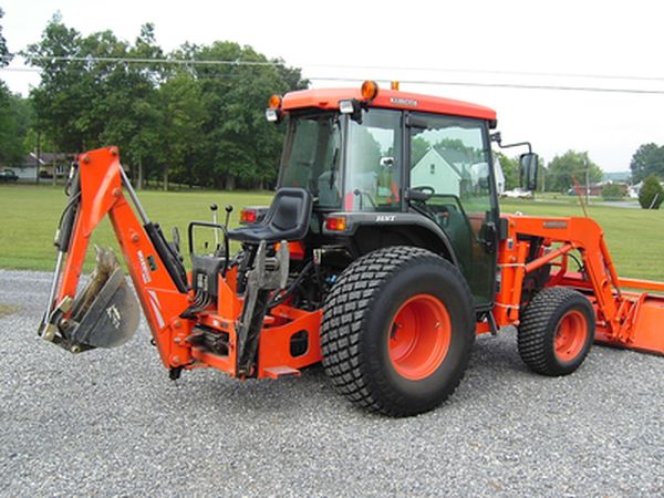

You'll love the 3430HSTC. I have over 200 hours on mine with no troubles whatsoever. I've attached a photo of my 3430 with my little backhoe attached. I chose the wide turf tires (18") over the R4's because I mow alot of grass and don't want to tear up the turf. The turf tires work great, even in the winter for plowing snow.
Bill
