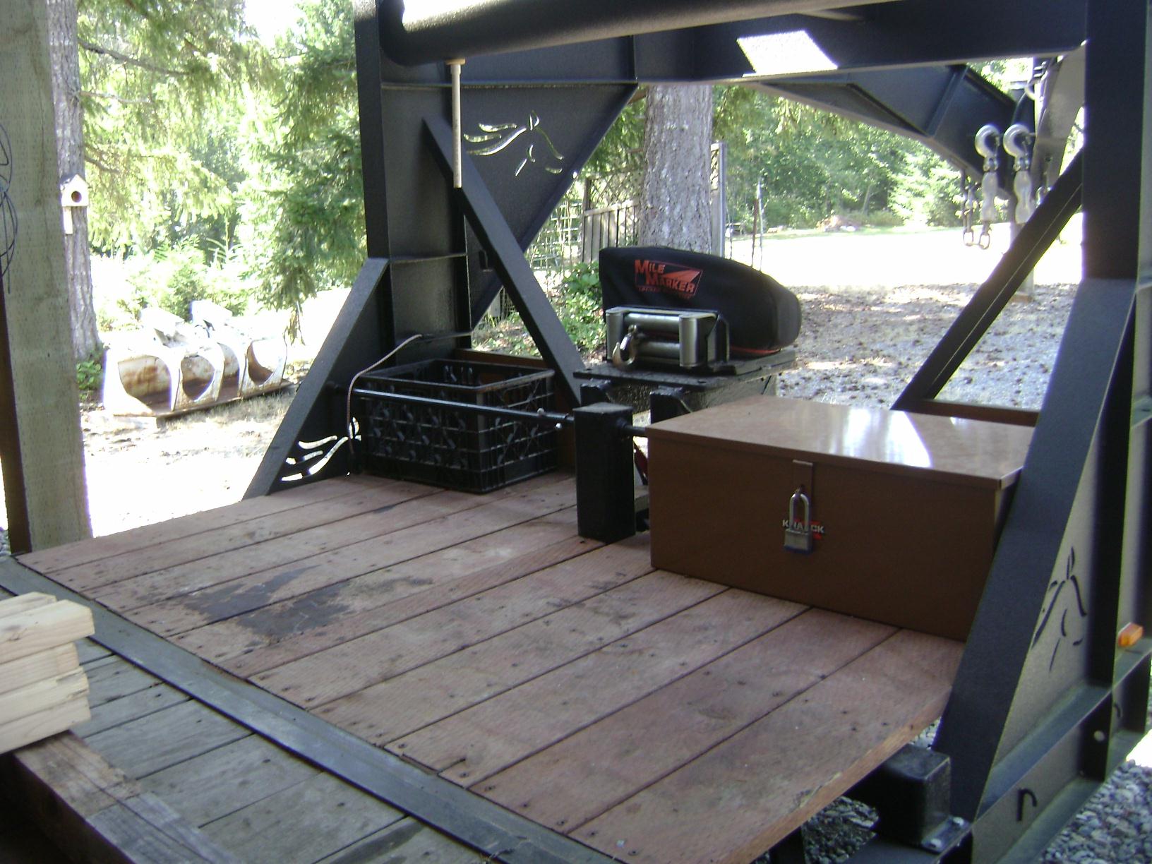

That goose neck adapter is neat- Looks like some extra deck space is ( or could be) created by bolting it on?

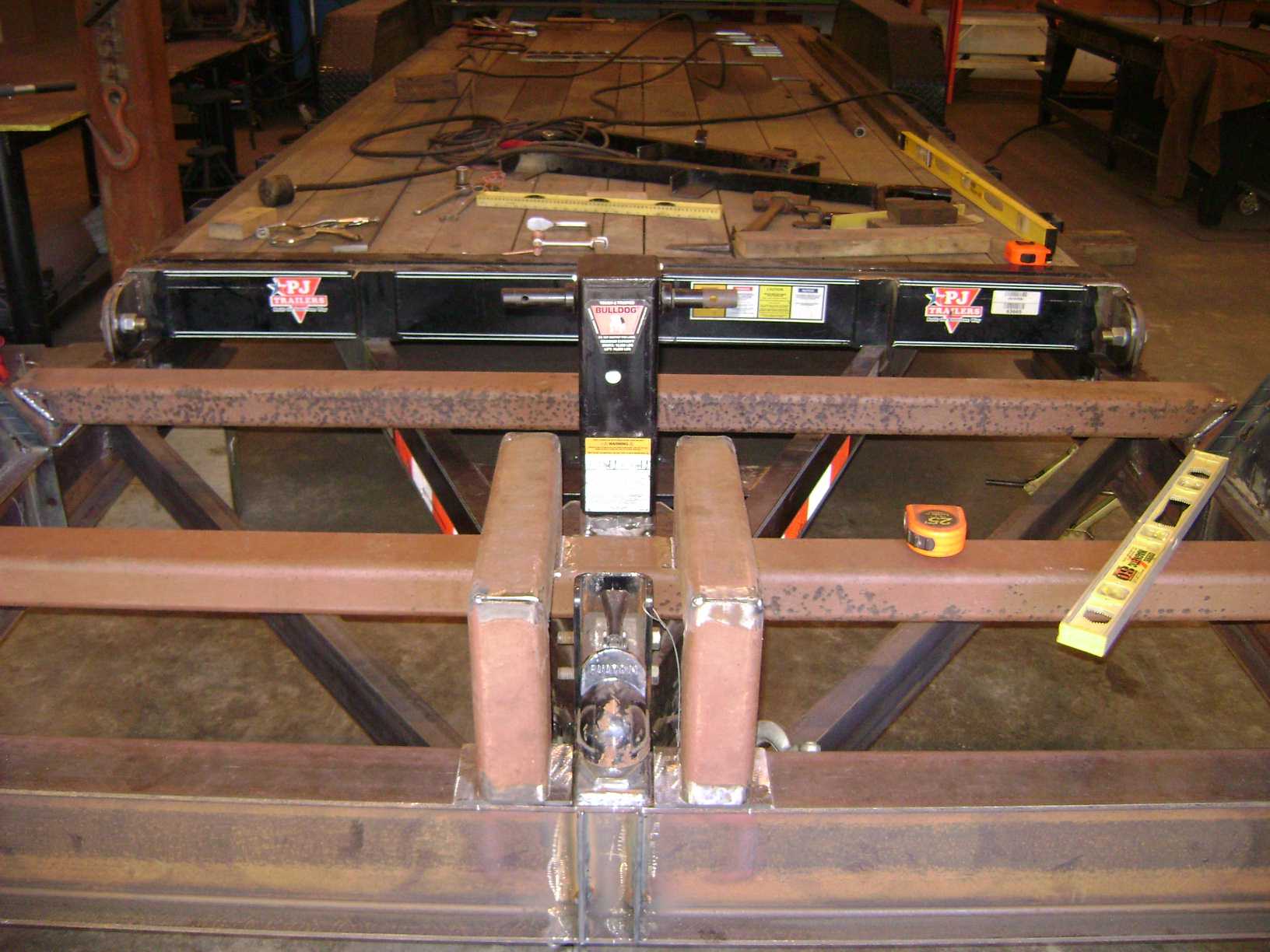

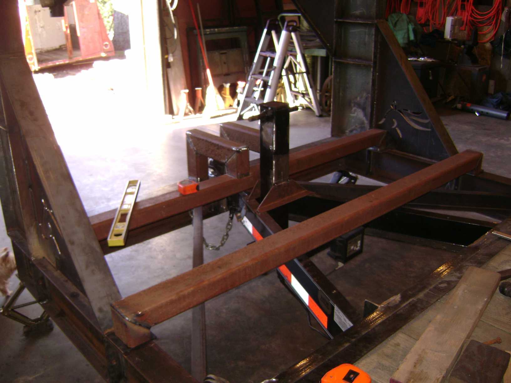

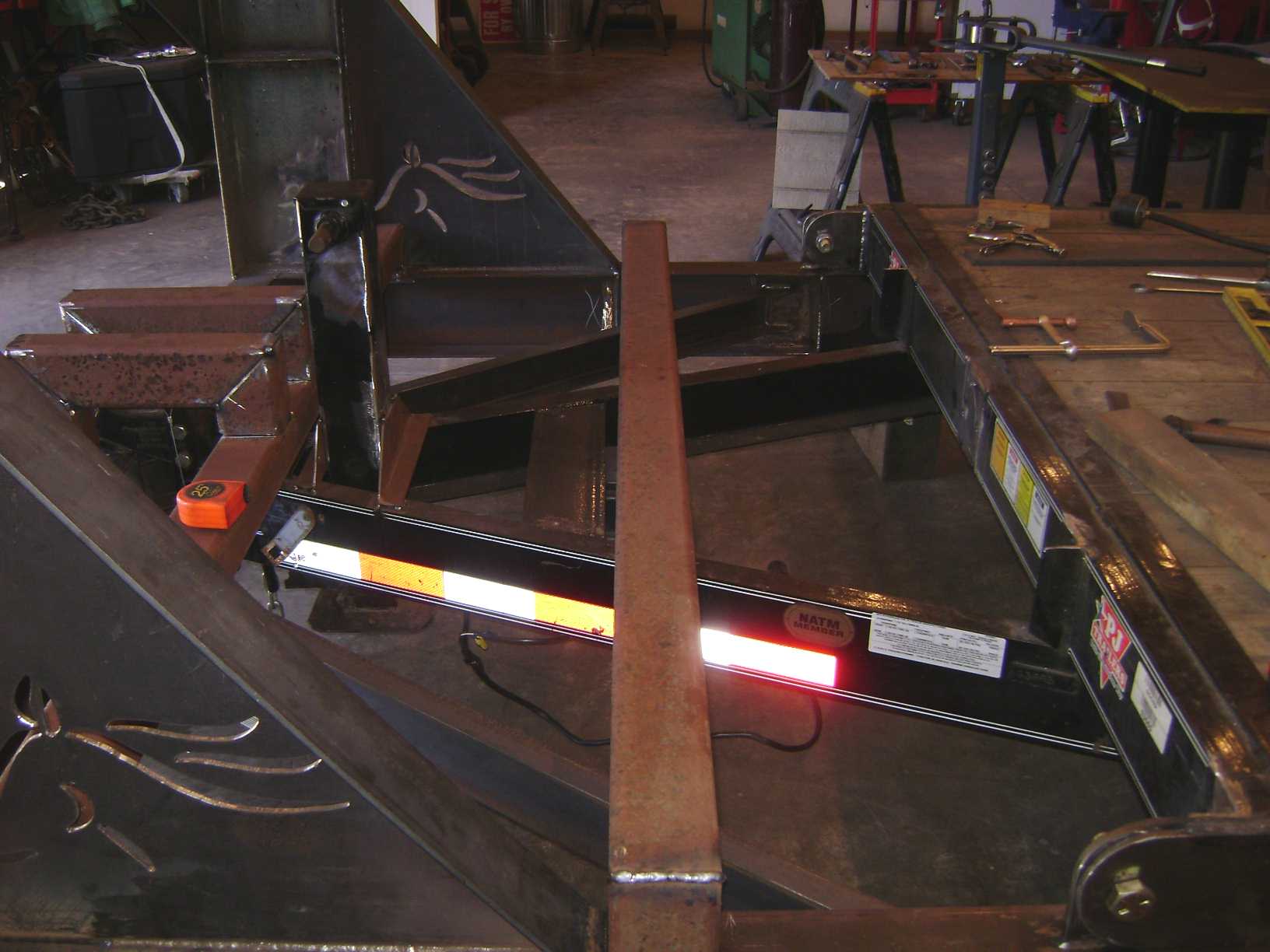

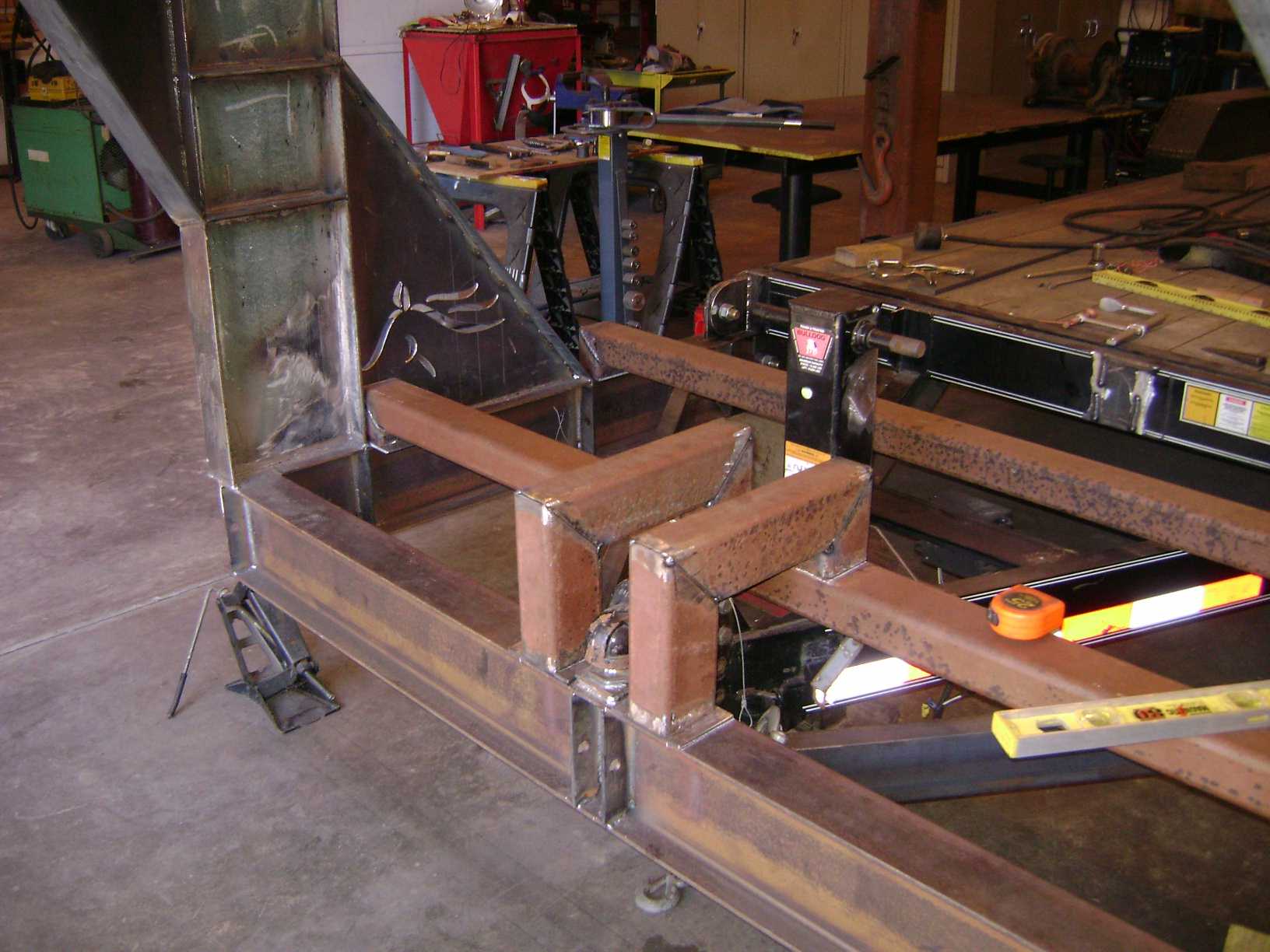

okay for discussion purposes, I know you can haul more weight on a goose neck because it put more weight over the truck axles but at what point do you add so much weight building the GN that it is not worth it to add the goose neck?
   / Gooseneck adapter build.
#14
I built some frame work for a deck over the trailer's tongue.
I don't know the answer to your question.
An engineer friend ran the numbers for this gooseneck adapter. He said it was good for at least 30,000-pounds.
