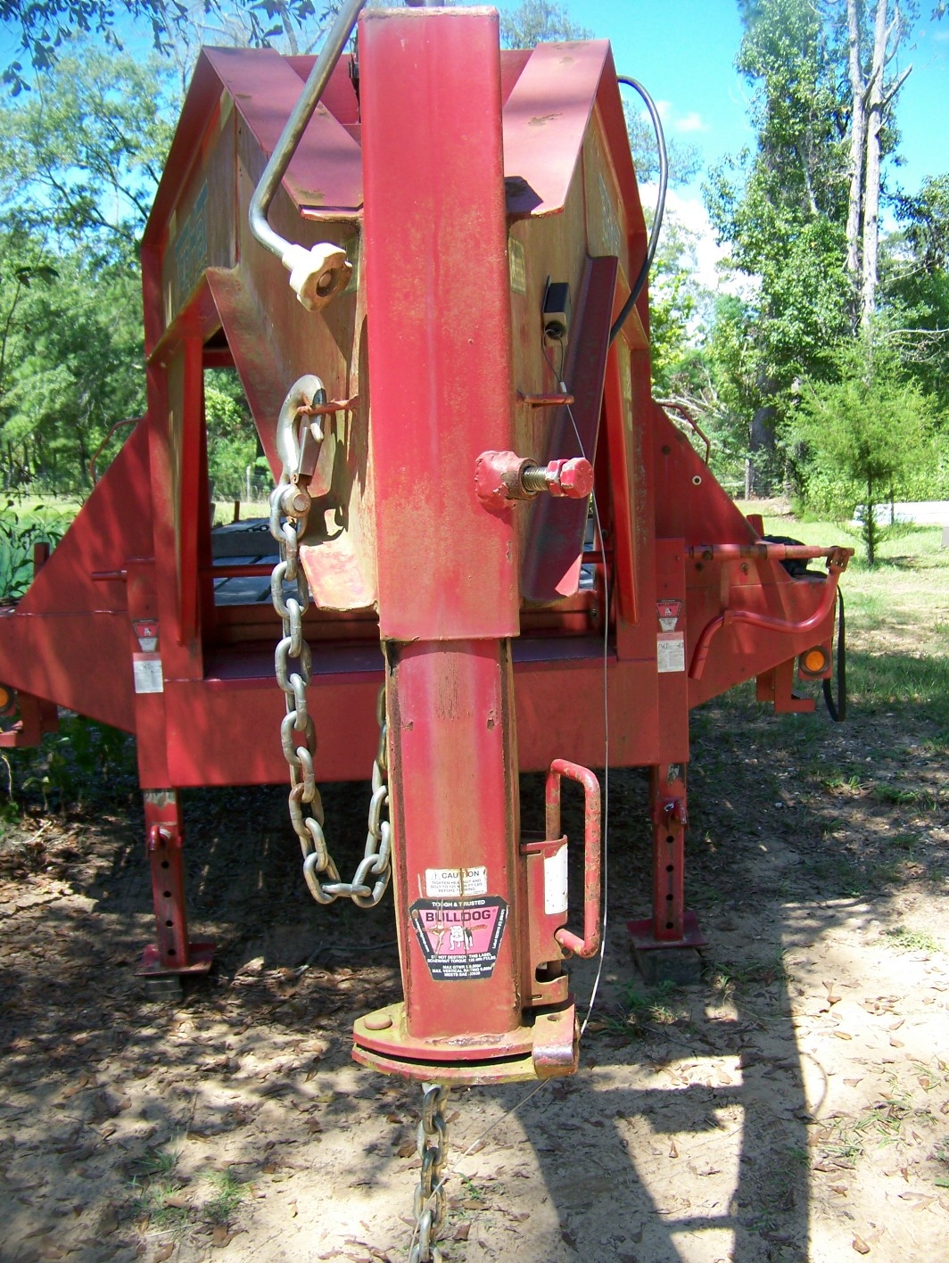

I found a 14-15 inch crack today on my gooseneck coupler. The scary part is the crack is all rusted. No telling how long it has been cracked. The trailer and coupler was new in 2012. Should I weld it up or replace it. I am leaning on replacing, as it is a Bull dog coupler. Can I remove the jam nut, unscrew the handle on top and just replace the bottom part? Or will the old one need to be cut out and welded in as a unit?

Just need new inner tube. BullDog should have what you need. Then take the old one and weld away on it as practice. Once welded, load up trailer and take one a run with the new inner just in case it's needed. BullDog may even want to see the old one?

Thanks. That is the plan. Are the screw threads easy to start in the new bottom?

I located a new coupler, but my old one's square sides have expanded a little and wedged into the upper tube. The welder that fixed my telehandler is gonna come out and weld it so I can take it to a trailer shop. I will know when the welder gets here if he can unwedge the lower tube. Trouble is, the crank on top only turns about a quarter turn and gets hard. Both directions. Not sure what way to turn it to unscrew it.

Understood. I would guess it is normal right hand thread. Turn left hard, then whack the base down with a good sized hammer, then crank it some more it might come out. If that don't work, turn it right hard and whack it:)

It seems like it froze, as all the flat sides are rounded and expanded. Only freeze we had that was bad was the freeze 3 years ago when Texas was without power for about 7 days. The top crank has a wide shoulder, so it is hard to believe water freezing did it. But it looks that way.

I sleep on it and realized my crack started back in April. I was going home after digging all day with my 7.5 ton CAT excavator. I was hot and tired and turned too early leaving my friend's driveway. I felt the truck slowing down and looked in the left mirror to see the CAT and trailer tipping way over. All I could think of was floor the pedal and the Cummins pulled the trailer onto the pavement.
I talked with my local industrial welding shop foreman and he (and I) don't think the freeze back in Feb. 2021 could have done it.

I don't understand how that would make it crack where it did.
The set bolt being over tightened at some point probably didn't help, much like the regular round couplers tend to fail in line with the bolts.

What do you mean by.... set bolt being over tightened? Mine was factory set.

I don’t see how it could be anything besides freeze damage. It looks like the whole tube is swelled from freezing.

Most likely it was tightened by the dealer. And I've seen them over tighten couplers more often than not.
Now the bolt has created a weak spot, which I think is why the (most likely) freeze induced crack started in line with the bolt.

The bolt is on the forward left corner. The crack is on the aft left corner.

To me, that looks like a pipe seam split from freezing. Most pipes are welded seam and not drawn. Until it's pulled from the trailer, you won't now for sure. Just glad it didn't turn ugly when towing a load!
Except that the weld is always in the center of a flat part, not along an edge.
At least I've never seen tubing that wasn't welded that way.
