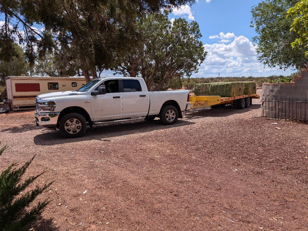

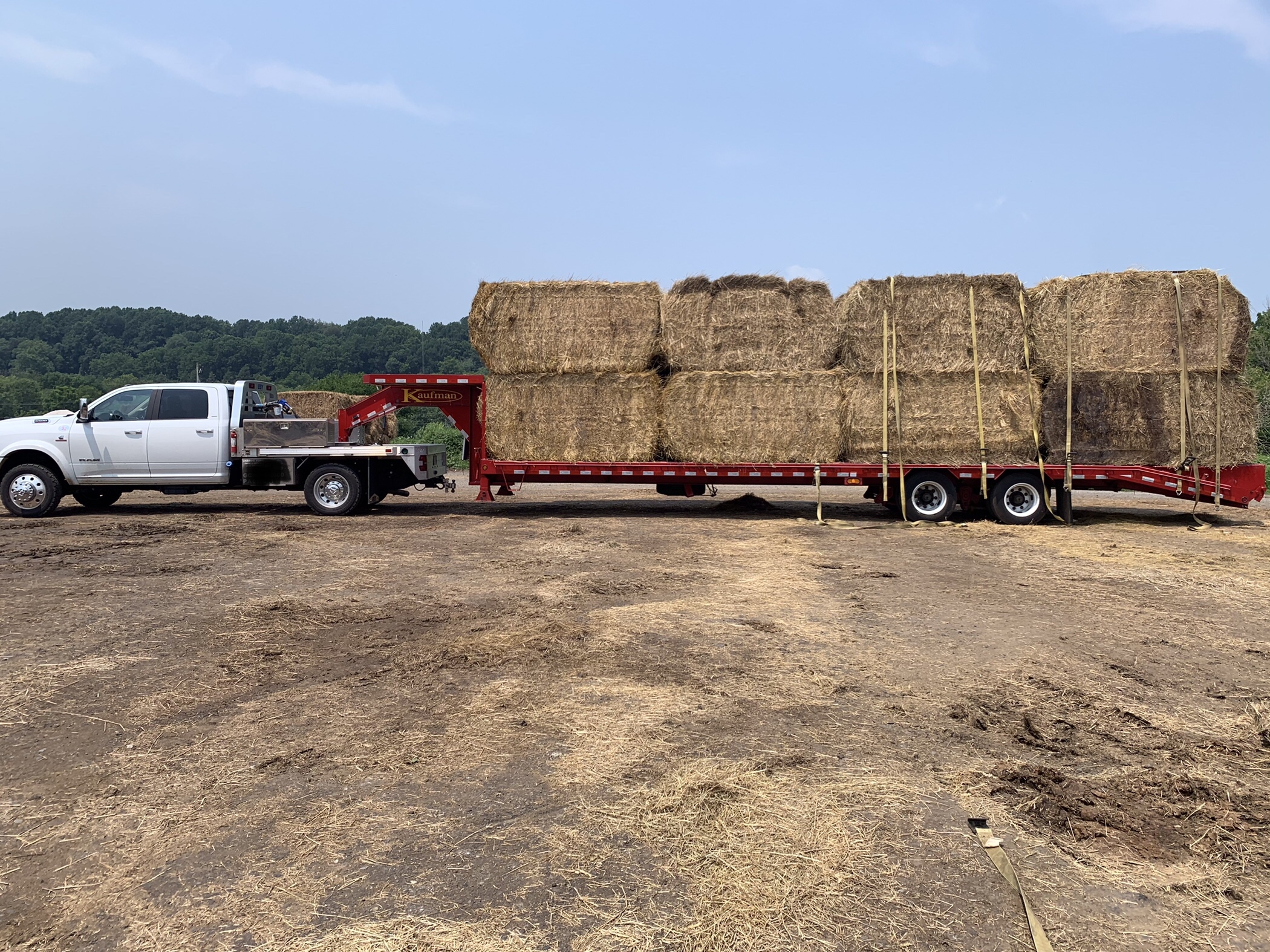

I don’t like giving up the bed space even for a gooseneck. I have a 30ft gooseneck but I can haul nearly the same load using the flat bed and the bumper pull trailer. View attachment 3941856
I couldn’t match this GN load of hay with a bumper pull and loading the bed.
If I shifted 2 bales of the 16 onto the bed, that would leave 14 bales. There’s no 20,000lb GVWR trailer that will carry 14 large bales without being overweight. Heck, the 14 bales weigh 12 tons alone. Even if I put 4 on the truck, and 12 on the trailer, the bales would weigh over 10 tons.
A 20,000lb GVWR trailer usually has a payload max of about 8 tons.
I hate the way a fully loaded BP feels compared to a fully loaded GN. The GN’s ride & handle nicer, putting more weight on the trucks front axle than a BP.

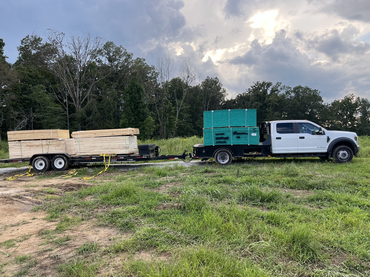

If I had a 15 ton trailer it would be a different outcome but the weight capacity of the bed and bumper pull trailer combined is about the same as my 22k gooseneck trailer. This is not my truck but I really want to do the same thing with my Volvo. The Volvo is head and shoulders apart from the F-550.
