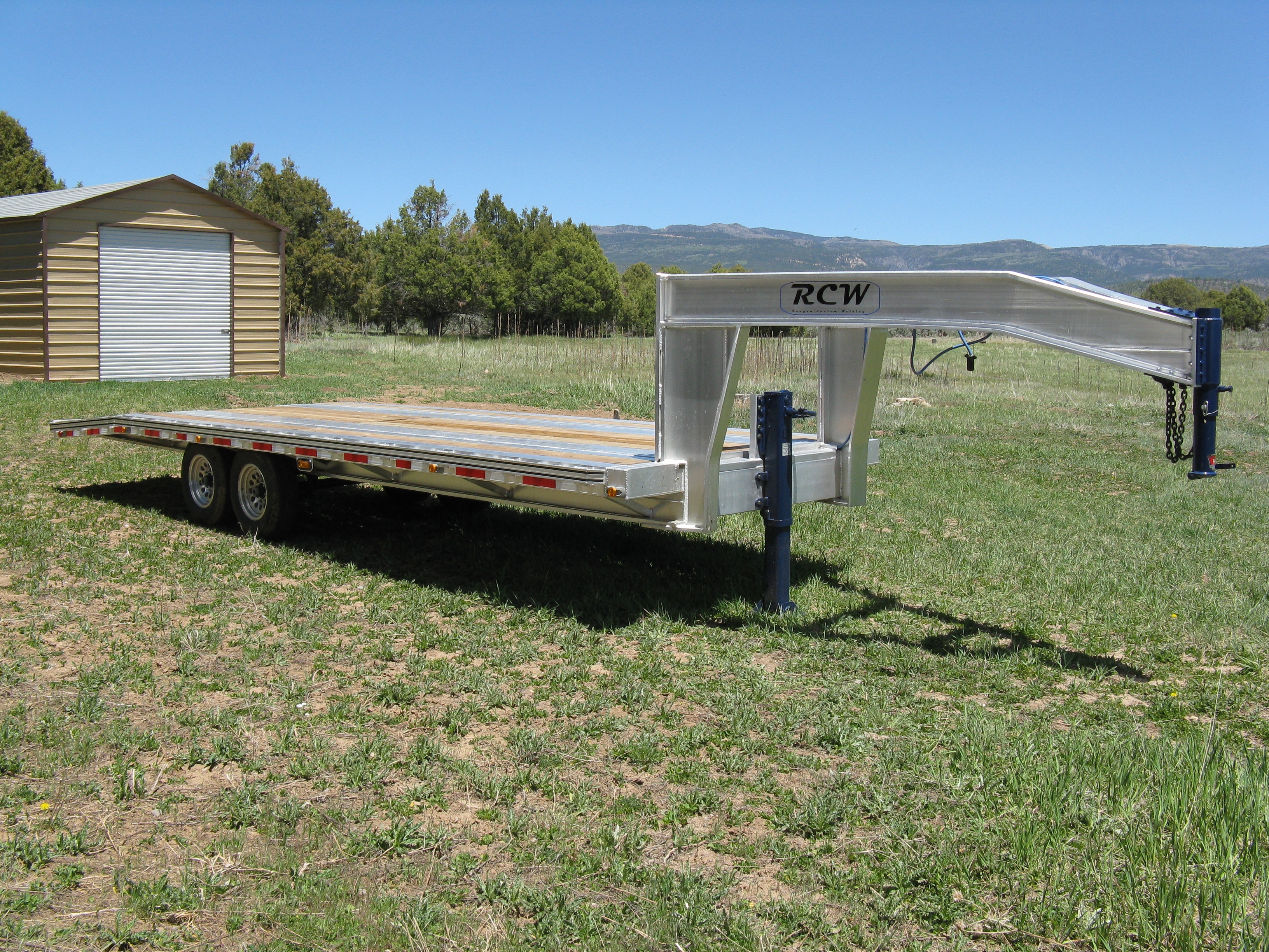

I'm about as far from recommending towing with a 1/2-ton as it gets, but if I had to, this would be my trailer of choice. Checked the weight on the ball out of curiosity - 400 lbs. according to the scale, which was about right for that trailer. It was light.

Not a fan of loomnum being used on a trailer, but that is incredibly light.
I hesitated buying that one (for about $7K in '10) until learning that the guy was building Class 8 trailers for a living. Absolutely beautiful welds. And I'm sure he had squirreled away the material from work.
Had it delivered (only had a 1/2-ton at the time), only thing wrong with it was that it only had brakes on one of the 7K axles, which was easy enough to fix.
Should have added a third axle to make it more useful for me, but ended up selling it to a friend for cheap.
