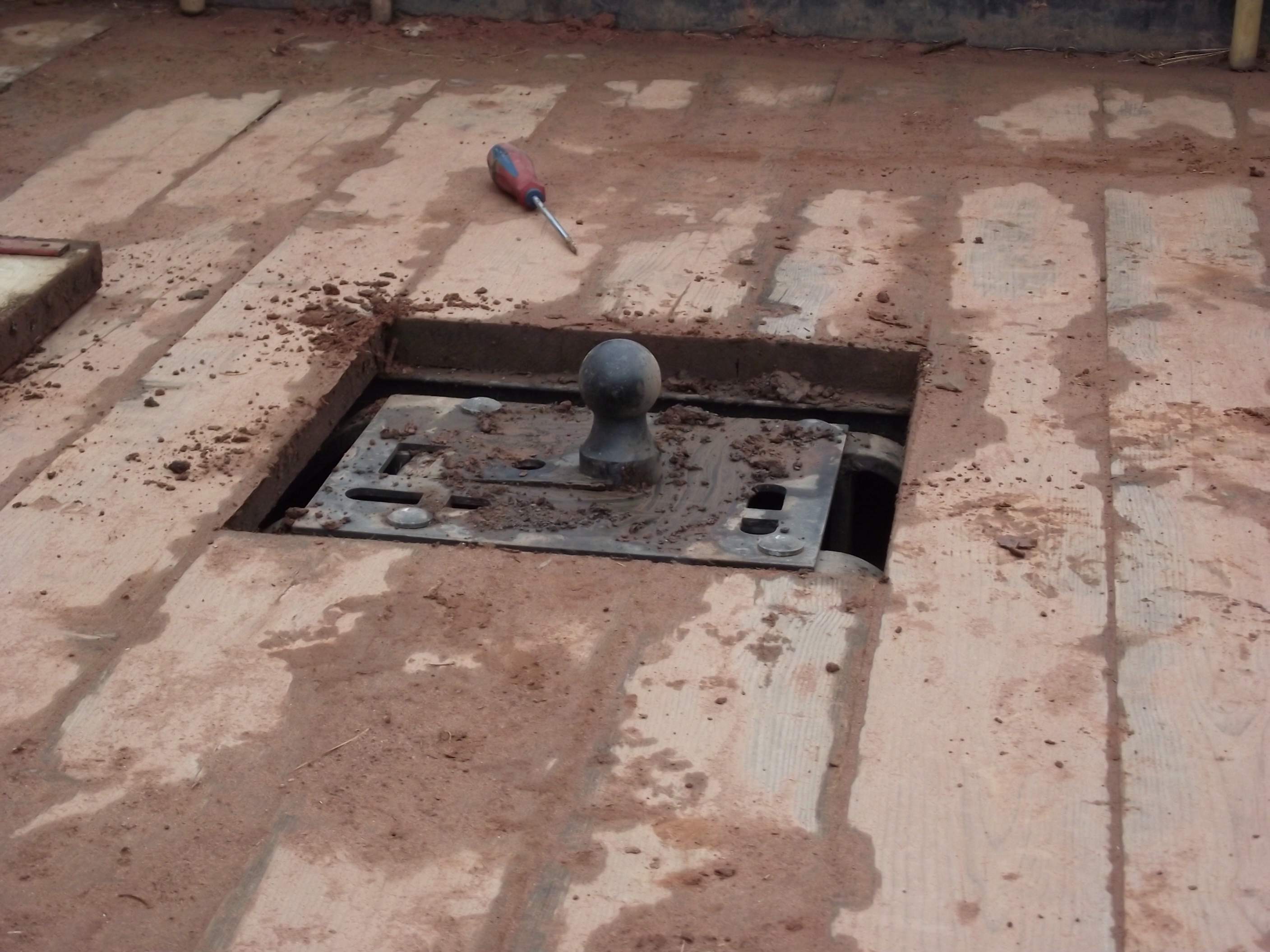

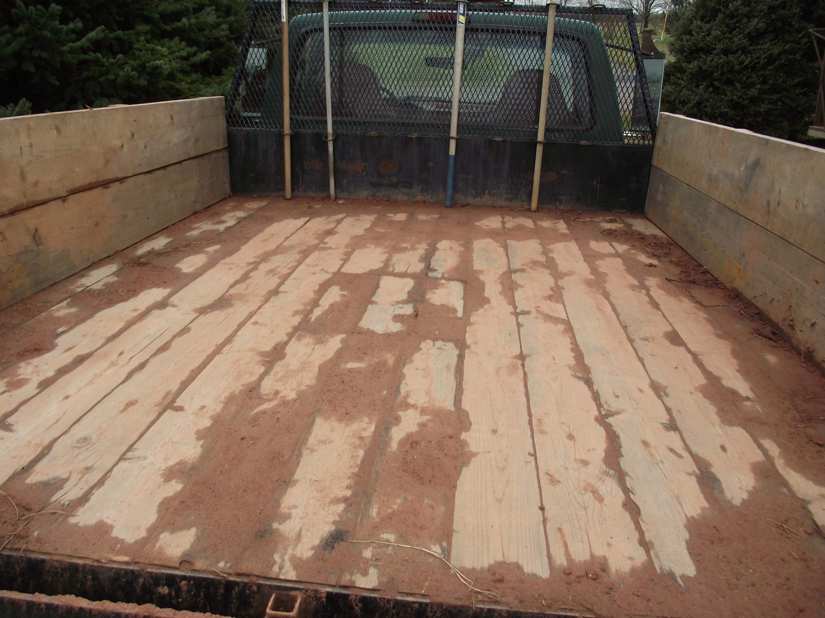

Here are a few pics of my setup. First the bed with a pop out hatch. I really need to clean this thing up sometime.

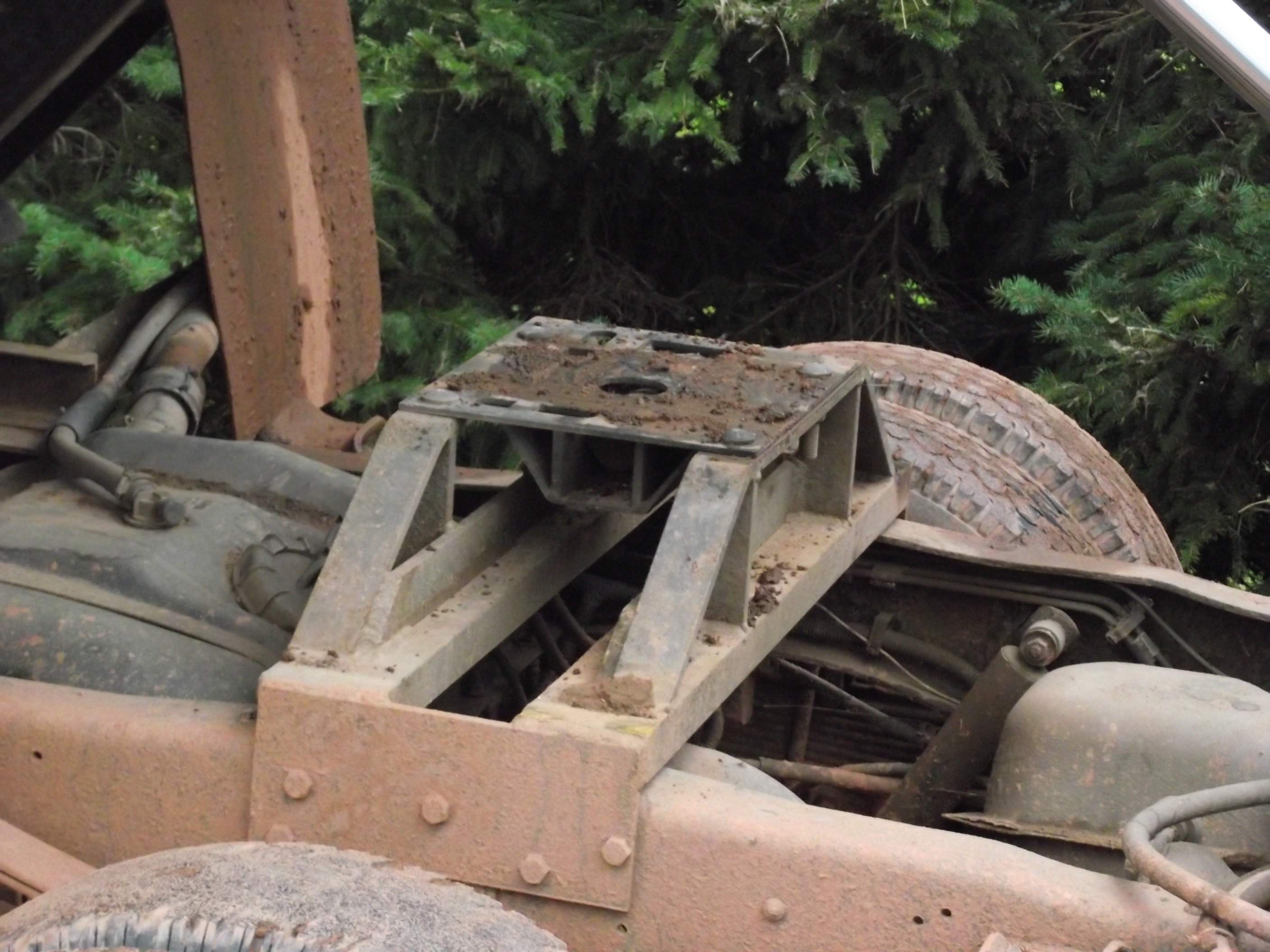

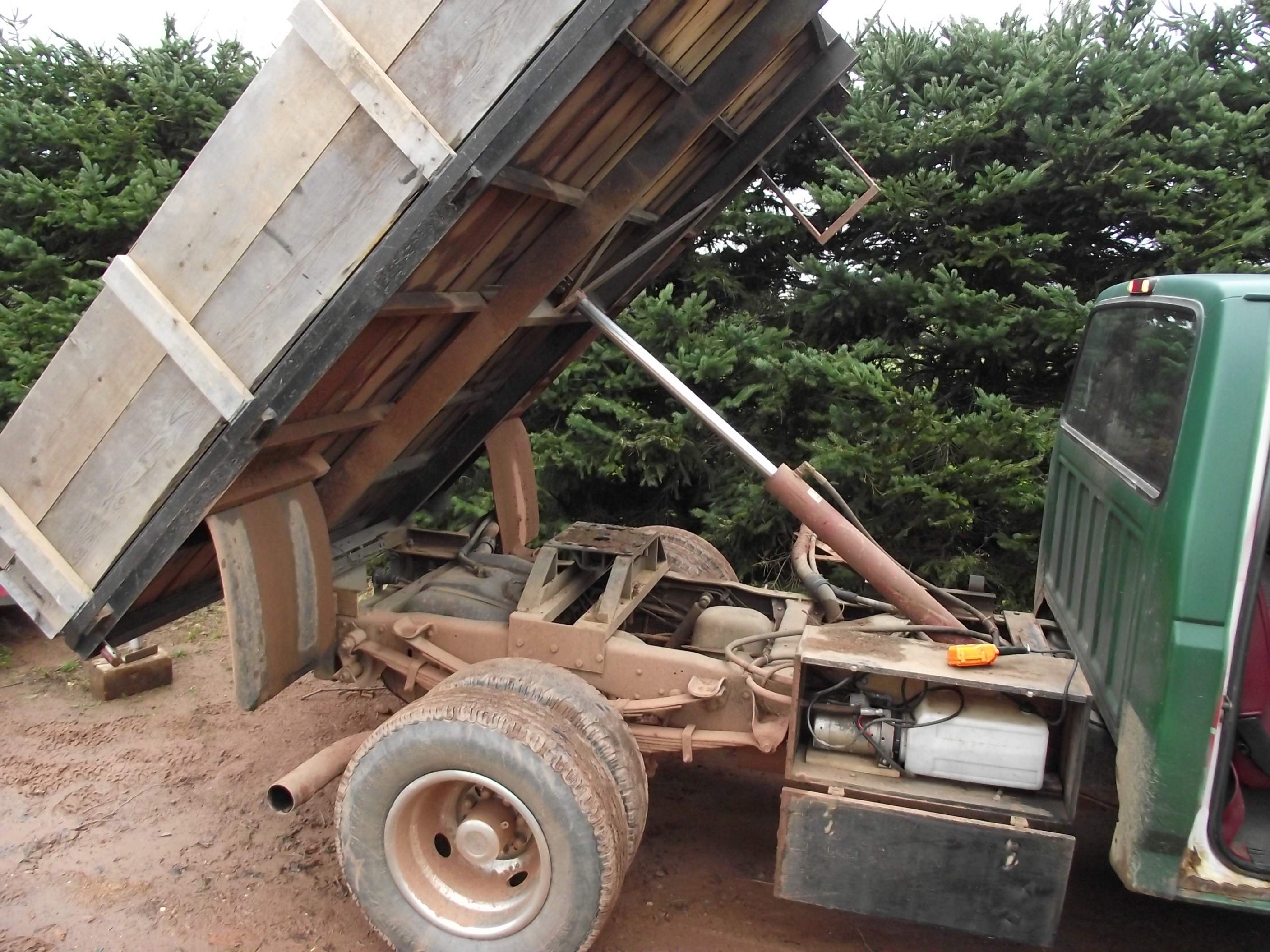

And the bed in the dumped position, with close up shot of the hitch.

The hitch is a Buyers brand. Max Trailer gross weight 25 000 lbs, 5 000 lbs max tongue weight. Put it on when I built the dump bed, Didn't really need it at the time but i figured better to have it and not need it than wished I did. Have used it a couple of times and it worked great.

A picture is worth a thousand words. Thanks for the pics, it answers the question about having a 12 foot bed. It doesn't look that hard to do, but since I wont be doing the install, I better reserve judgment. Does anyone know if there is a premade unit that can be bought?

Toxic good looking build, I like the cylinder set up that allows you to use the mid fuel tank. I am useing a extra frame on top of the truck frame to add a little more strenght as I 4 times more hydraulic power than truck chassi.

Thanks. When I built it I was a little concerned that the cylinder wouldn't have enough push because it is running almost parallel with the frame when the bed is down. But I have had that truck ridiculously overloaded and it's never refused to dump a load.

nice thing about hyds. oil don't compress.. once that rod starts wanting to get longer, it's between the relief valve and a bed that can start tilting up.. looks like the relief won1 :)

Do you have to remove the side boards when you hook up trailer? I'm buying a GMC 4x4 dually Dmax and it is a chassis. My plan was a dumping platform with low profile tool boxes on sides and hitch mounted to frame over axle. Can't decide how high boxes can be without damage if I tow my a 15K trailer fully loaded. That's my M-7040 and my attachments, fuel cell, etc.
