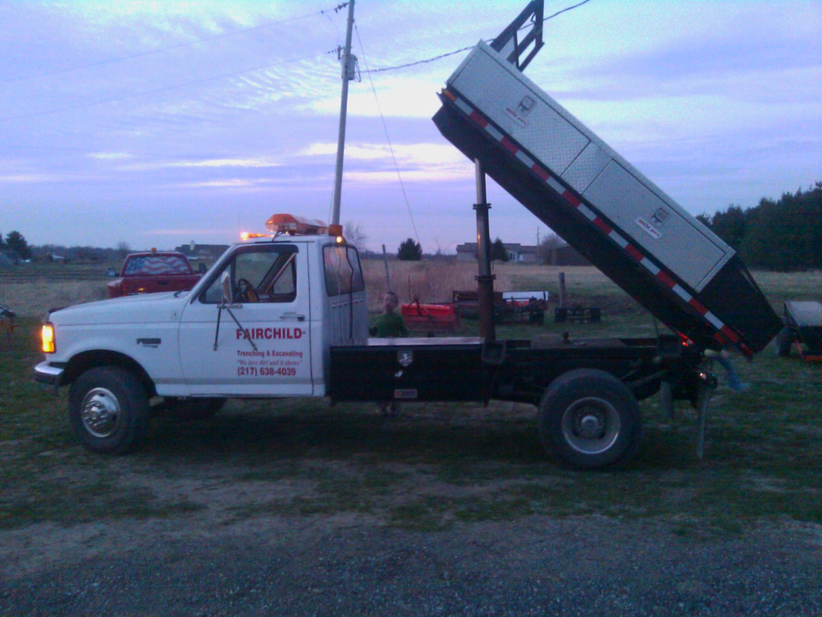

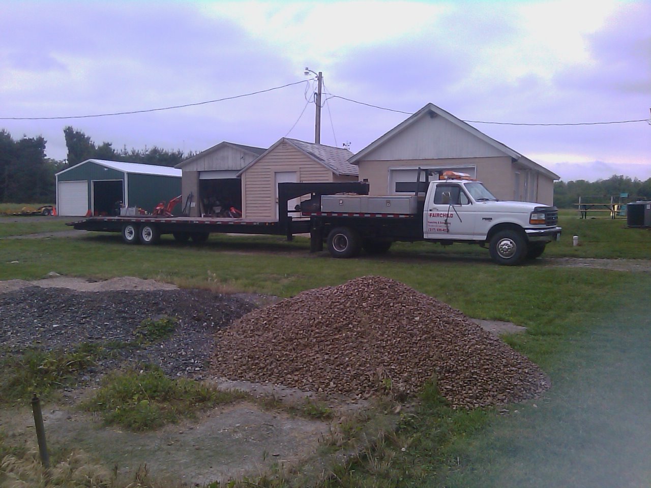

Here is a photo of my set up I built over the winter pulling my gooseneck. I have pulled it though many ditches and fields and have not had it hit the bed yet
