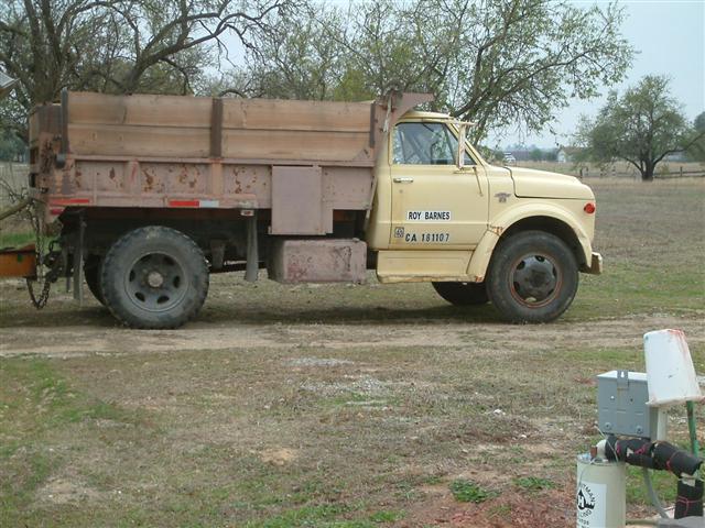

Without a question I'd go with the pintle hitch tag trailer behind the dump truck. With the 427 and 5+2 it will pull that with relative ease. Despite what mfg's claim, no pickups are really built to haul that kind of weight.
However, I wouldn't plan on pulling a pintle hitch trailer behind your pickup, even empty. They are so heavy on the tongue they will squat even a 1-ton pickup with nothing on them. With a load on it, even a small one, you are talking tongue weight in the thousands of pounds.

77 ce6500 427 gasser 5 speed split rear end. I'm the 3rd owner the previous owner bought it off a propane company (old propane truck) in 88 at 111K then they installed a new dump bed, doors, hood, grille and had it repainted to match the rest of the fleet. I bought it with 153K miles always stored inside and have every service record and receipt log since 88. Paid $3500 for it :D
Sounds like you got a good deal! :thumbsup:

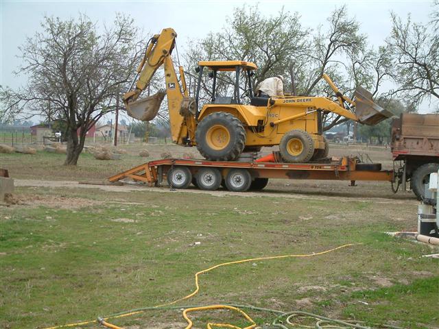

Here's the setup my contractor uses for his JD410C TLB- 3 axle tag trailer with pintle hitch
Looks like a low cost approach.

If you're moving it once per week as you stated.....and hardly use the GN for other purposes.....and the dump truck has the splitter.....and the used tag trailer would be much cheaper......hmmm I might have to reverse my original position!
A cheap tag trailer would probably be best suited, me thinks those backhoe tires can get expensive!
