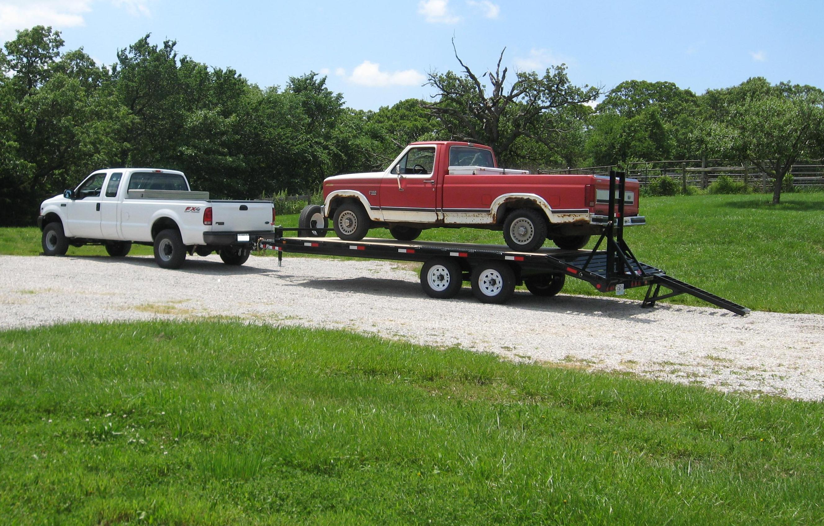

I went through a similar decision making process on a recent trailer purchase. I wanted a deckover for ease of side-loading and needed something capable of accommodating about 4,000 lbs of tractor/attachments, construction materials and possibly a vehicle now and then.
I have an F350 (single rear wheel) but wanted to be able to use the trailer on other trucks as necessary. I also wanted to keep the bed open so ruled out a gooseneck. My initial thought was to get as much length and capacity as I could in a bumper-pull trailer. However, I learned that 24 foot, 14,000 gvw trailers are HEAVY and have LOTS of tongue weight (like 1,000 lbs).
This seemed excessive, even for a one ton truck. Also, there seemed to be about a $2,000 price difference in going from a 10k trailer to 14k. So, my decision was to drop back to a 20 foot, 10k trailer. Of the (few) brands that were sold locally, I liked the PJ the best.
As it is, this trailer squats the rear end of the F350 and I have a weight distributing system for it. I could not imagine trying to use anything heavier on a half-ton truck.
Another advantage with the lighter trailer (3,100 lbs, 600 lb tongue weight) is that I will be able to use it with a half-ton truck (Toyota Tundra..) if/when I decide to trade in the wild and wooley F350 in the future.
Wishing you the best of luck on your purchase.
