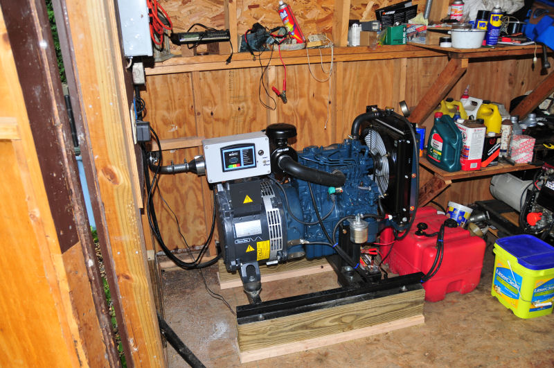

Upgraded my genset at home for a new Kubota powered 9.8 KW. Had a Duetz aircooled 8 KW before. The Kubota is really nice. 1800 RPM and water cooled and it is nice and quiet. Added bonus is lower consumption, and auto start. I worked 6 days on and off getting it installed, fuel set up, exhaust run and wiring done. I have a manual transfer, so it is a switch to start, but from in the house.
Anyone interested in an 8KW Deutz diesel genset with less than 25 hours, sens me a PM.

Just curious why you updated a virtually brand new generator?
   / Got a New Generator
Just wanted to get a quieter, more efficient and easier for the wife to start. I always wanted a water cooled, 1800 RPM unit, so when I found the extra money I went for it. Several types on the market but I opted for the Kubota powered. Hopefully common filters and knowledge with the BX.

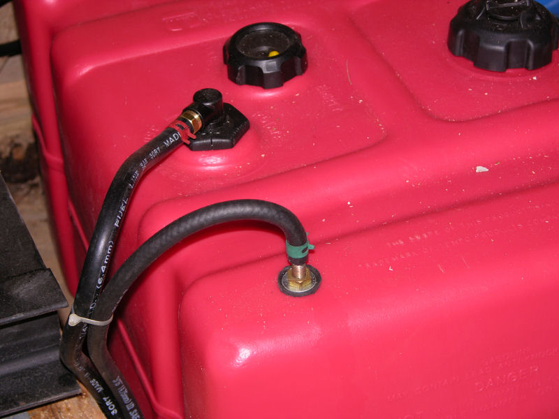

I acquired what looks to be an identical unit 2nd had over 10 years ago and it is still going strong. I am interested in the details of your fuel tank system and info on where I might find same. What was the cost of the genset?

I bought the tank some years ago from BassPro. It's an 8 gallon marine unit. I had to add a return (common for diesel engines). I machined a threaded collar and brazed it to a length of rigid brass hobby tubing. Then I soldered a barbed hose fitting on top and fished it into the tank and clamped it fast with a nut. At the time I paid under $20 for the tank. I also have 50 gallons in a plastic barrel on the other side of the shed for the tractor and genset.
The new gen was around $5K all inclusive and shipped.

   / Got a New Generator #7
Nice looking unit!!! Is that a sucker or a pusher fan? I did not see any ducting for the fan, so how do you keep the shed from getting hot and overheating the engine? Philip.
Fan is a pusher. Summer just open the shed door when running. Winter crack door and heat shed (along with tractor).
