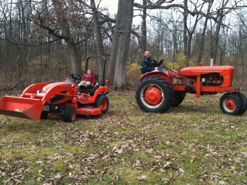

Hello all. I have been reading this forum for some time and figured it was time to post something. Mainly because I just purchased my dream tractor. It is the 1950 Allis Chalmers WD pictured here. It will be used to work about 3 to 4 acres where we will plant pumpkins and sweet corn and she may participate in a parade or two.

Good looking tractor! I spent more than a few hours on a WD45 and a G when I was growing up. My mechanical skills are mediocre at best -- were they better I would try to track down a WD45 and a G to enjoy a second childhood.
Does your WD have the original AC hitch? If so, do you have any attachments?

If my memory serves me right the WD 45 is what I used as a young teen. We'd use it to rake hay and grind feed. Does yours have a hand clutch? Or a cathead to run a belt to operate belt driven implements?:thumbsup:
Edit: upon closer look I think I answered both my questions. It appears to have both.

It does have the Allis quick hitch and yes, it came with a 3 bottom plow and some sort of 3pt adapter ( home grown?) with a rear blade. It also came with a Kelly loader - I took it off after trying to dig into a pile of dirt. My BX does so much better than the Kelly did it was ridiculous. For all the above and the hardware for a drawbar and wide front end I paid $1500. I felt it was a pretty good deal, but you guys probably know better what kind of deal it is. The tractor does run great and starts immediately. I have been driving it around all day getting used to it. It's a lot different than my Kubota!!!

Nice wheels. I would be looking to add Roll Over Protection. It may not be 1950s but better than the alternative.
/ Got a new tractor
#12
I looked around a little and didn't see any online - would a rops be something I would need to have made? I am into the history of this tractor and wouldn't want to do something to it that would change that, but if there is an option that is bolt on, I would be interested.

Nice looking tractor. I feel that your need for ROP depends on the lay of your land and intended use. With no loader and on relatively flat land and reasonable operation I see little need for a retrofit. For those with the ROPS it would be interesting to know how many use the seat belt - without it you really have little protection.

My land only changes about 20 ft from the highest spot to the lowest, but I have heard about tricycles tipping over because of too fast of a turn. That is not enough of a reason to go modifying it too much, but if there were a removable kit for under say $600, it would give me some more peace-of-mind (especially when I would let my kids drive it).

Not very true at all, IMO. What you have heard are "wives tales" stories from those who don't really have actual experience. I could relate some "kid" stories from the 50's as all we had as kids were trycycles. Massey Harris, JD, IH, AC, Oliver, MM. The "standard" (wide front ends) were not seen much because of row cropping attachments and pull-type pickers and such. Ford's were mostly wide front.
They are difficult to tip over, and what we put them through on purpose would have made them tip over if at all "easy". I won't go into details of the stupid things we tried. But never saw an AC with a ROPS. They are mainly a band-aid for the liability protection perpetrated by the courts and the lawyers and the desk-sitters in the Gov't. My opinion here.
Nice tractor, and liked working the AC's with the hand clutch. Hope you enjoy the rebuild. Looks like a lot of fun, and jr will have good memories of you working on it. :)

My boy in the picture is my youngest, my oldest is who I would let drive the tractor. He is 14 and very responsible. I do trust that he would use it wisely, but it would be nice to have a little more peace-of-mind.
He is very excited about the tractor too and already has plans of what he would like to work on to improve the tractor too.
