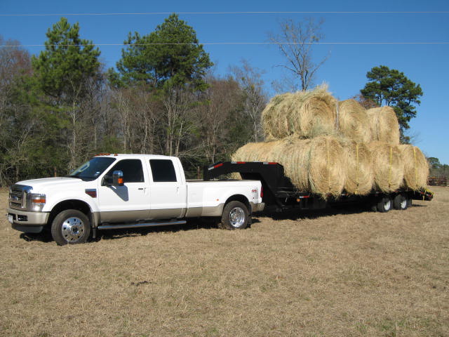

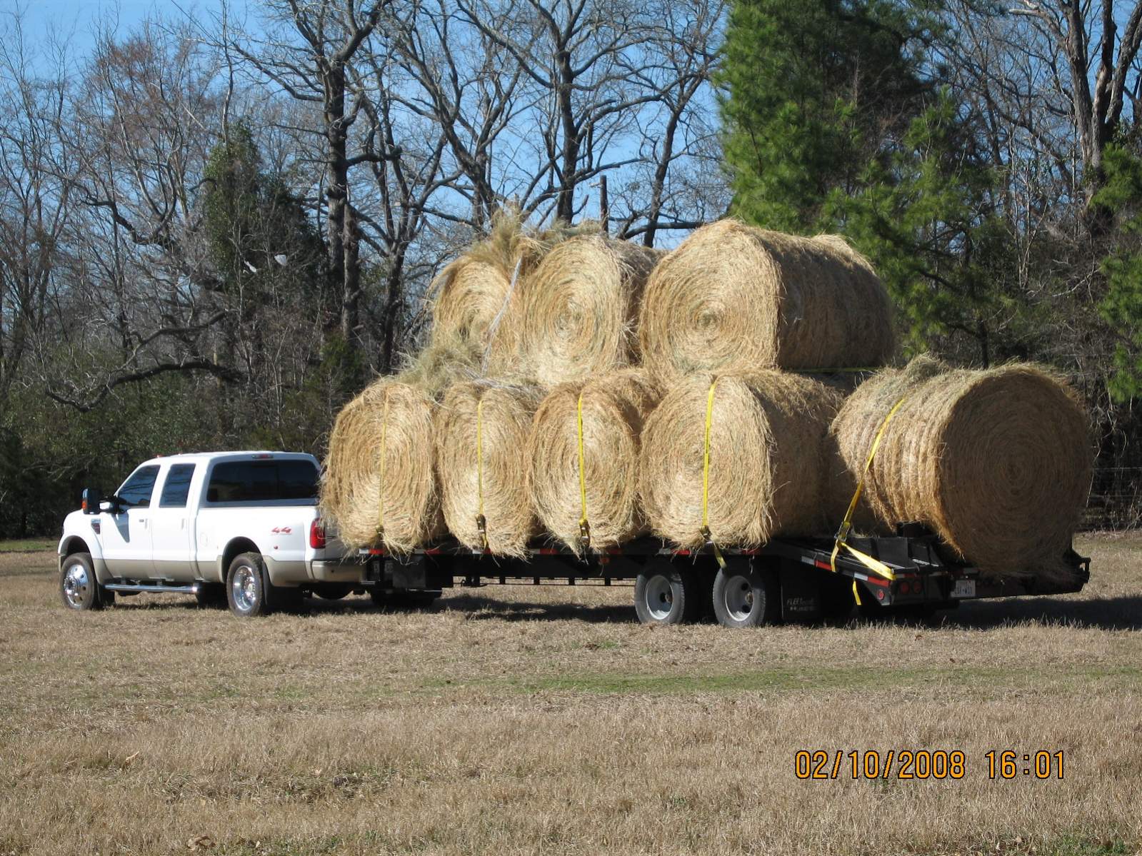

You might want to check the date of manufacture on the tires. If they're over 5-6 years old they can blow or throw the tread off even if they look new. I've had both happen with my trailer when I was hauling hay. The tires were 6 years old and looked new, no cracking at all. I threw the tread off one tire with the first load and had a blowout on the second load. I didn't even know about the blowout until I got home and was unloading. The spare had never been mounted and the tread separated while it was on the rack.
