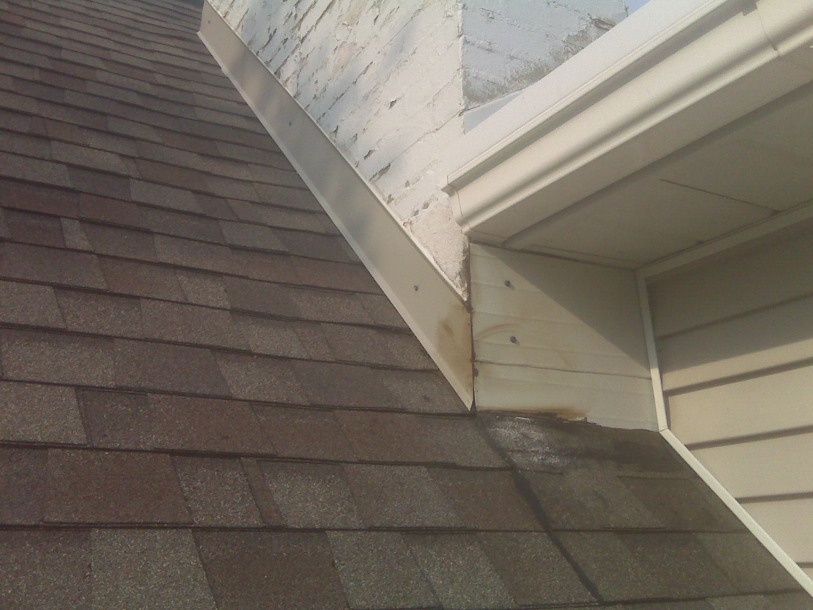

hosspuller said:
IMHO ... metal and brick have different rates of expansion. Trying to stick one to the other is just asking for trouble. Chimney flashing is even a worse case. The building roof moves in relation to the chimney. It is better to allow the movement with step flashing covered with counter flashing. Cut a groove and bed the counter flashing to the brick.
That explanation is very helpful to me. So after I patch leaks around my chimney, the various expansion rates weaken my patch...which is why I continually repatch. So, even if I patch ok, it will only be expected to last for so long.
My last patch job seems to have held for a few years... I used "GreatStuff" expanding foam...from underneath the roof, in the attic... In addition to pitch on the top.

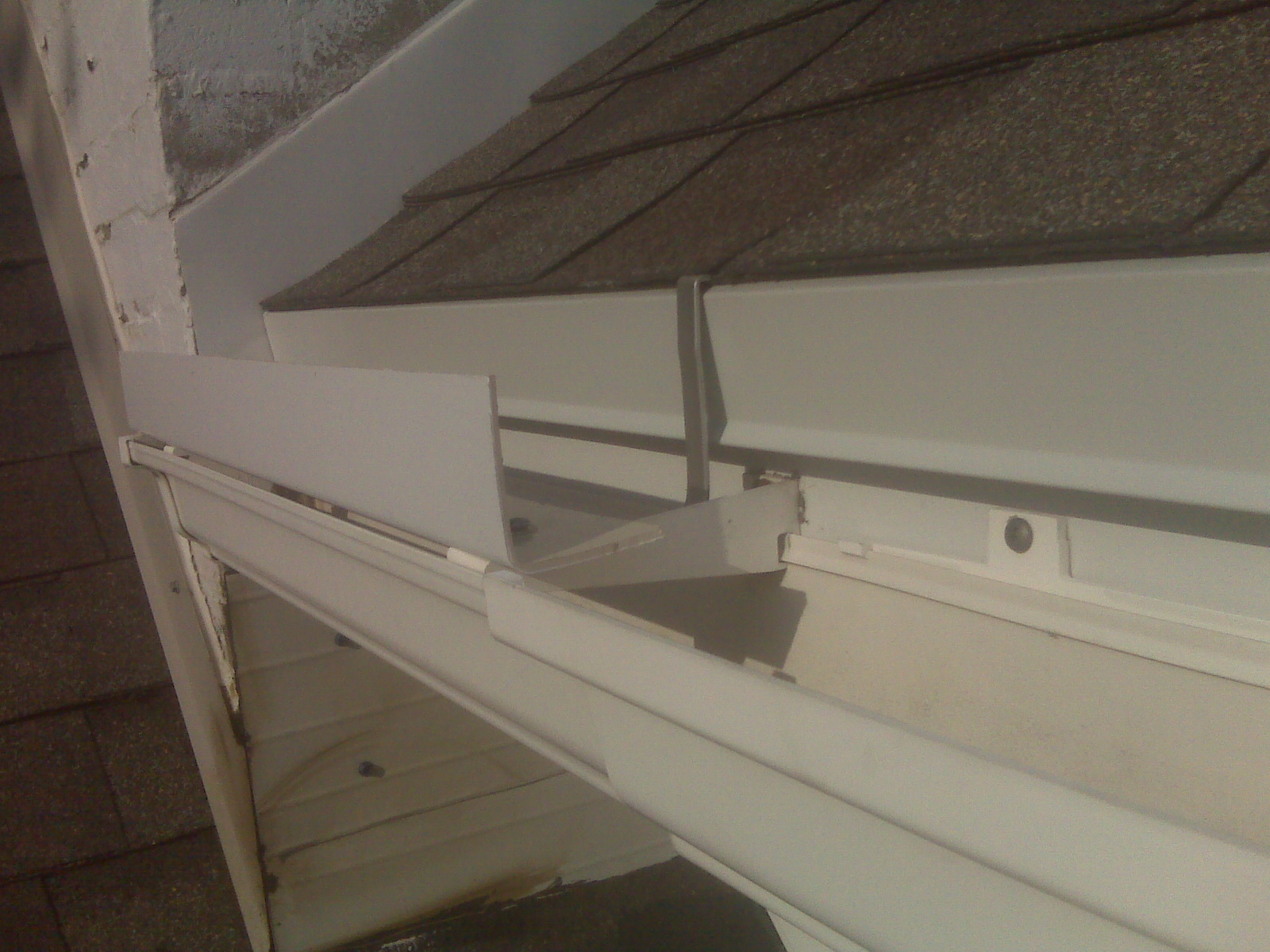

I think the original idea of setting four anchors and screwing it in place sounds the best, especially if it ever needs to come off without taking the mortar with it.
Also, I think you may just move the problem down a few feet with that flashing, as it really needs to run all the way down to the base of the roof, otherwise you are just moving the water problem onto the seam below it. My hypothesis, at least, from to few roofs I've shingled.

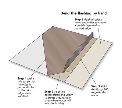

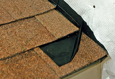

Would a kick out diverter help you any?
FlashingKickoutWaterDiverter2.jpgFlashingKickoutWaterDiverter1.jpg.

Thanks guys...the pics do not show it very well but the side of the chimney is well flashed ABOVE the rain gutter and when I did leak testing using a hose, the only water that entered the house came from BELOW gutter level...meaning the leak was below the gutter. Last night I put that galvanized patch into place and tacked it onto the vertical sheathing after tucking it under the shingles an inch or so, put the hose overhead and not one drop of water entered the house. I am going to use a grinding wheel to cut a groove in the bricks horizontally just below the soffit, then duplicate the galvanized patch using aluminum, then attach that to the chimney using masonry screws and roofing cement in the groove. Danno1, thanks for the idea of the diverter...that would be an easy addition especially now that I have some shingles to replace.
