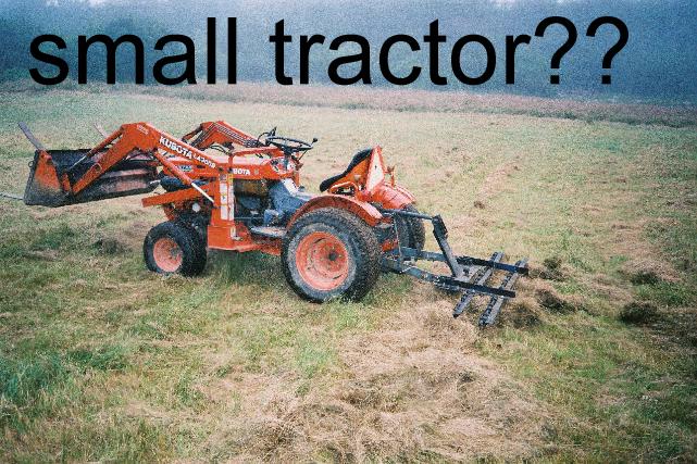

I made a rake for the three point using this type of tine. I'd post a picture but you and many others will get a laugh out of the construction. It's not to your standards.:D
Ah heck, they been seen before.
