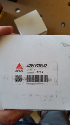

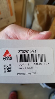

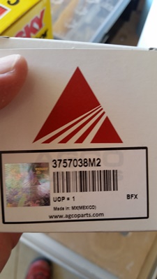

Whoops, I missed all this activity. I took pictures of my filter boxes back then, but didn't label them as to what's what. I do remember that the Massey Dealer had a heckuva time getting the right air filters. It was like keystone cops for two months trying to get it right.
I'll post the pics just in case any one else is looking. 20160901_123631.jpg20160901_123638.jpg20160901_123645.jpg

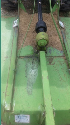

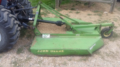

So, I've been trying to find info on what to buy and how to seal up the gear box on the mower deck. I must not be using the right terminology because I'm not finding much on info.
I'll say it like this. The round thing on top of the mower deck that has gears and oil, is leaking like crazy. Just started acting up on last mowing session of last year. How do I make the leak stop? Is it just seals and snap rings?

Appears to be leaking from the input shaft seal. Have you looked underneath to see if it's also leaking from the output shaft?
If it's just the input seal leaking I'd check for bearing slack. No reason for a seal to start leaking up there unless the bearing is getting loose.
Assuming the bearings are tight. Many, many brush cutter owners pump the gearbox full of grease rather than oil and keep running it.
It is dry underneath. Bearing slack is a term I've never heard, but I'm guessing it's like checking wheel bearings on a truck. I'll look into that.
The seal that seems to be leaking is on the backside. Looks like a snap ring. Think I'll just take it apart. I was hoping to find a video where some one did this, or an exploded drawing somewhere. Guess I'll have to treat it like the pre-internet days and go for it. 20170430_194311_resized.jpg
   / Got me a 1433 Power Shuttle #18
Oh, sorry, I thought it was coming from the input shaft seal.
Yeah, if it's just leaking around the rear cover, take it off and investigate. Maybe smear a bead of silicone gasket sealer around it and put it back on?
No leak underneath is awesome!!!!! You dodged a big bullet there!!!!
