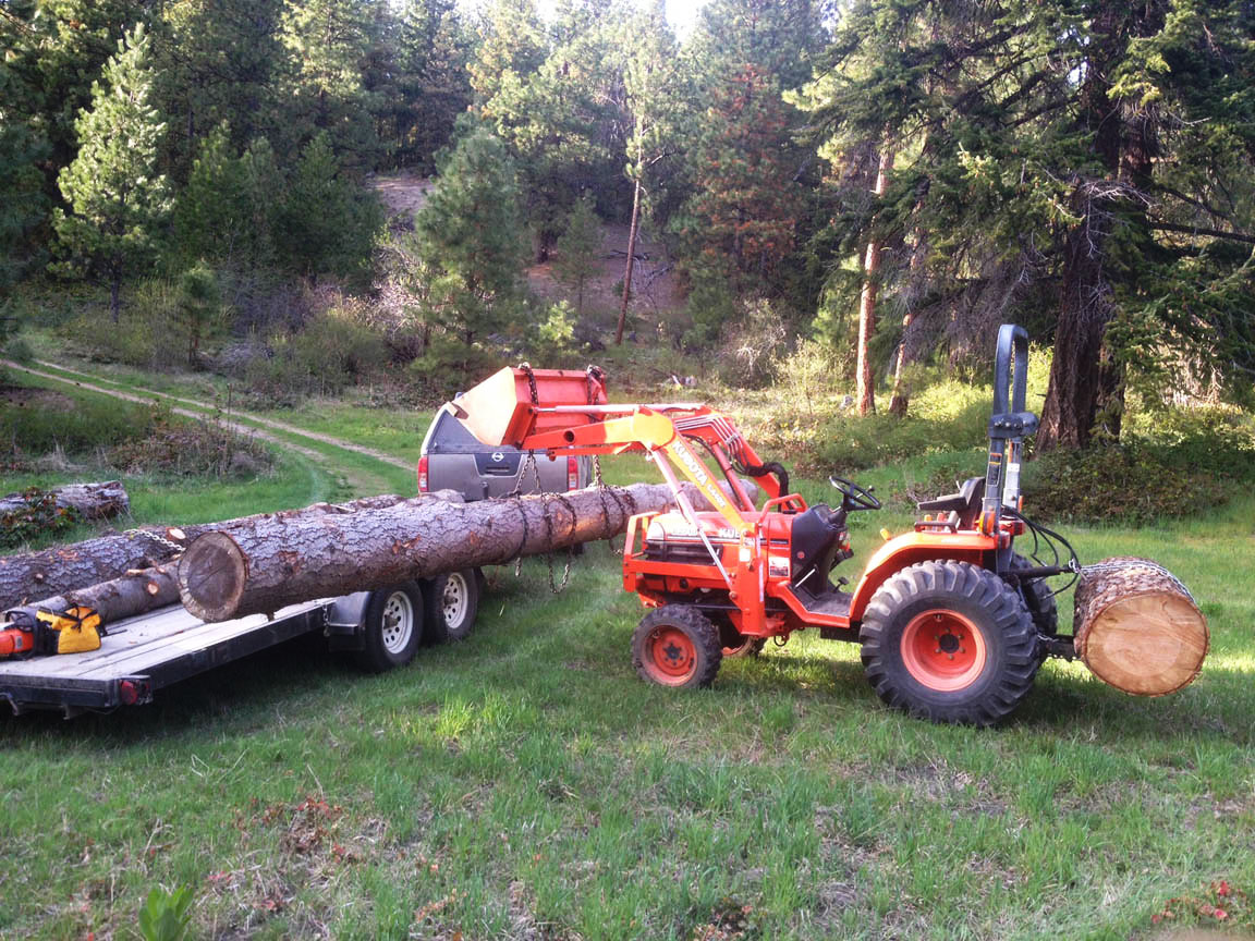

I bought a B2710 with an LA402. I DOUBT very much that it lifts 402 x 2.2=884, I think it lifts about 6-700 lb - just a wild guess.
378216d1401945192-got-mini-excavator-selling-bx24-b2710-lifting-log16-jpg
   / Got mini-excavator, selling BX24 TLB #23
Nice counter weight... very fitting! :thumbsup:
