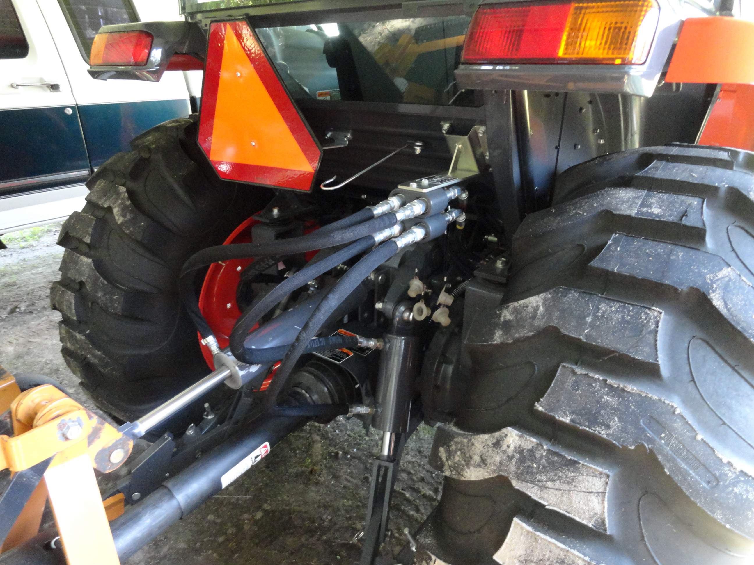

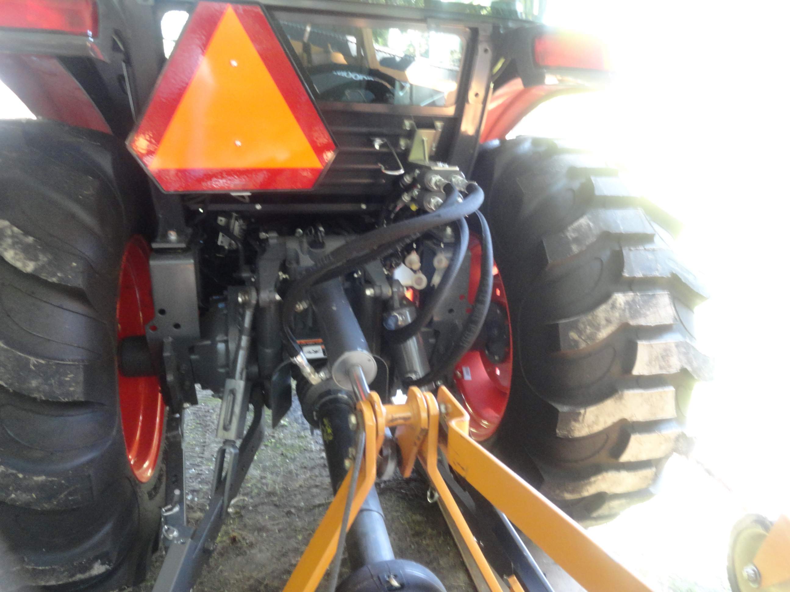

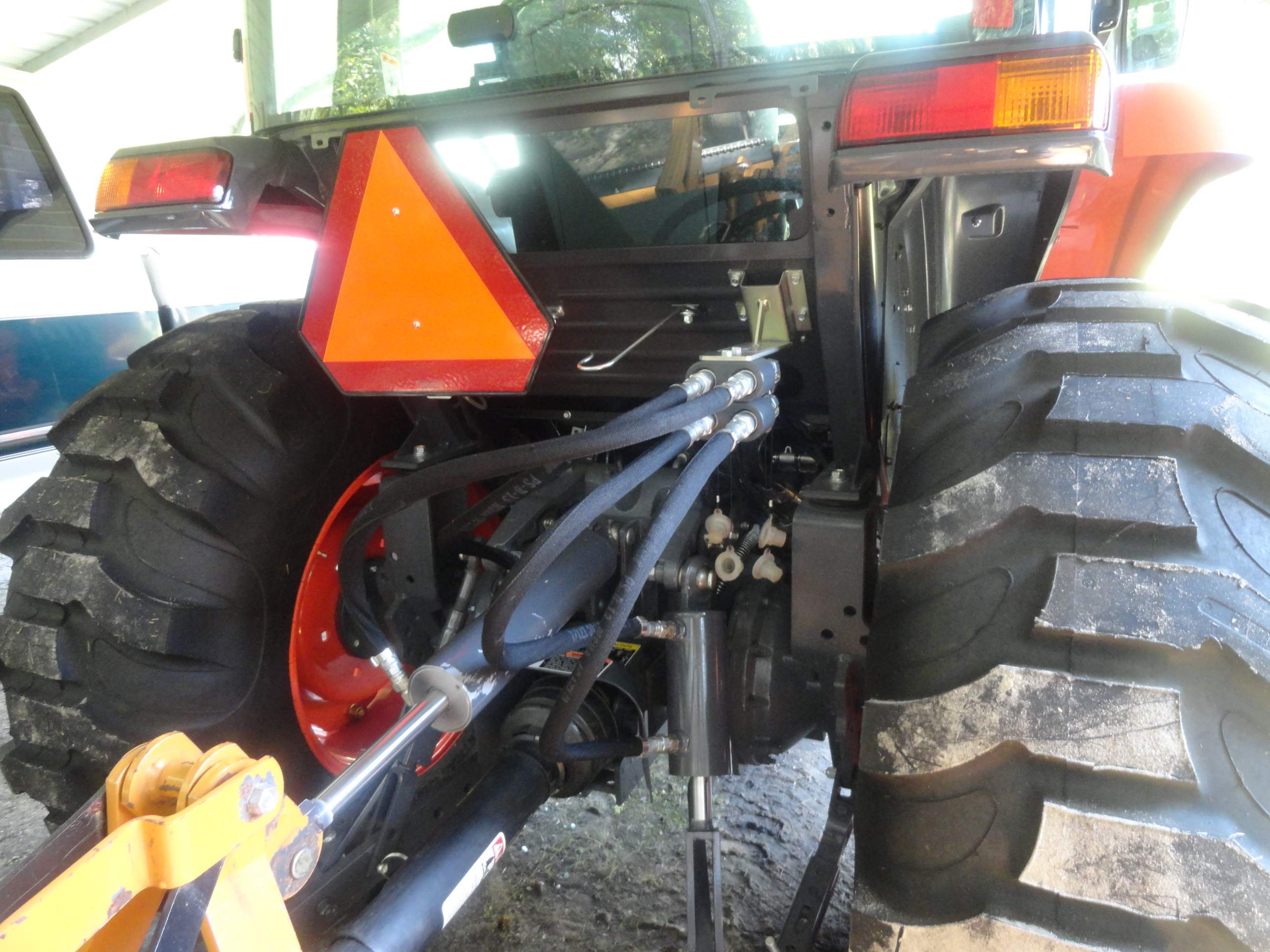

Here are a few pics of my install. Mine did not come with 90deg fittings off of the rear remotes.
I did remove the 90deg fittings off of the side link and installed some straight fittings so I had a more direct route to the rear remotes.
I kept the top link 90deg fittings for now, and they seem to work ok for my setup.
Stu

That's cleaner than mine. I noticed your toplink is at 180 degrees to mine (mine has fittings on other side).
Lots of choices.
