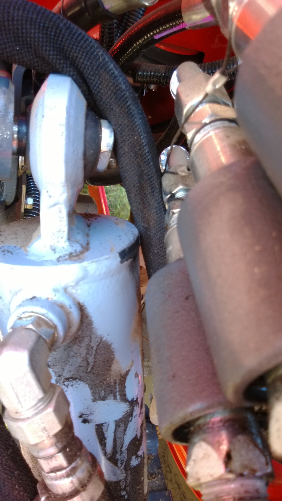

Wow, your hose and routing are so much cleaner than mine. Mine kind of seems a rats nest in comparison.
At some point I may have a new hose or two made up and try to come up with a better configuration than the OEM kit they installed.
Are yours alway so clean or did you just wash it before the pic. Mine is wet with oil/dirt in various places esp around the tilt cylinder that I need to track down.
I wiped away the upper part of the cylinder to see what was going on, but if you look lower on the cylinder you can see what mine looks like after only a couple hours after having been washed. Seems to be seeping in a few different places around the couplers.
What's a good way to track down where fittings are weeping? Seems like there must be some clever way like spraying flour or something to have the seeps show up immediately before the oil spreads.
I think there are at least 3 places mine weeps around the rear couplers. Makes more mess than I care for.

To track down the source of weeping use Brakleen and compressed air to clean any existing residue, then use a paper shop towel strip and tape it in place over the suspect area, starting at the highest point and working this down until the leak is found.
That picture was taken the day it was delivered and will never be that clean again though I will probably get the power washer out at some point, wash it now and an hour later it looks like it was never cleaned.
I have used baby powder to find leaks before they were really noticeable, but as mentioned you have to get them really clean first. Some cleaners are caustic to rubber and plastics, so read the label, I often use the new version of Gun Scrubber to clean around rubber or plastics.
