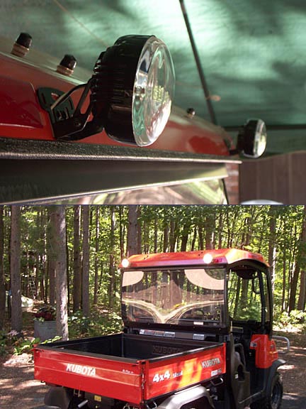

I was in CAP (Consumer Auto Parts/auto parts chain in MA) last weekend and found they had Optronics fog/driving on sale for half price. Seeing how most kits were only $20 at full price I couldn't pass up a kit for $10. I chose the QH-75IT High Performance Driving Light Kit to install on the rear of my RTV900. I already have the Kubota/Curtis front work lights installed. These are high quality lights that use a 27W bulb. I was concerned about installing the Optronics set as they use 55W H3 bulbs. Seeing how I can only look either forward or reverse at one time I decided to replace the two position switch (on/off) that was already installed for the front lights with a three position switch (front on/off/rear on). That way I wouldn't be overloading the circuit with all lights on at the same time. The Optronics lights have two leads coming off them - power and ground. Some other lights I looked at only have the power and use the mount/frame as the ground. I don't think that would work in the RTV900 as the roof doesn't appear to be grounded to the battery. The Kubota lights have the two leads as well so I tied into the ground wire for them at the top of the windshield for the rear light ground.
I wasn't 100% sure I'd like these lights after exposed to the elements for a winter so I used the self adhesive tape that came with them to mount them to the roof - I didn't want to drill any unnecessary holes. If they don't work out I'll pull them off and buy a set of Kubota/Curtis lights for the rear ($100 - 10X more expensive).
So far they work great. I aimed them just above the bed when it's in the up position. Even though they are more focused than the Kubota lights they have enough side illumination to light up the engine/transmission bay quite well.

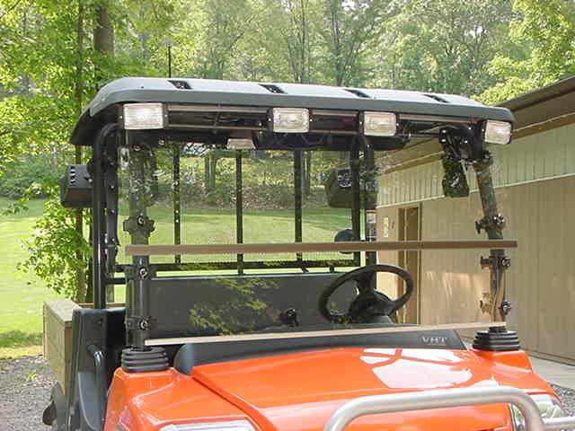

OK guys, I got my lights on. (Picture attached and 2 more coming). They may not look as good as what Zeus did, but they work… /forums/images/graemlins/wink.gif
Front view:
In the front, I’ve added 4 driving lights. The exterior 2 are pointing a little to the sides for peripheral view. These are mounted to the roof panel and are placed so they can go above or below the roof. (I opted for below for now). They’re in front of the windshield and so far don’t give any glare.
