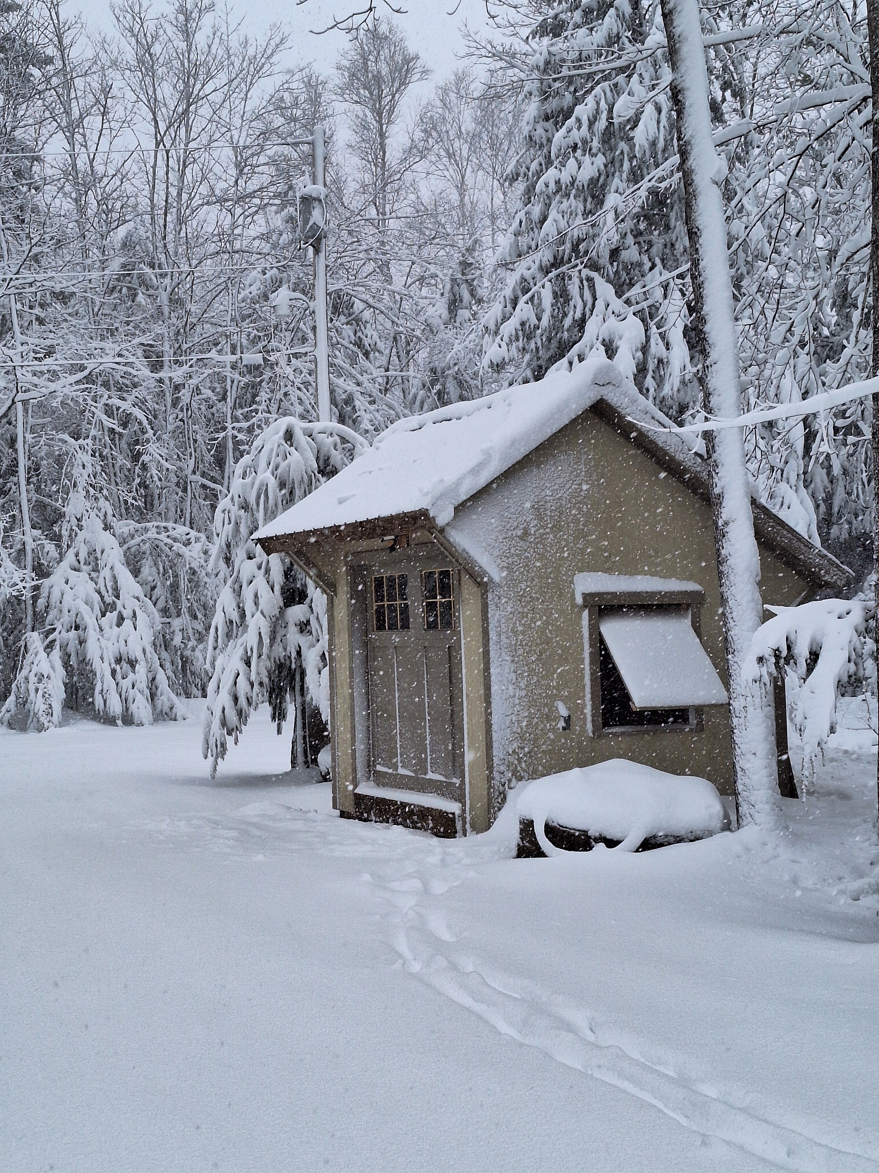

@Rustyiron I love the generator shed.

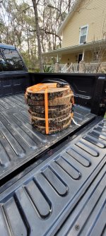

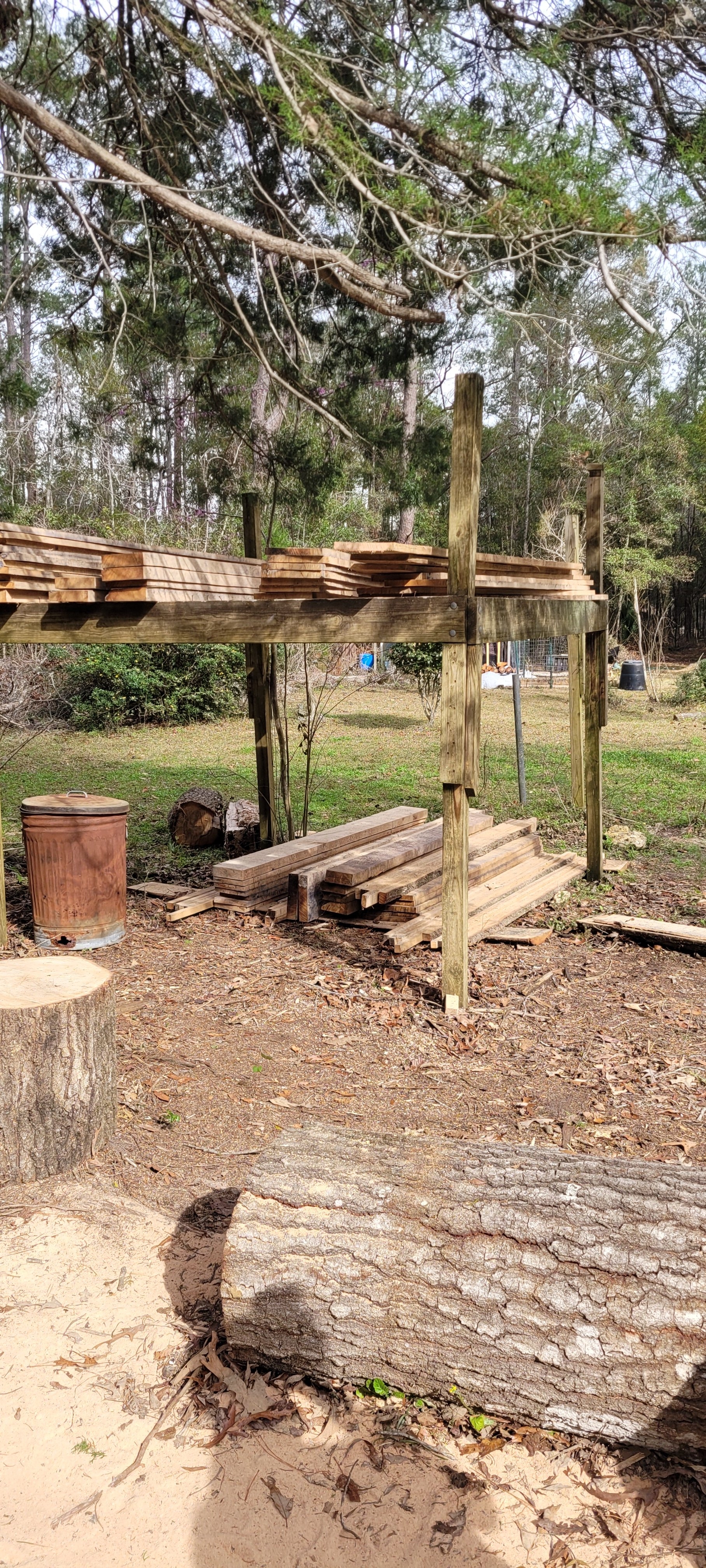

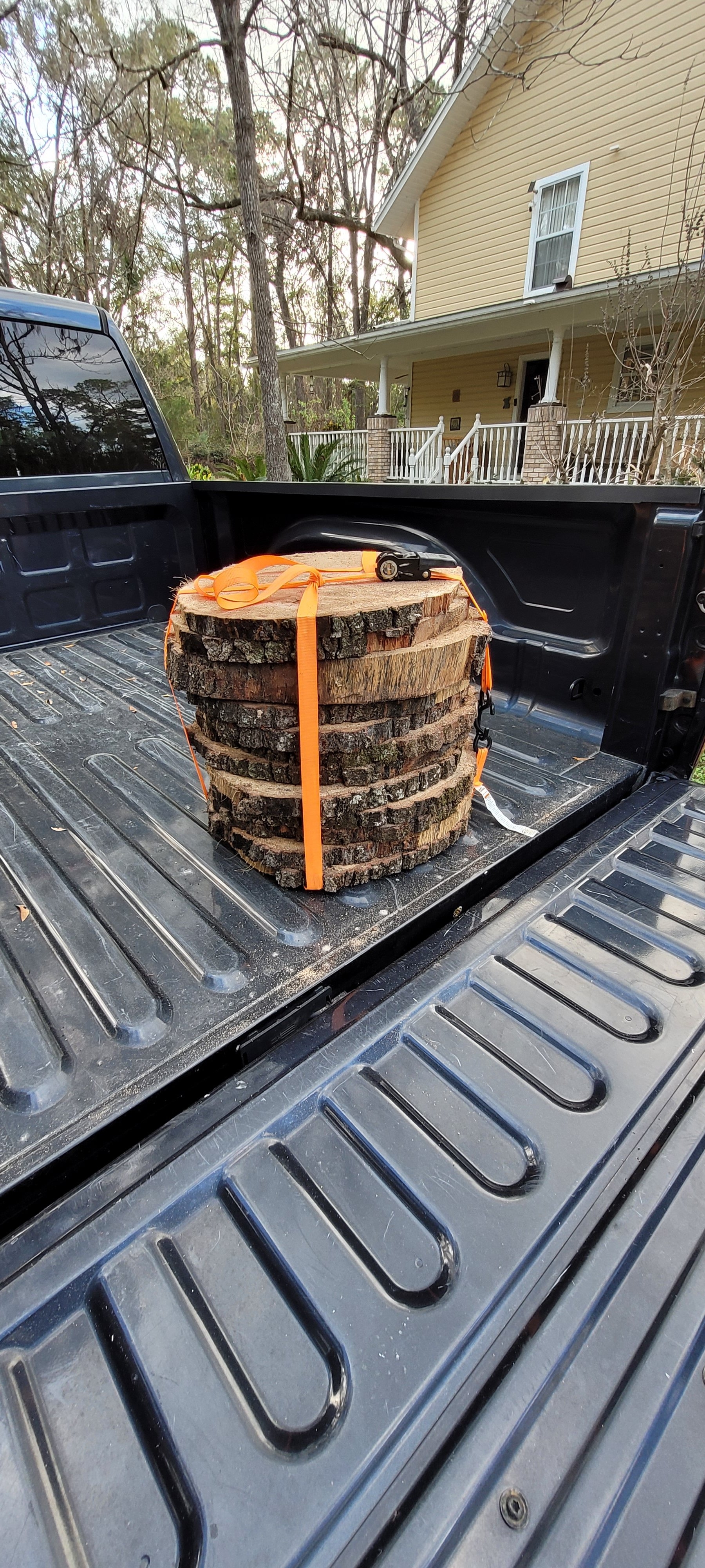

Took my small mill on a trip to my brother's house in Alachua, Fl over the weekend. 20250216_102128.jpg
He had three red oaks blow down in a storm a few months ago. We Milled 6 - 8' logs. I talked to him today and he has restacked and stickered the lumber in a area that gets more air flow. Another brother showed up and asked if we could cut some rounds for a friend of his that's getting married.

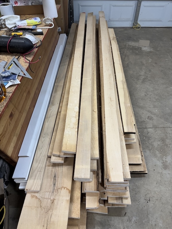

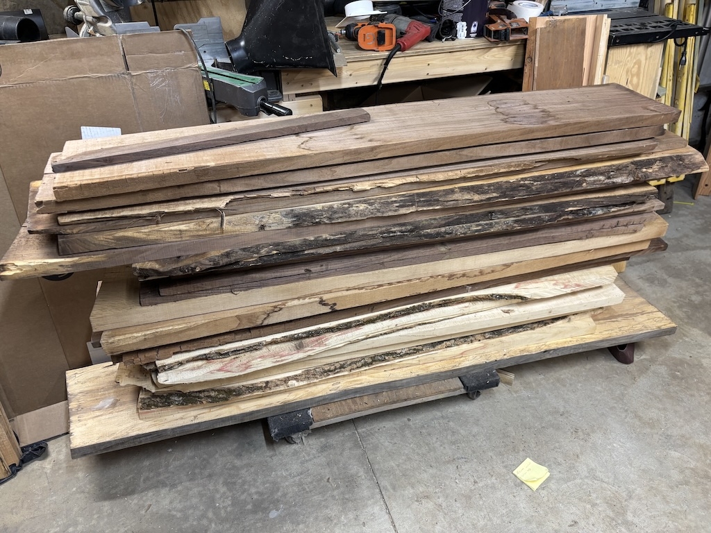

Well the wood is out of the kiln and in the shop for processing. The ash came out beautiful! A quick planer and jointer run on each side and it should be ready to roll. The white oak is a little rougher, but I think the planer will straighten it out just fine. There will be defects, knots splits, etc. but I am ok with that. The wife and I both prefer a rustic look and it will go better with the #2 white oak flooring. I bought some epoxy and wood colored tints to fill these with before planing. The black walnut is perfect! I CANNOT wait to see what this wood looks like planed, sanded and finished.
