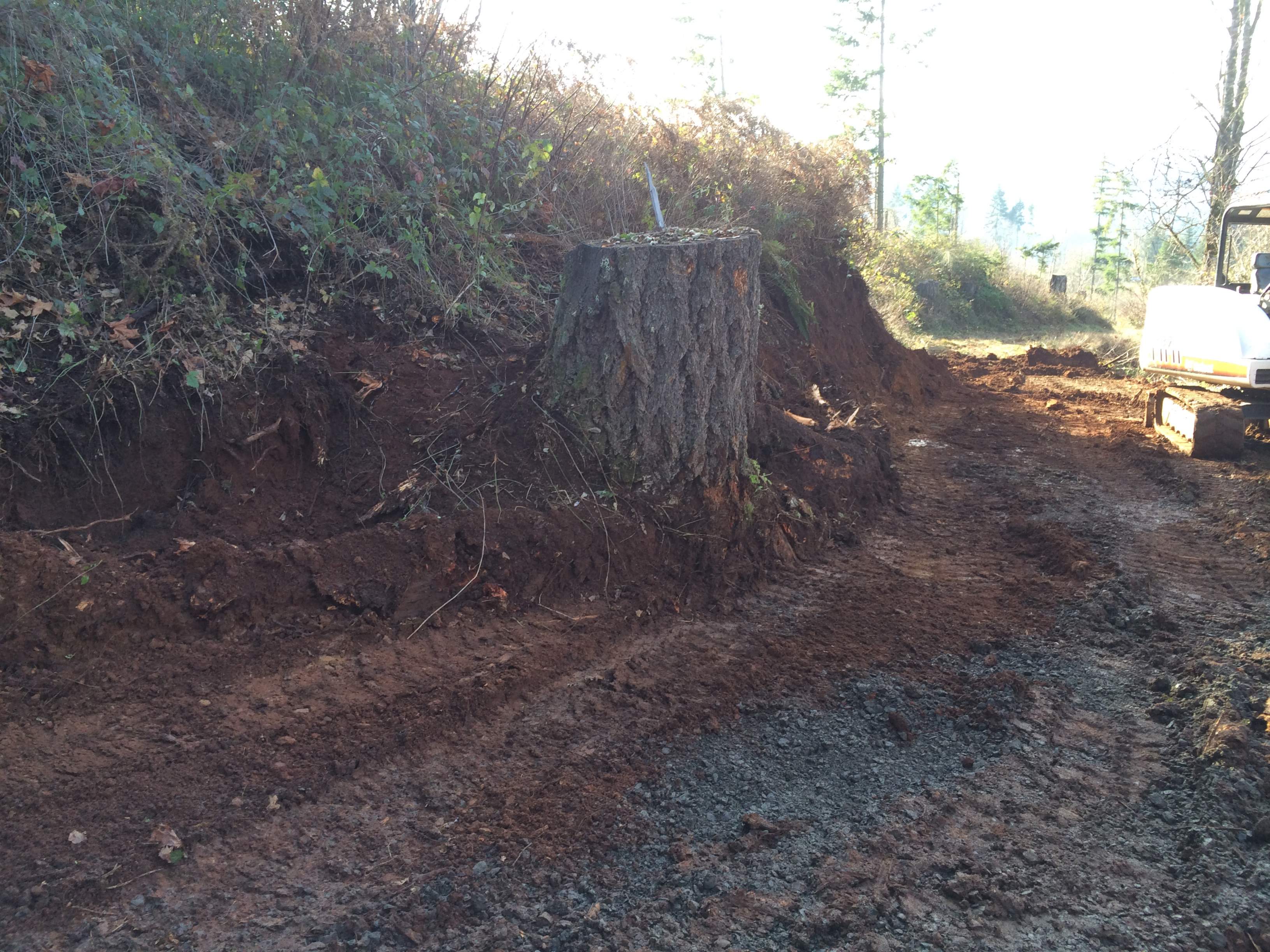

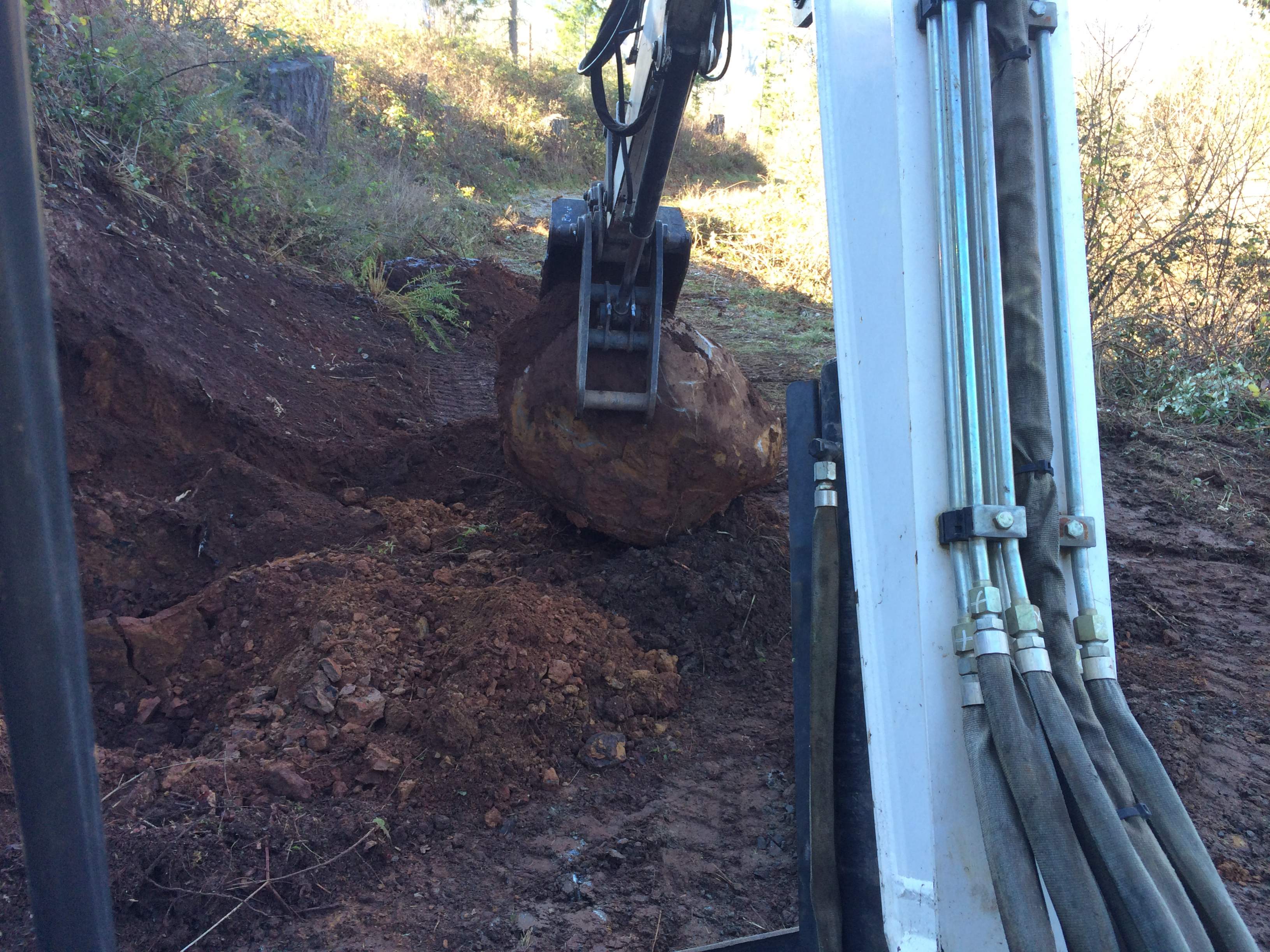

Great info, more in depth research leads me to the Komatsu being a grey market machine - nothing to do with hydraulics - but in the final decision. Here's a picture of the rock I tried to pick up and the stump I need to tackle. I like the mobility in tight quarters with the mini's but on the other side (as you can see) I need something in the 20-30K lb range. There's a lot more of these stumps and rocks. There was another rock slightly smaller that I moved (slowly) but don't know if i could pick it up and put in a truck.
