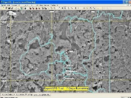

I did some more research on the ExpertGPS and made some maps. To save the map as a .jpg file you can not do. You have to do a "Print Screen" and then paste it in a photo editor of some kind. Attached is three maps I made of a 4 wheelin trip. All three maps are of the same area and trip. One map is from ExpertGPS and two are from USAPhotomaps.
First one is ExpertGPS, I had to scrunch them all down to get under the 150 limit here but you can see what I did.
murph

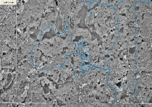

pic 2 is from worldmaphotos

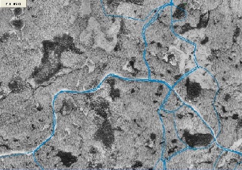

tis picture is the same as the last one but only zoomed in. You can see where I actually drove over the same trail a couple of times.
These are aerial views from world maps. The blue line is actually the trail I drove on. You can take the lines off and see the roads leading back into the trails that I went on. It is pretty accurate as the line gets put right on the roads.

I had to downsize the maps to get under the 100k limit. The first map using ExpertGPS allows me to name the waypoints. That is what is in the white boxes.
World maps only will display the waypoints when you scroll over with your mouse. Otherwise it only shows a green dot that is very tough to see. Shrinking the file made the green dots not noticeable.
I think I will purchase the ExpertGPS. I still wonder about opening the states though. I can't find how to do that or if you can download them to your GPS.
Murph
