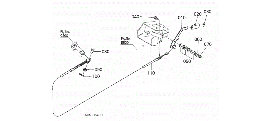

The throttle on my GR2100 is no longer staying in place and always wants to return to the slowest speed setting (handle all the way down). I have to zip tie it to keep the engine RPM's up. There is nothing binding on the cable and cable moves freely but will not stay in the desired position.
Do I need a new cable or is there something else I can check?
Thank you!
   / GR2100 Sticking Throttle #2
Usually on the throttle lever there is some type of friction washer and there is a bolt to tighten up.
David
David
Thank you. Assume you mean 040 and 070 in the picture. I will try that first.
That fixed it. Thank you very much.
