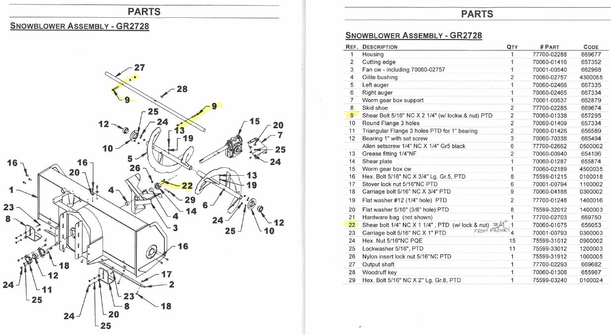

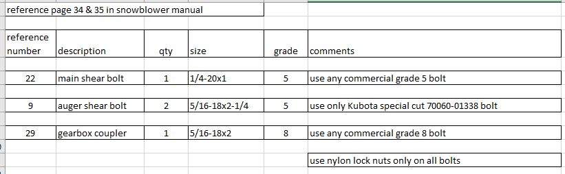

I have had my GR2120/GR2728 blower since 2009, worked it pretty hard at the end of driveway clearing out city snow plow build up. I have broke a few shear bolts, but not on the scale that you talk about. The 2 auger shear bolts (item 9) are a special cut bolt from Kubota, 5/16" grade 5 that has 2 grooves cut in the diameter. The impeller fan shear bolt (item 22) uses 1 grade 5 off the shelf 1/4" bolt. Are you using the correct shear bolts? Philip.

New blowers are sometimes a little tight. With the PTO disengaged, you should be able to easily turn the auger and fan. They get real loosey goosy after some use and take little effort to spin. The shear bolts should be installed semi-tight, don't tighten it so much you are pre-stressing the bolt. Snug is good enough. Engaging the PTO at RPM's above idle also shock the shear pins, especially with some hyd operated PTO's that violently engage. That being said, I operate my PTO clutch at full RPM and have went some years without having to change a shear pin. And, I blow a lot of snow.
