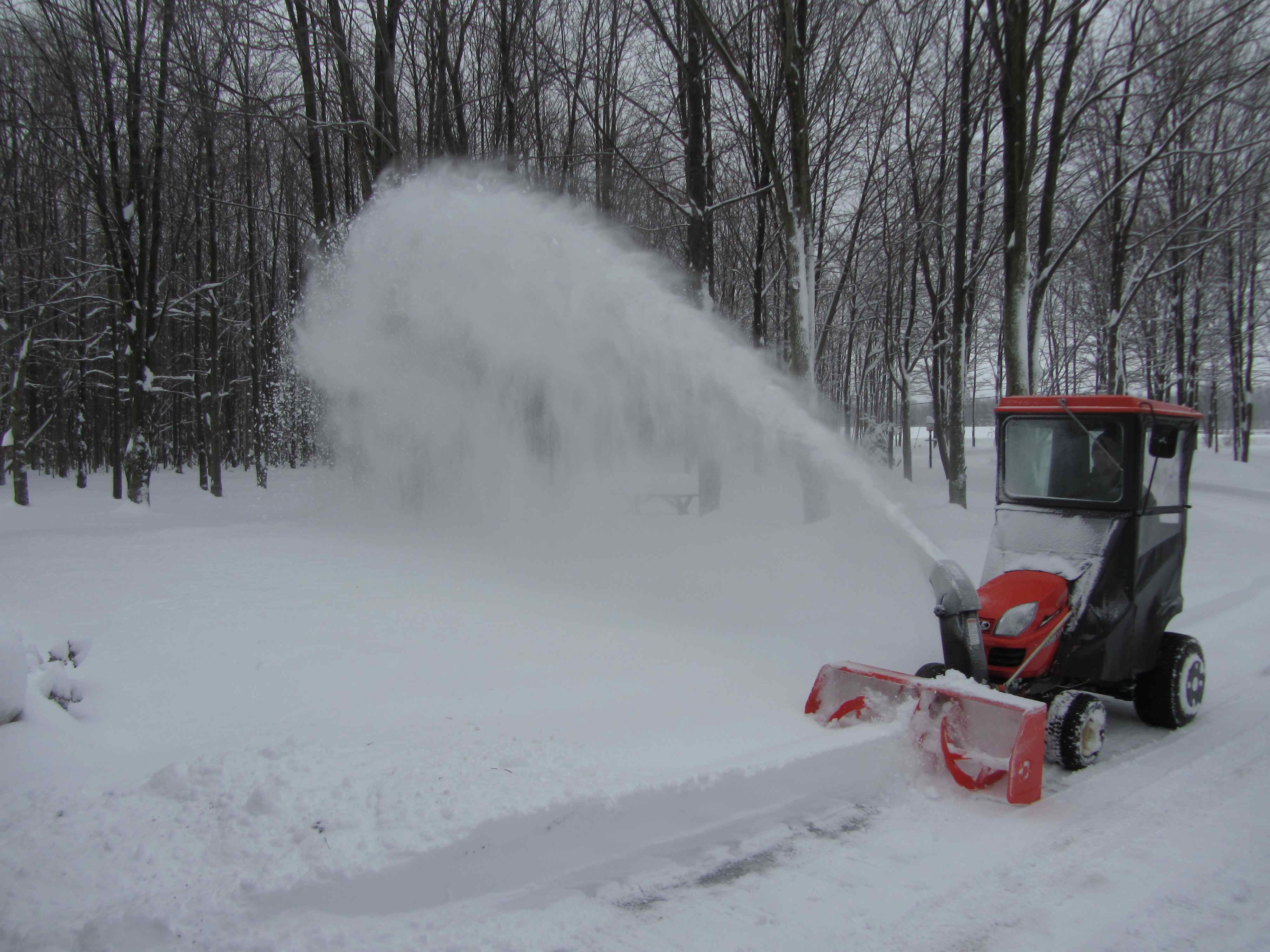

No problems for me either. 100 hours and got the blower installed, waiting for snow. Just want to mention that the blower is faster then clearing snow with my previous L3240/ with FEL

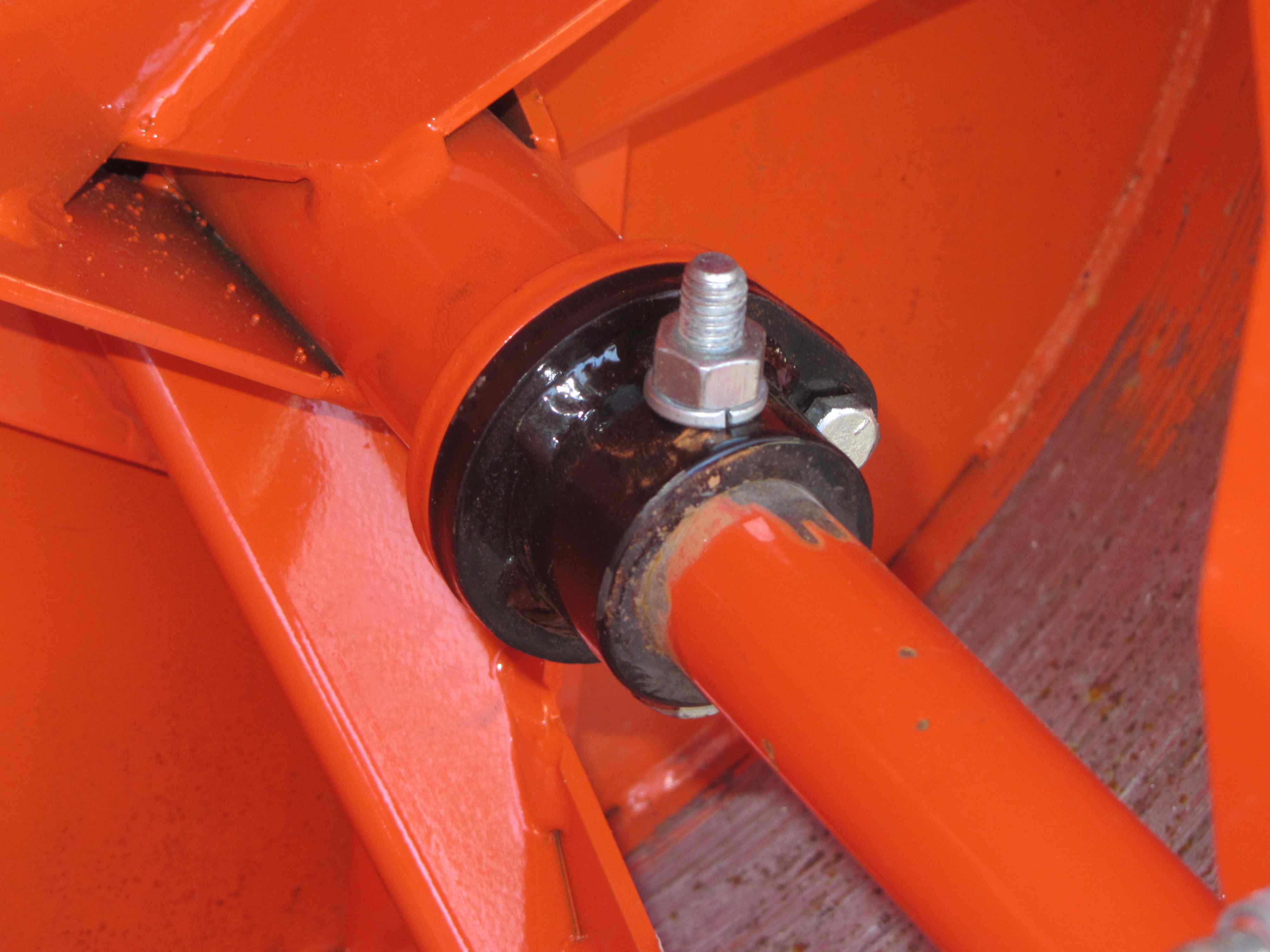

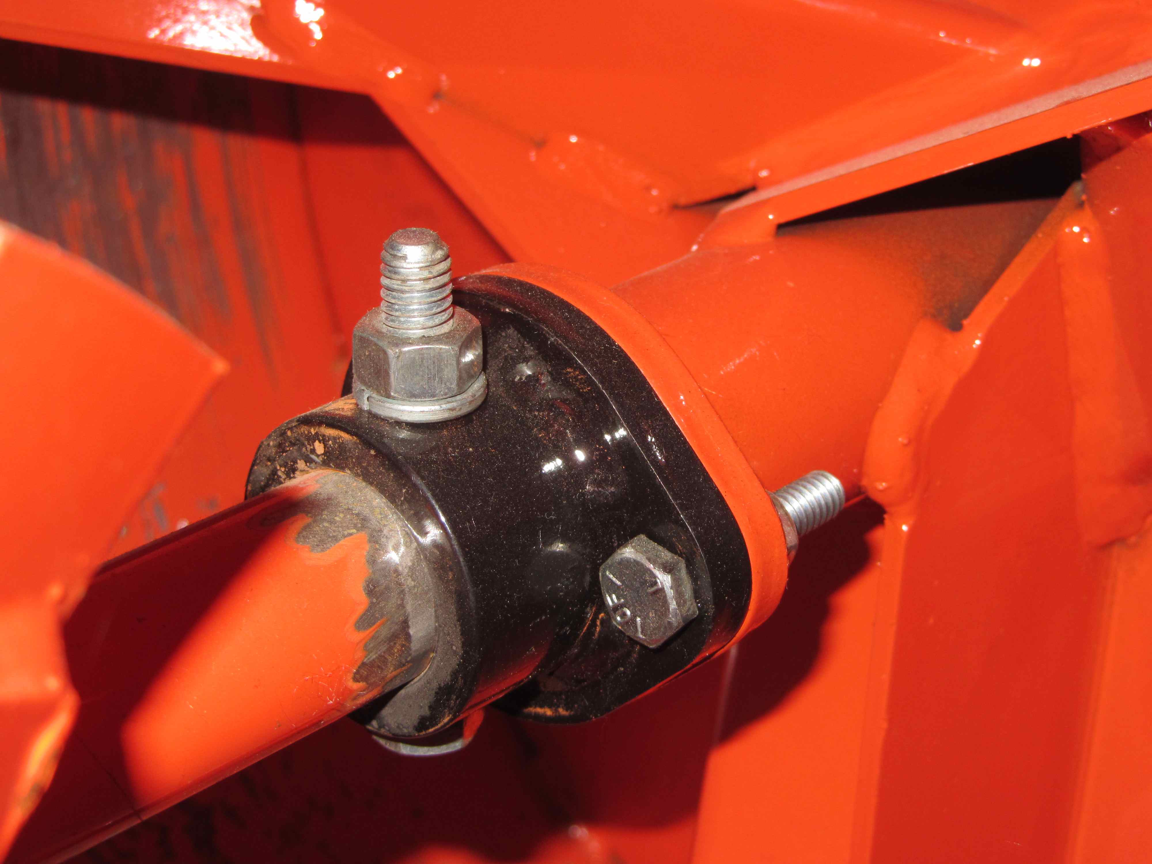

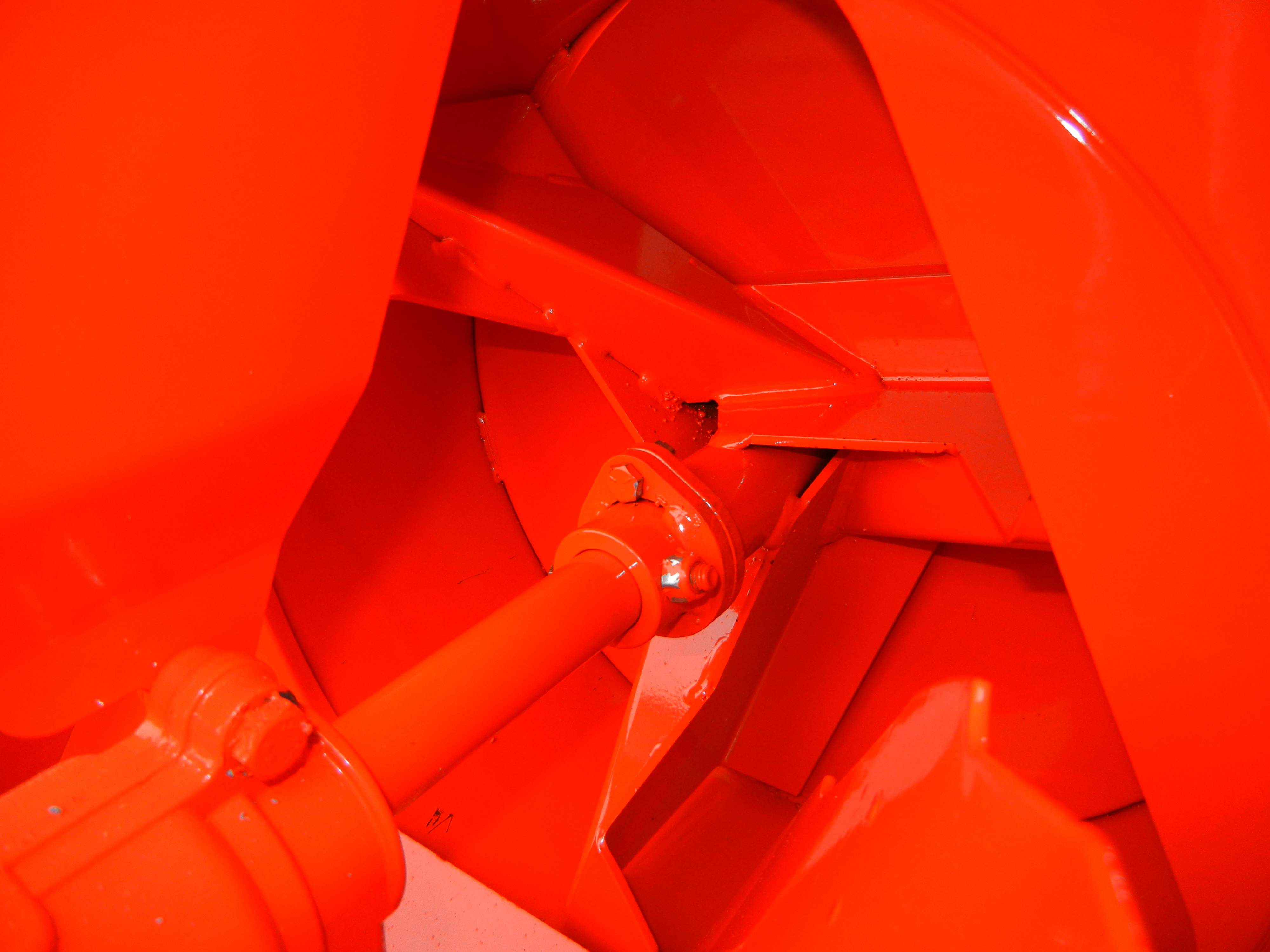

View attachment 323801View attachment 323802View attachment 323803View attachment 323804View attachment 323801View attachment 323802View attachment 323803View attachment 323804
Hopefully I was able to attach the photos of the new Fan and Hub assembly. As you will see it is quite different. The shear pin is still the same. Also I added a shot of what you have to "look forward" to. Good luck with the new orange tractor.
Andre

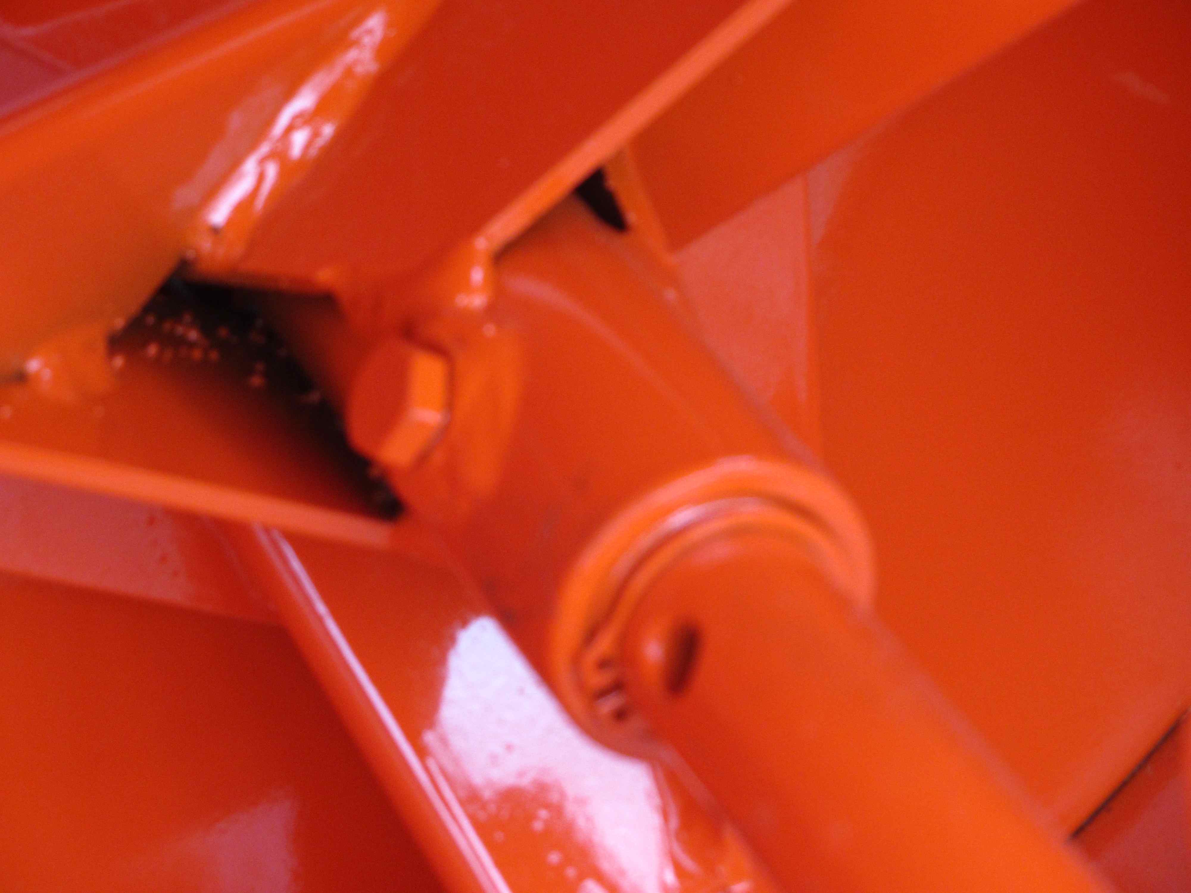

That black part is the updated part i take it.......which is the same on mine, but it's orange, which means it came out of the factory that way. Looked mine over today, since i have to replace a sheer pin and noticed that that vertical bolt showing is not there, just the horizontal one. Nothing turns by hand, thinking if lost that bolt, i should be able to turn it like the auger i lost the pin from is. Got me wondering now......
Philip...can you take a look at on yours for me and see if yours is the same as on mine on the pic below or as in the picture above?
   / GR2120 Yea or Nay #69
Looks like you are missing the bolt that connects the shaft to the hub. Lossened up and came out? That is not a shear bolt. Do you have parts manual? Will be in there. The shear bolt is connecting the two flanges, in your picture at two o-clock. Philip.
