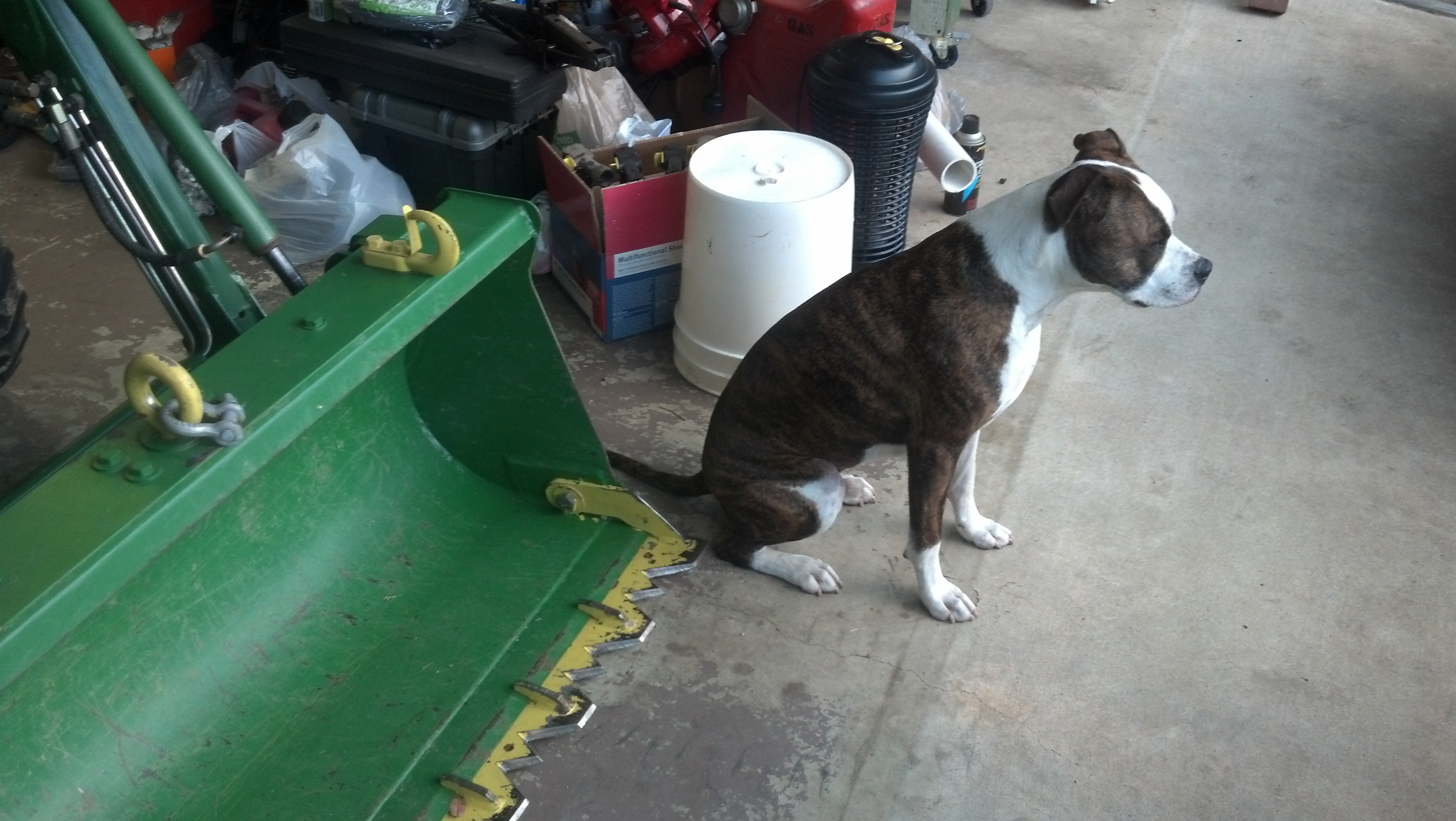

I used a similar but slightly different approach. I put an eyebolt in the middle with two hooks at the outside to give me multiple options when dragging or pulling something. I reinforced the top lip of the bucket on the top and bottom to distribute the stresses when doing things I shouldn't. With this setup, I can use the bucket to pickup things or just hold oversize items in the bucket.

GreenAtLast, I see you have one of those "side bucket" alarm systems.:)
/ Grab Hook Installation #10
I have lifted 700+lbs with it but that is approaching the limits of the bucket so I am careful. I use it mostly to drag. With both hooks and the eyebolt, it gives me multiple lifting/dragging options.
The problem with my side bucket alarm is that it likes to transfer to the seat, whether or not I am in it. So help me, if he could push the pedals he would. He is completely unafraid of the machine and when I am running the backhoe, he will get RIGHT beside the bucket and start digging too! I had to move the key storage spot. He could reach it and would take the key and go to the door and wait for me so he could ride.

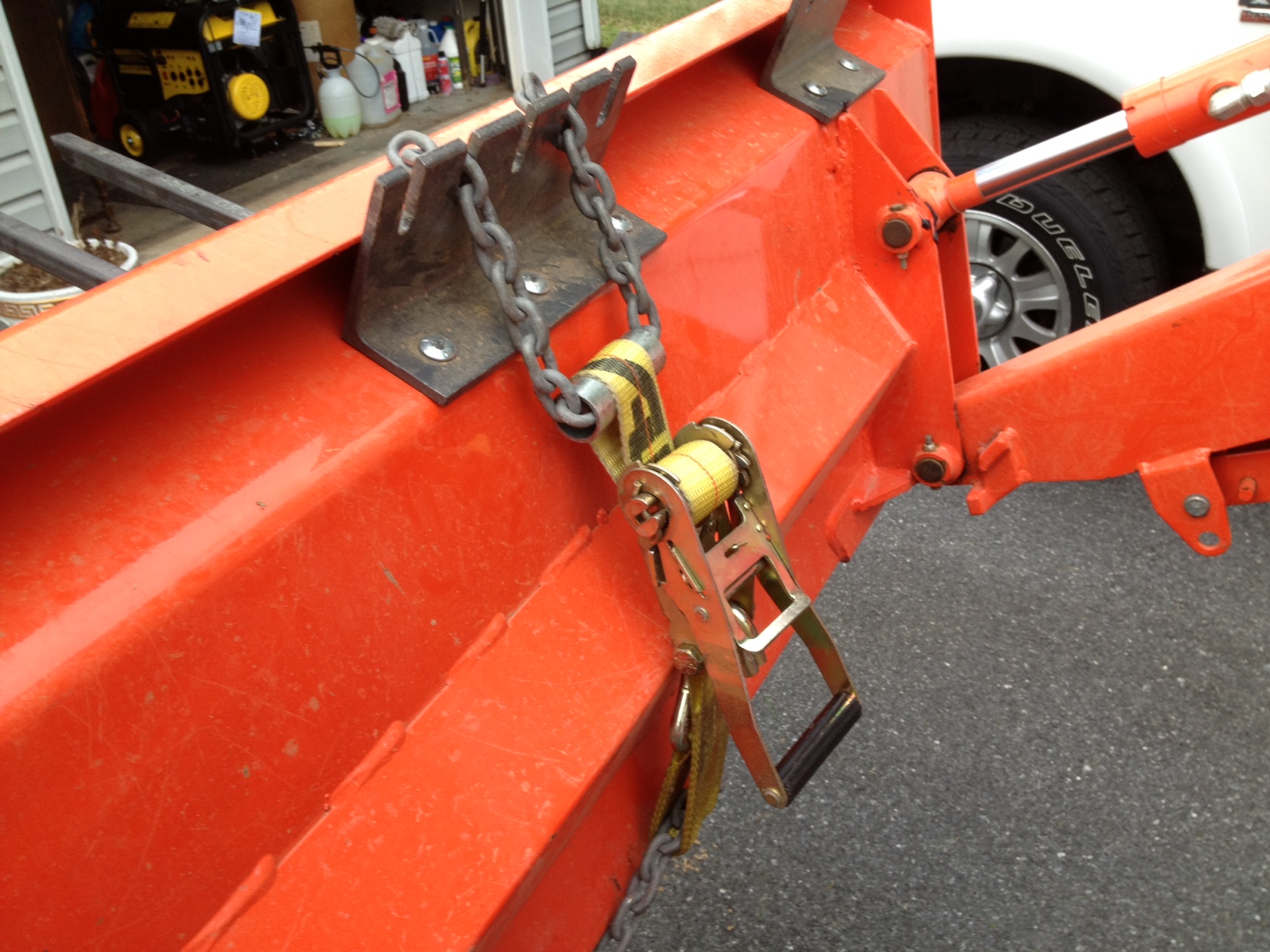

I've done the last couple buckets of mine like this, as well as the bucket on a Montana we use for maintenance at work. Heavy angle with slots to drop the chain into have been my favorite for the last dozen years or so. It provides flexibility for hookups. Loads can be applied from the front or back. This setup got a pretty good test today.
The first picture is the HD load binder ratchet that holds the brush forks on. The next two are pictures were snapped today while putting the RFM away till next spring. Usually it's a real fight to get the 6" Landpride deck tucked under the rear shelf in the shed. Seems like the casters each has a mind of its own with regard to the direction it wants to go and I have a really difficult time making the deck go the direction I want it to. This time I tried a different approach. With a sling and a couple chains I hung the deck out in front of the FEL. I was able to pick and drive it right into the spot and lower it to the floor. Hard to tell by looking at the picture, but the deck is about 18" off the ground.

I can see both good and bad with that design. It is quick to hook up and easy to adjust. The problem would arise when you had to tilt your bucket in order to perform a task. The chains might slide off. It would also be hard to use straps or ropes.
/ Grab Hook Installation #19
Tilting the bucket isn't enough to unhook the chains. To unhook the chains the slotted angle iron needs to be below the height that the chain is attached to the load. I do sometimes use that as a method of unhooking without leaving the seat. You need to allow enough slack to drop the bucket low enough.
Not sure why you think it would be hard to use straps because I do it all the time. Two of the pictures I posted above show that. Slings are available in different lengths - none of which are generally the exact length needed. The chain through the eyes allows for almost infinite adjustment.
