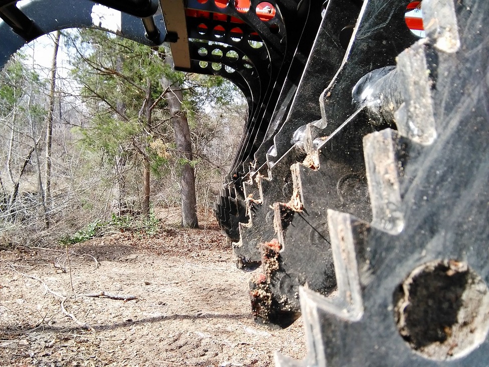

Unable to say which is best, but don't get a real heavy one, or one setup and listed as a root rake. My buddy installed one that weights about 1000 pounds on his 65hp JD. The thing is made with dozer teeth on the bottom, heavy steel with serrations on the inside (like teeth). The point is the grapple weights is about a 1/3 of what the loader can lift, so this reduces the amount it can carry. The loader is not strong enough to be able to use the teeth as a root rake, and if it is used this way, the tractors loader arms are going to get bent.

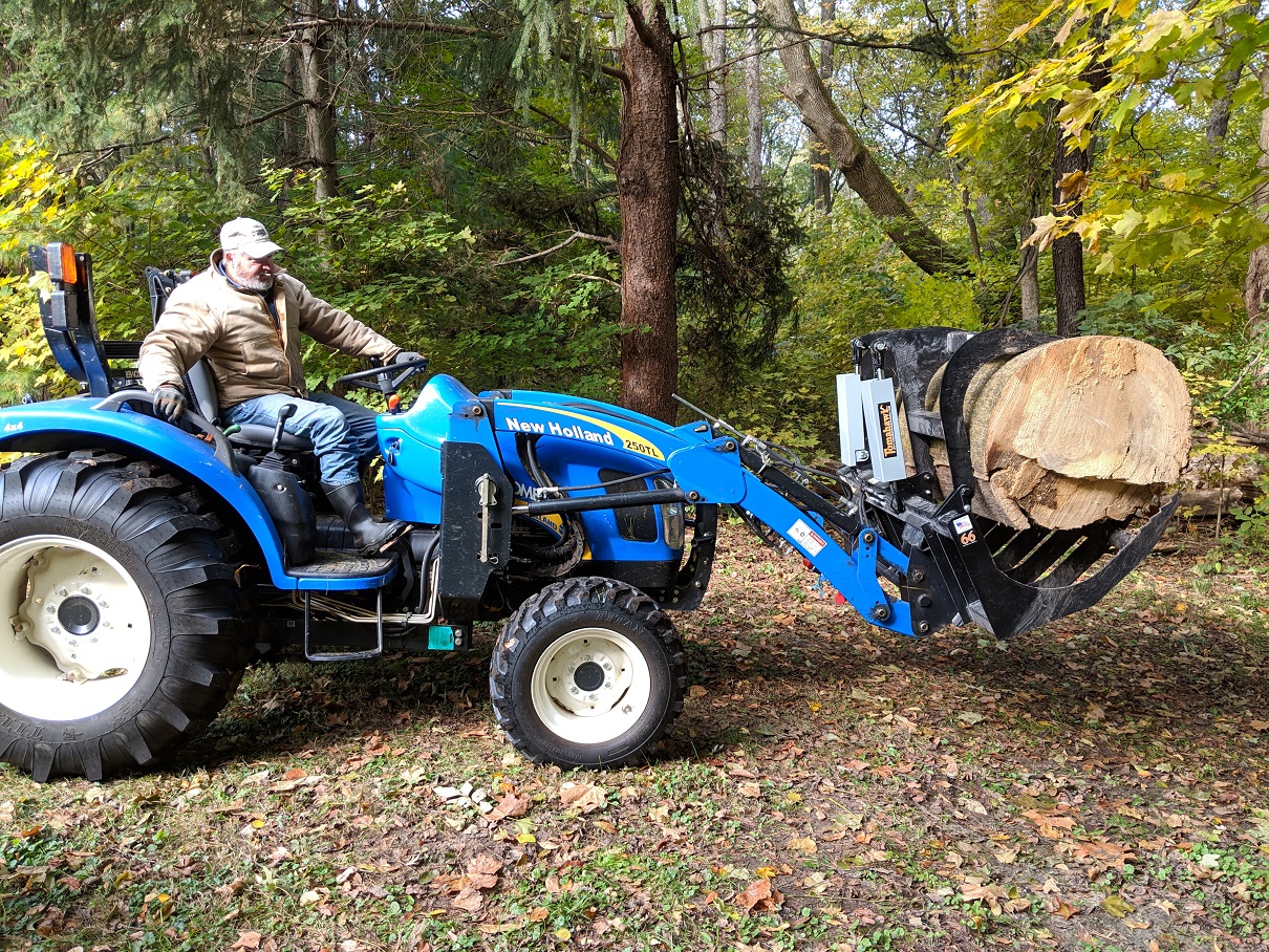

I have a single jaw clam shell style. Works great on both brush and logs. Since using my grapple, I have concluded that the difference between any grapple, be it brand or style, is likely marginal unless you have some specialized use. They all work great. I'd focus on weight and steel type. ETA uses all A400 steel which is the best. There are some others brands that do as well, but most do not.

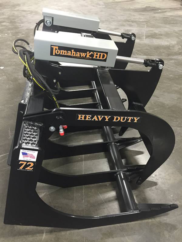

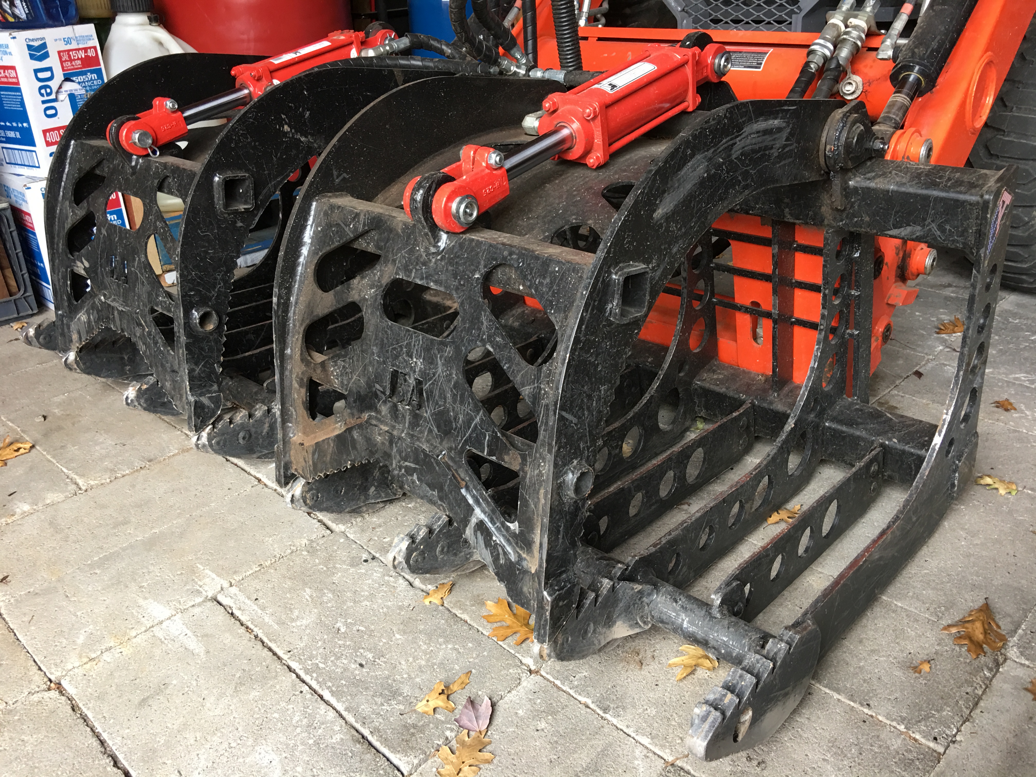

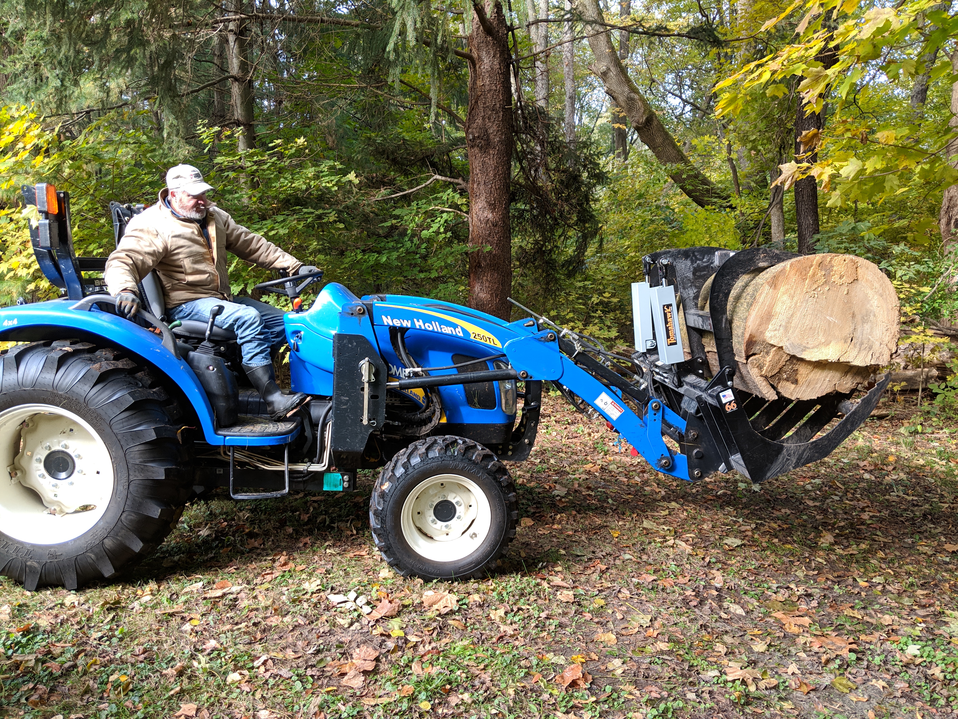

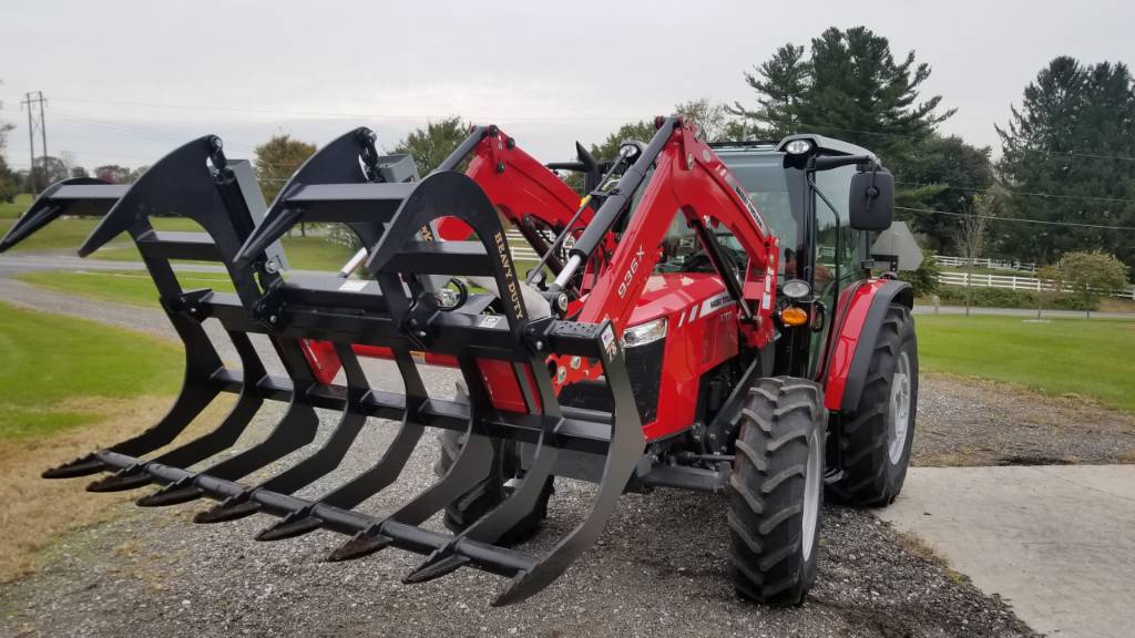

Take a look at a Tomahawk 72" . I have the 78"- it has greasable hinges, dual jaws, and is made of 1/2" , not 3/8" steel. You can get one for about $1100 here in Pa20181026_114133.jpegtomahawk-hd-grapple-03.jpeg

Agree, they all work, find your best price.
Have used single clam shell on a JD and it work just fine. Picked up several trees with no issue. Land Pride makes some nice ones also made from A400, or at least that's what they say

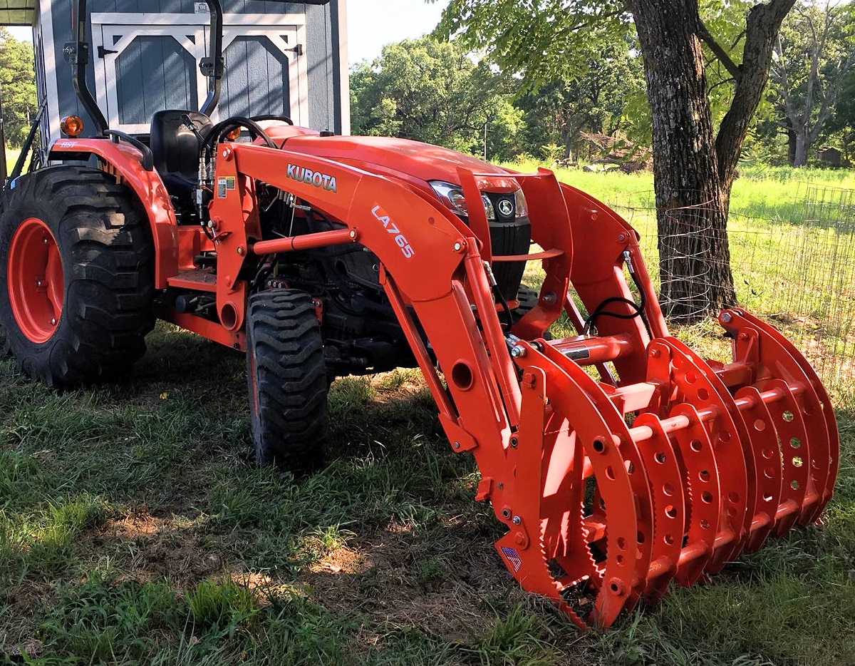

EA hands down is your best bang for the buck. Best materials, professional fabrication, excellent shipping prices, and customer service second to none.

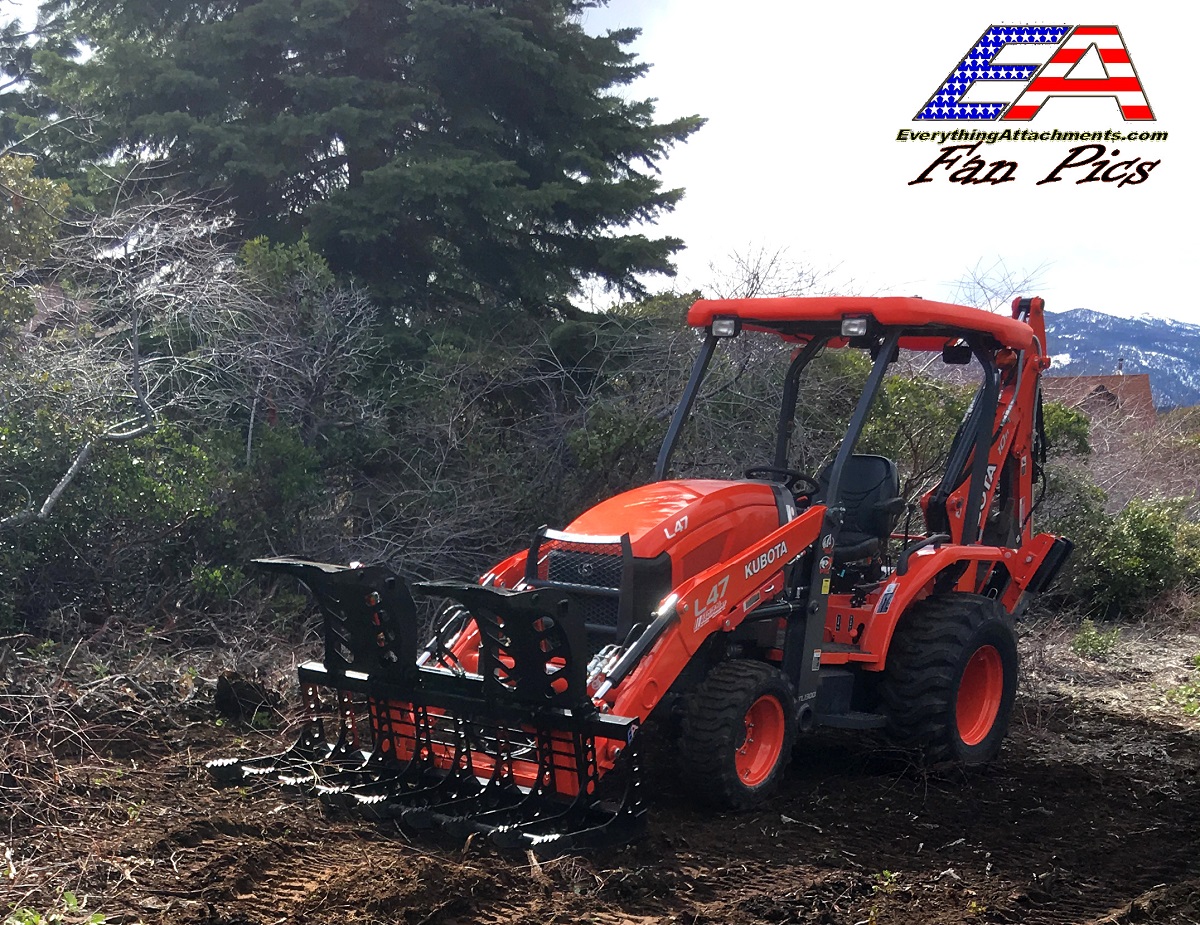

I've got two of them, dual lid root and a root rake, both 60". I had a 72" but sold it and went with 60" for more torque when working/digging and the 60" fits inside my loader bucket for traveling. I work them both pretty hard. If you wait to order when spring arrives, you'll be in a long line.

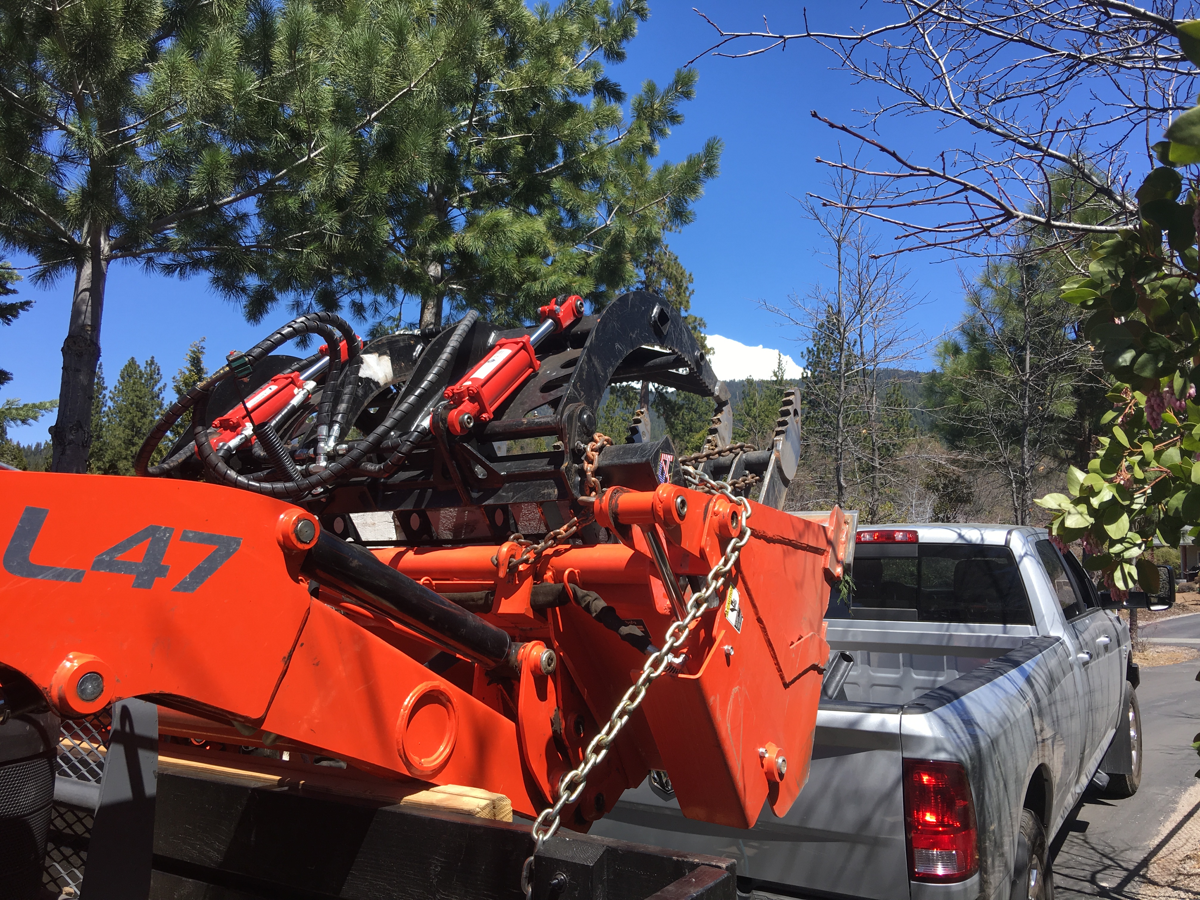

Rich,
Why you carrying your grapple with your bucket? When hauling both, I just grab the bucket with the grapple - no chains required. Just curious. I like the color of that shed in the background.

The bucket is 4 in 1. I'm scared I'll tear the hydraulic hoses up. Them tines on the grapple are "wicked". Ripped my t-shirt once when I got too close. Even if I could get a grip away from hoses, that grapple would tear that bucket up in no time.
/ Grabble recommendation #15
Okay - makes sense!

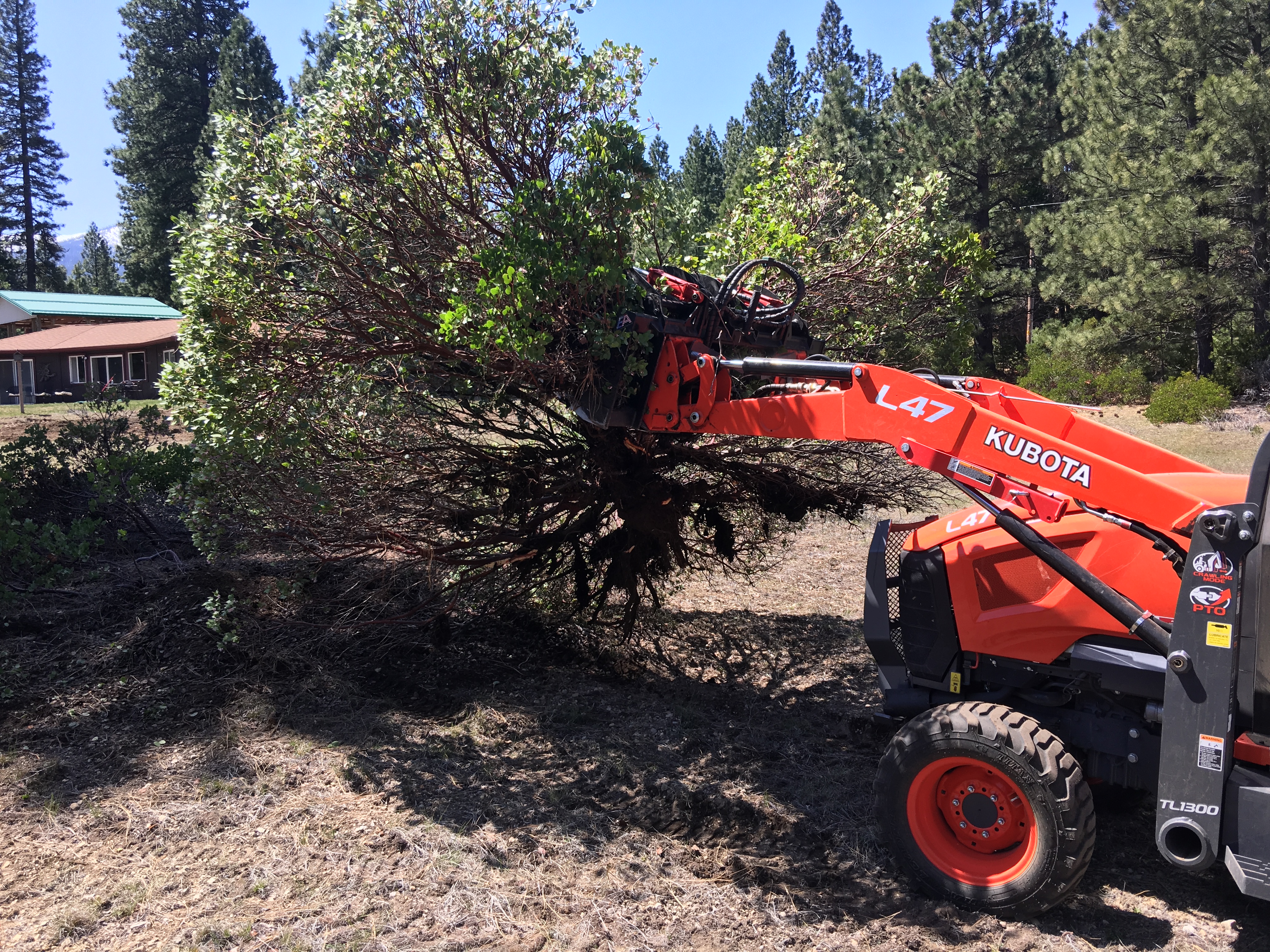

I went with a rock/root type. I have very little brush here on the 80. What I have - buck brush - I want to keep. So, I got a big heavy Land Pride SGC1560 and WR Long third function. The dealer gave a good price and did the instal. Had it five years now. It's such a universal implement - never put the bucket back on.
