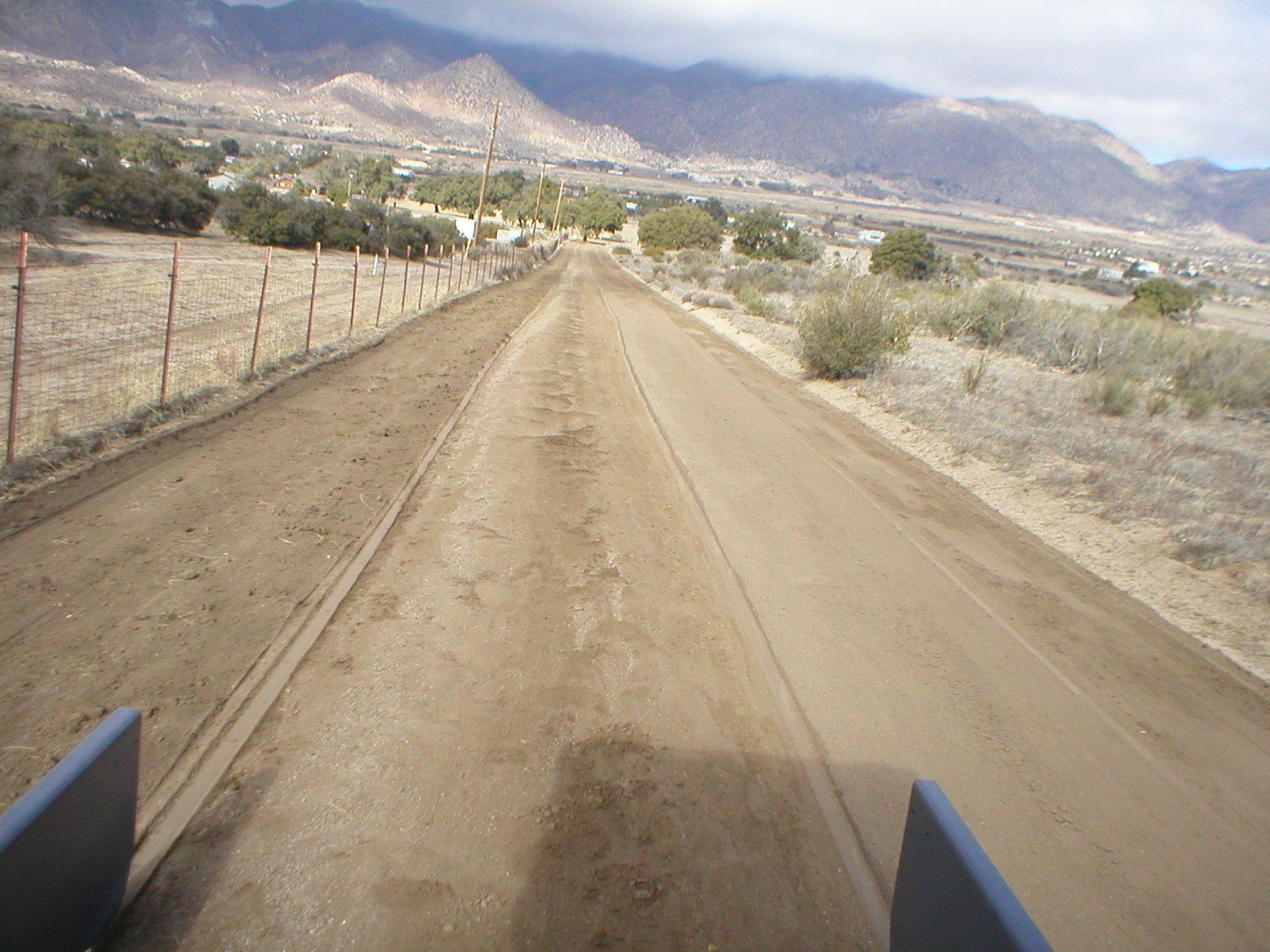

I have 4 implements that I use to maintain 2 & 3/8 miles of roads and fence lines. Roll over box blade, rear blade, land scape rake and land plane grading scraper. I use the (LPGS) by far more than any of the other implements to maintain the drive. ;)

When you get the LPGS, get one that weighs at a minimum of 150lbs per foot of width, and more is better. My 7 footer is 200lbs per foot and my 5 footer is 160lbs per foot. Better to have it heavy and work great vs wider and lighter and just work well. They all seem to work good, but the heavier the better IMO. ;)
