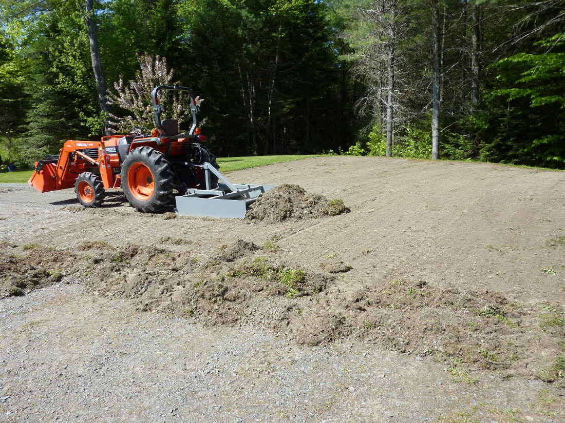

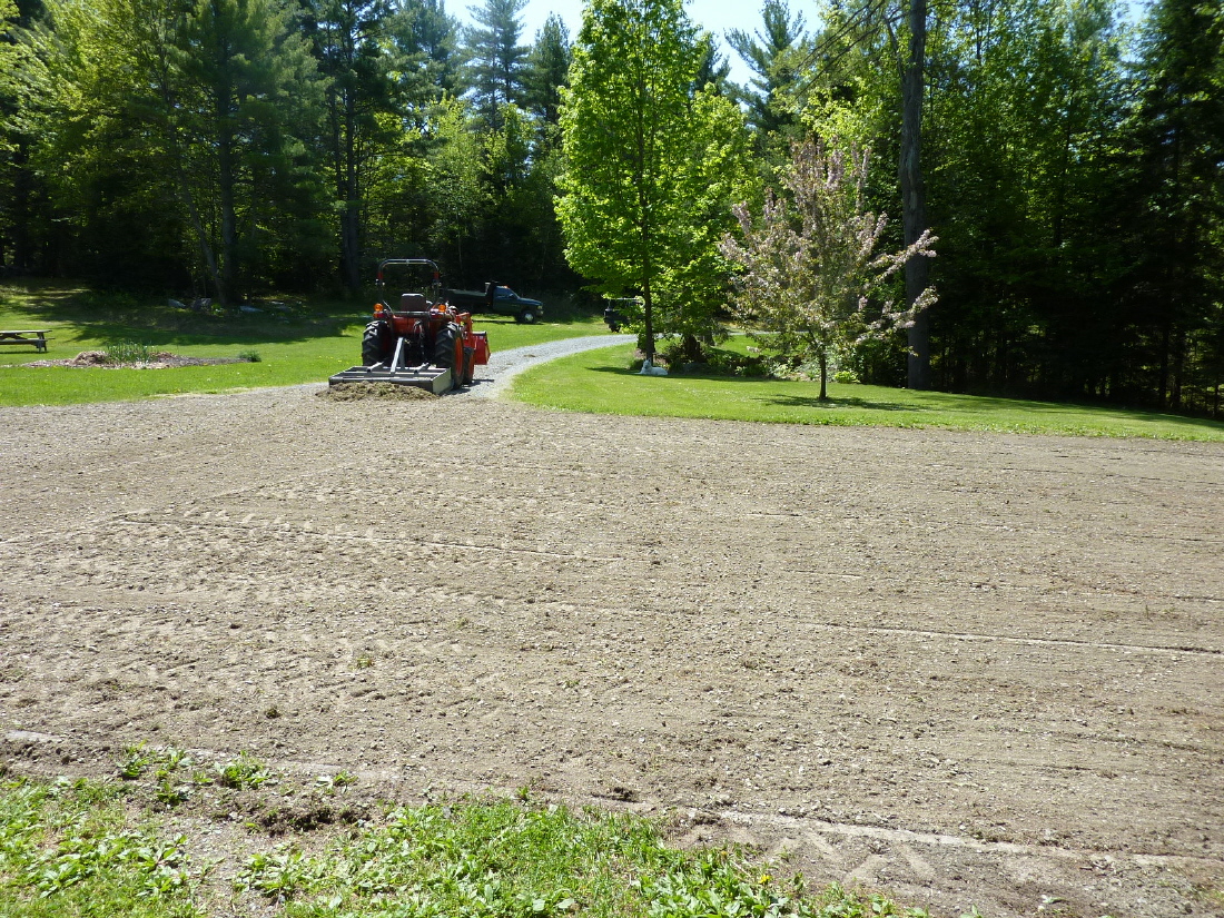

jk, I have a question about your before and after pics. My roads in many places are just like your before pic, with vegetation on the sides and center, and the wheel tracks being packed down an inch or so below that. I recently bought your same LPGS, but have been waiting to use it until after I get my rear hydraulics and T&T installed so that I can first aggressively tilt my box blade into the vegetation on the outside edges and cut a bit of a ditch. And loosen the outside edge a bit so that I can drag it back toward the wheel tracks. My thinking was that if I did not cut the edges like this first, the LPGS would just mostly skip along on top of the vegetation and cut/mix/smooth very little.
Your pics make it look like my thinking is wrong! Either that or you secretly had another 3" or 4" of gravel added in between your before and after?!
   / Grading Scraper (land plane) - Might be my new favorite attachment #22

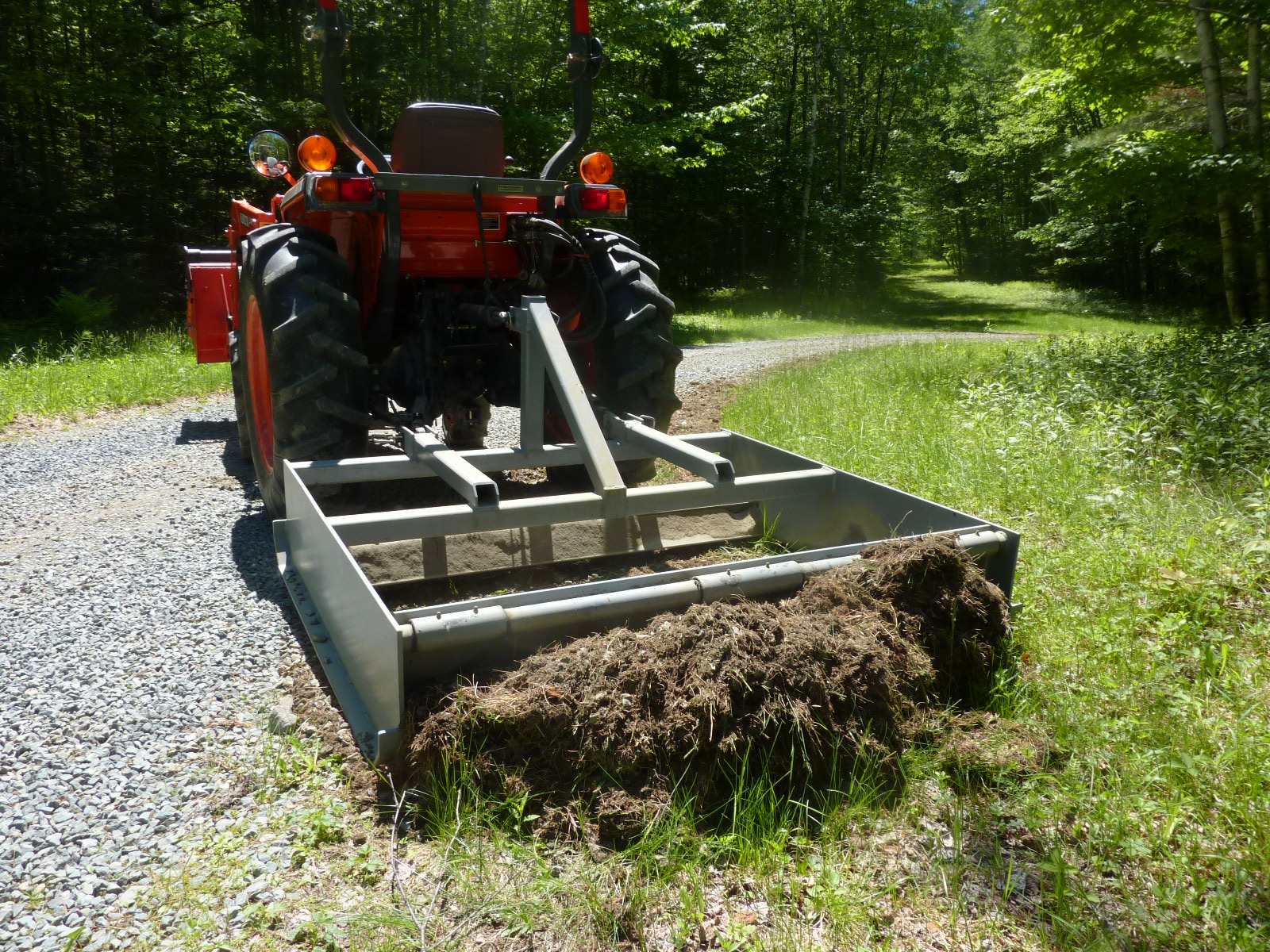

They cut sod just fine. But you have the clumps to deal with. If you keep working them they will get chewed up but it takes several passes. If you just leave them they look bad but in a couple days will dry up and disappear. I used the keep working them method here until I had just a small pile left.
Before
Working
Done
Sometimes I just push the clump of sod off the road

No gravel added. I mostly did like Gordon did. Several passes and if the box got full of grass/weeds I just dumped it and pushed it off the road until it was removed enough to work the gravel.
