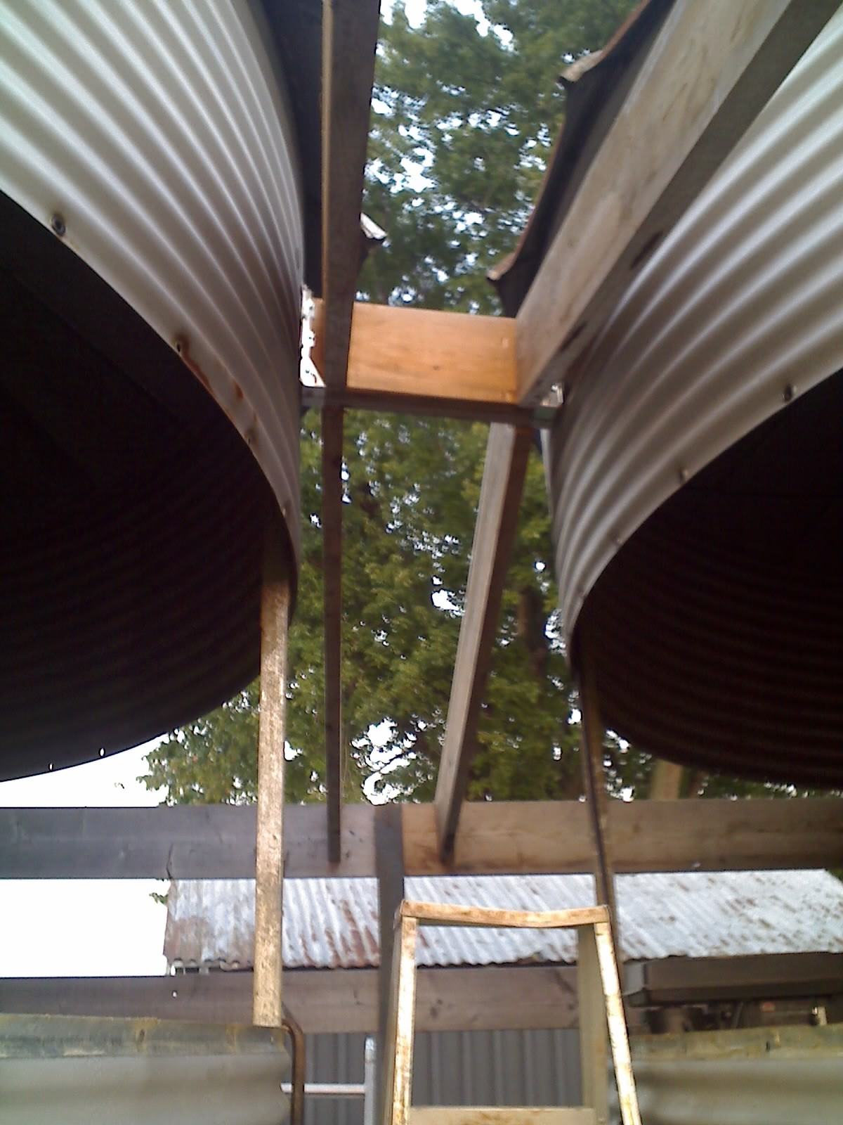

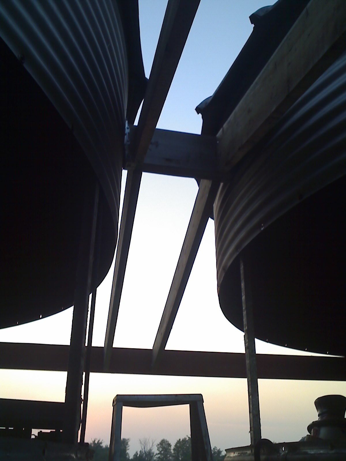

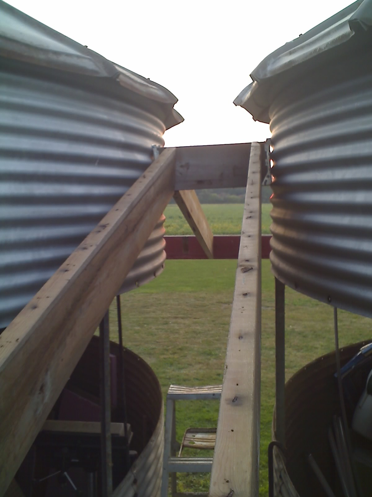

Here are a few more pics from inside the shed.:D
Roof pictures
Here how I tied in the 2x8s and 2x10s

That corrugated metal is plenty strong! Are going to flash and seal the roof connections or do something else?

Going to seal the edges and shingle the roof. Thought about putting a metal roof on but shingling is much easier to cut the curves of the bins in.

What I was asking was are you using metal flashing where the wood connects to the metal bins, then sealing?

Very creative. Looks like it's going to be tricky to get a good seal between the bins and the roof.

I really can not visualize flashing it so the valley does not leak over time with all that water coming from each roof from just the photos but the grain bins do have a bit of an eve. If the decking was 4" higher at the bin walls it would give a natural valley and no positive water pressure could exist on the sides of the steel walls. At the top I see you can flash all the way up under the bin eves but that is not the point of high water volume.
