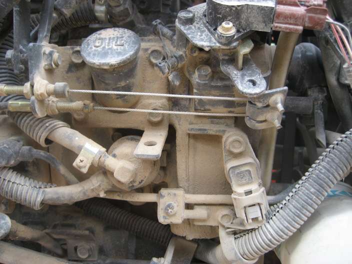

Can you tell me where you made the Auto Throttle adjustment so that the RPM don't go quite so high when I just barely step on the HST pedal?
Unnecessary to me to have Auto Throttle on, step on the pedal, RPM goes to over 2 grand & I'm going like 0.1 MPH!! :)

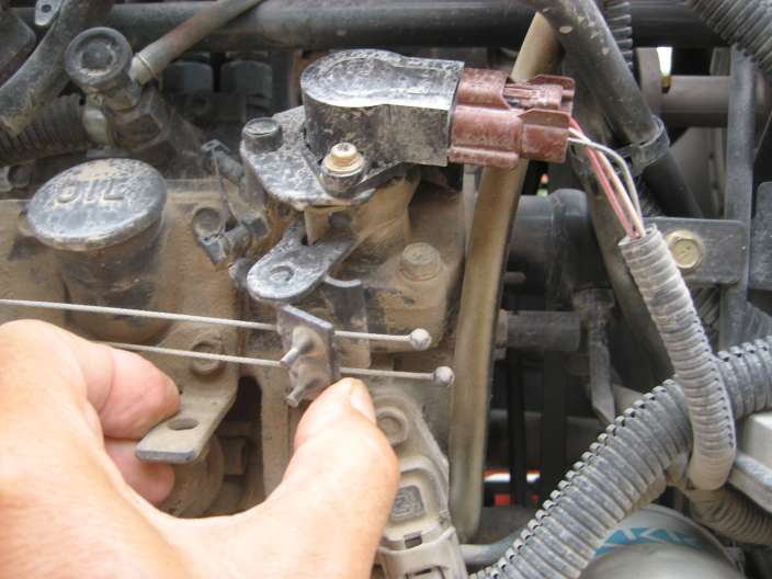

IMO the way the Auto Throttle is set on delivery is why more people don't use it. What's the point of Auto Throttle if the engine is reving to 2K before the tractor moves anyway? OTOH this makes it to where you can actually use Auto Throttle with PTO implements without bogging down the tractor. But the hand throttle works better w/ PTO implements anyway. So I think adjusting the Auto Throttle down a quite bit makes Auto Throttle much more useful. I thought I had posted pictures of this adjustment. But I can't find it now :(
The adjustment is made on the right side of the engine (facing as you would drive it). There are two cables. One cable is connected to the hand throttle and the other is connected to the HST pedal when Auto Throttle is ON. You can find the cables and throttle pretty easily by just moving the hand throttle and seeing the cable move the throttle. Note: they both move the same throttle linkage but they can only pull it (i.e. increase engine rpm). So either one can 'override' the other one by pulling the throttle open further than the other cable. The throttle closes with a spring that holds tension against these cables.
The HST pedal cable is the lower one. You simply turn ON Auto Throttle and adjust the cable so it begins to move the throttle just after the HST starts to move the tractor. The exact setting is a personal preference. You may need to test it in a few different settings to get it where you like it.
Edit: Added pictures of the cables and how I have mine adjusted.
