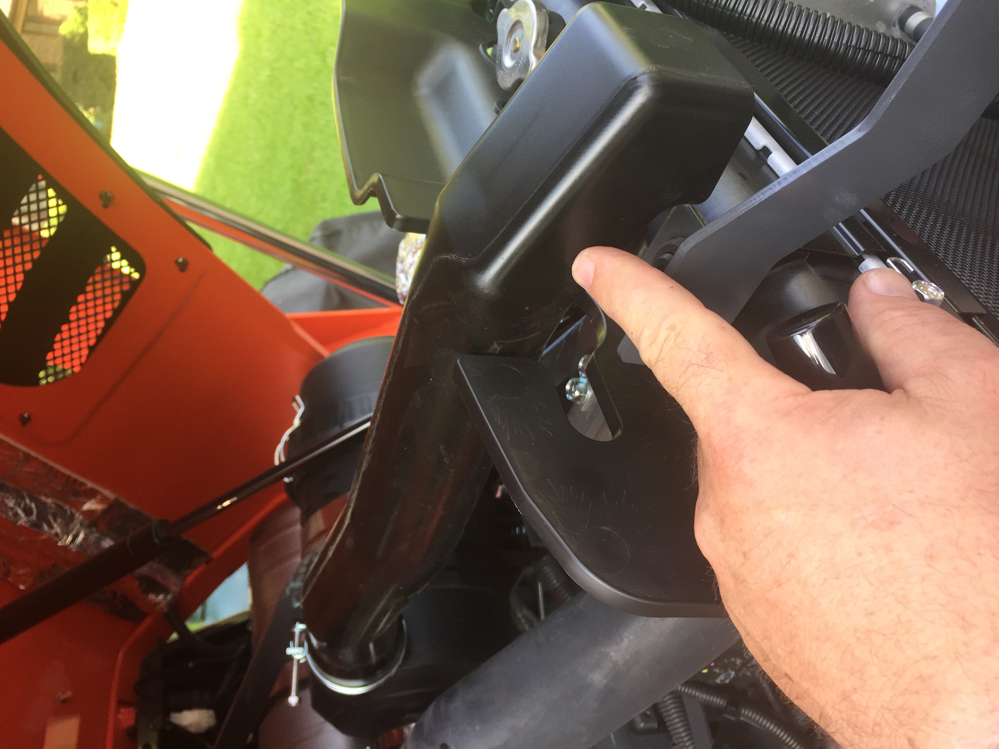

Guys i've looked and there the exact same turbo engines. Is it just the ECM that's different or something else?
Post up some pictures so we can compare the intake's of the 2 as I'm curious on how Kubota is making the extra Hp.
Not familiar with the 5460 but manufacturers often turn up the governor (increased RPMs to increase HP.

Will someone go out and take a picture of there Air inlet tube an the Turbo on there 6060? Seems like the Air inlet tube is awful small..
