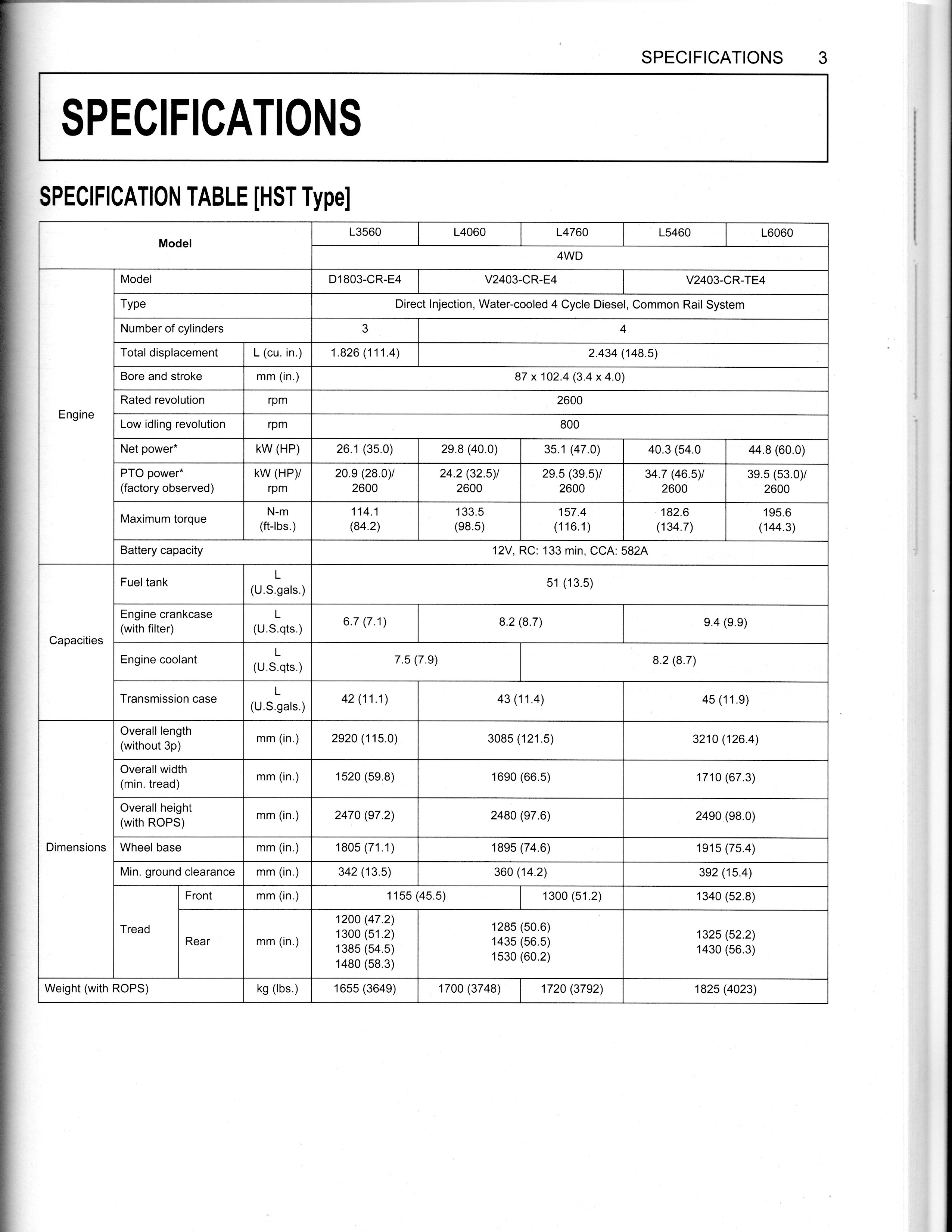

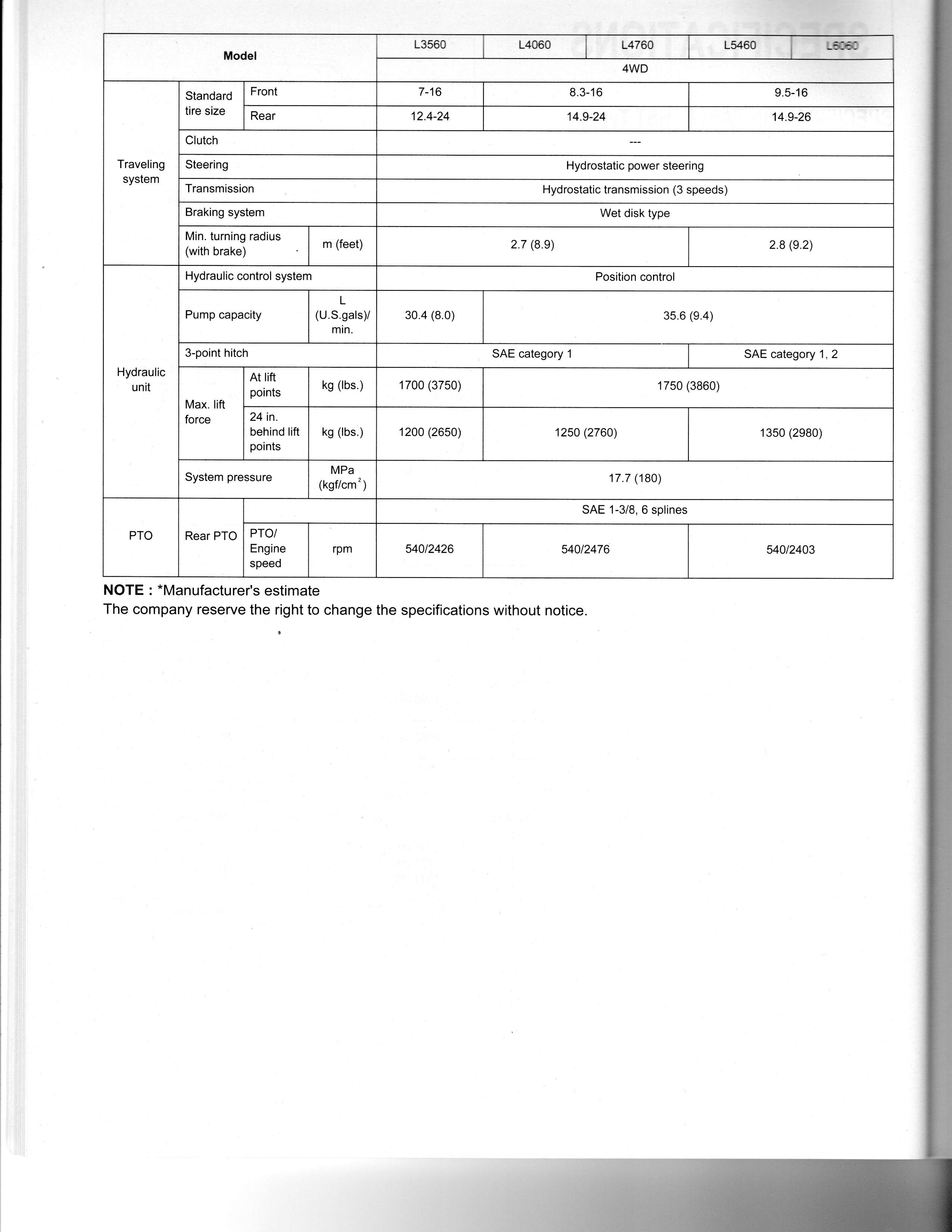

Is everything else exactly the same? I ask because in the MX series, the MX5200 comes with extendable lower links and telescoping stabilizers that the MX4800 doesn't. That and the turbo are the biggest differences, I think there may be some other differences too, so the engine isn't the only thing that makes up the price difference. When I was internet shopping it seemed like Kubota did something similar in other lines also.
Below are scans of the specification pages from the manual for HST Grand L60 tractors. The only differences between the L5460 and the L6060 are the HP and torque ratings.
All L60 series tractors come with telescopic drag links.
