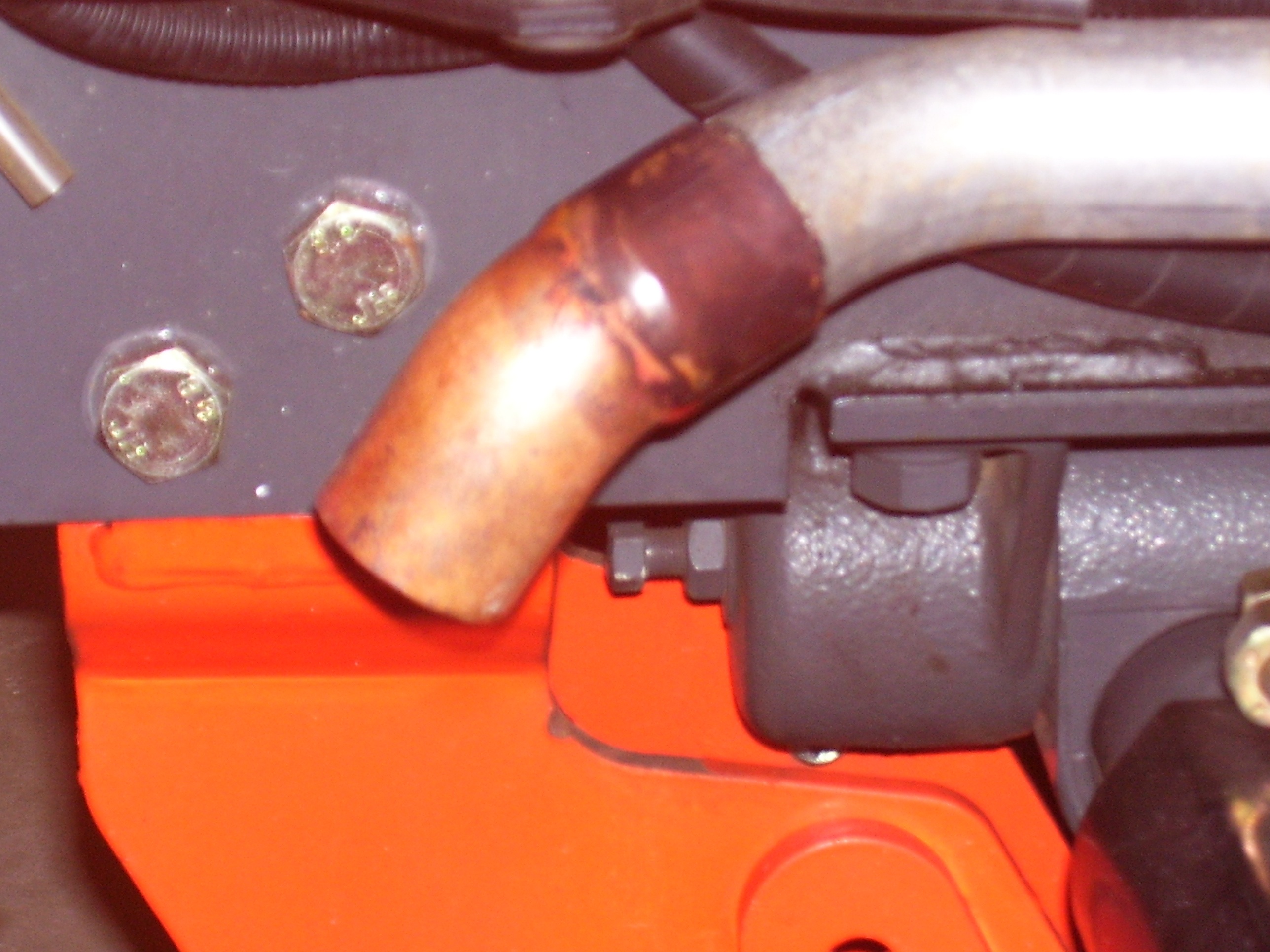

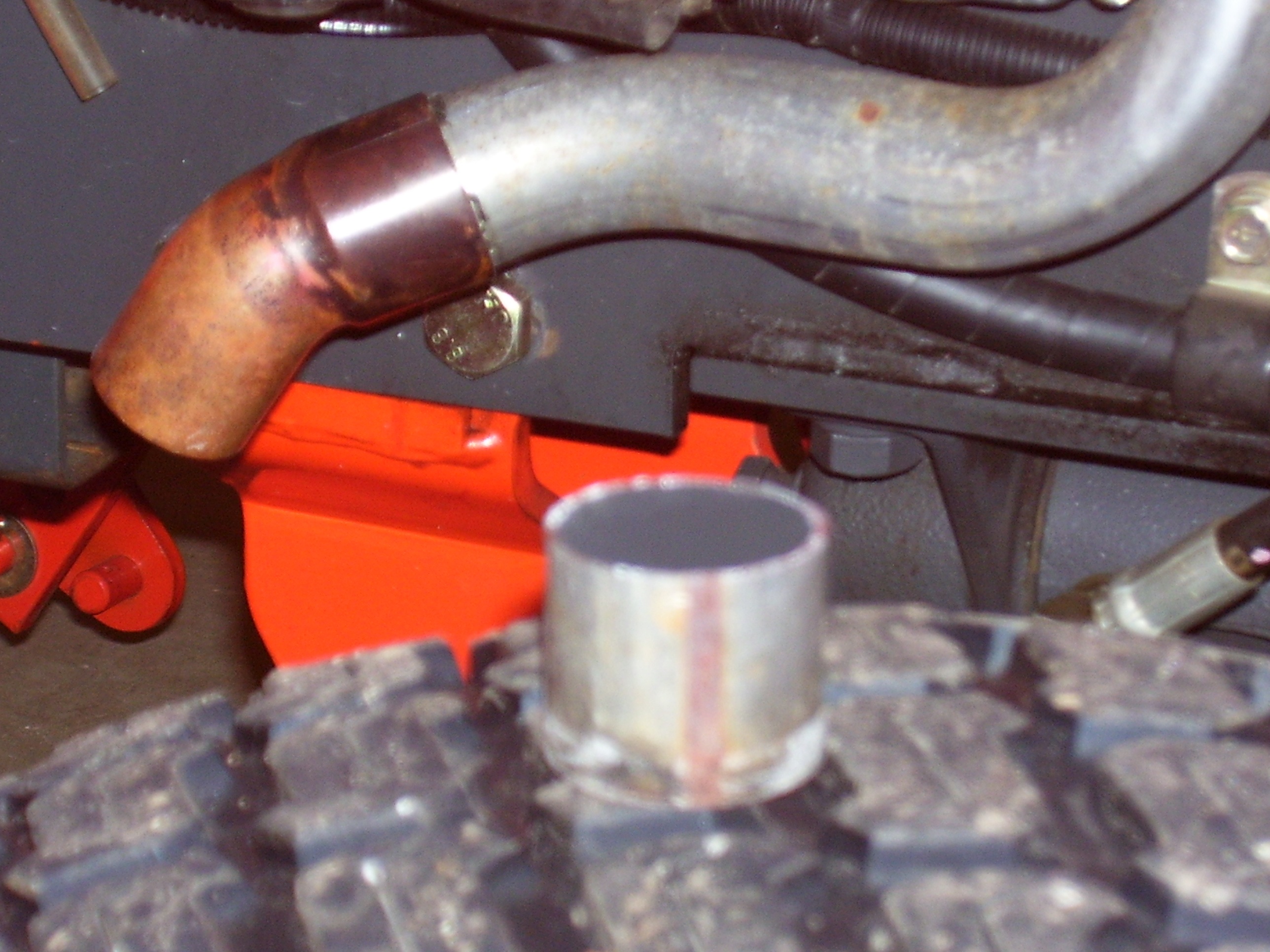

Kuboman, I have a cabbed tractor but was annoyed how the loader arms were getting black. I went to a plumbing supply house and bought this $10.00 copper plumbing angle piece. I heated it up with a propane torch to get it to expand and then slipped it over the exhaust pipe. I had to trim the exhaust pipe first so I could get my angle correct. Not the prettiest, I never did get around to paint it but it works great. No need to solder it either as once it cooled and shrunk it's not going anywhere. You can see the cut off piece of original pipe sitting on the front tire.
Yours is a B by the looks of the exhaust pipe. The GL's dump the exhaust by the front tire and seems to go everywhere. Just was wondering if anyone has done any modifications to the GL exhaust.
Your mod looks like a good idea for the B series.:thumbsup:
