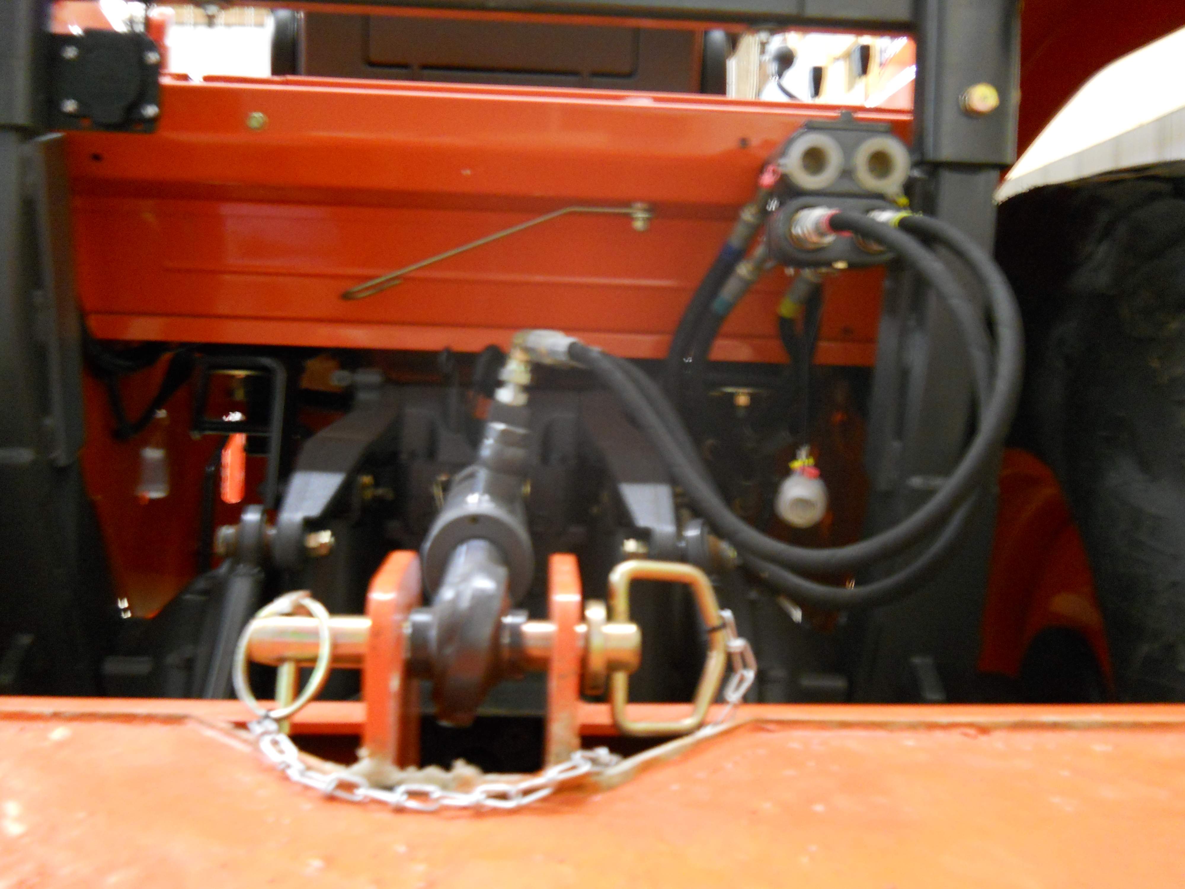

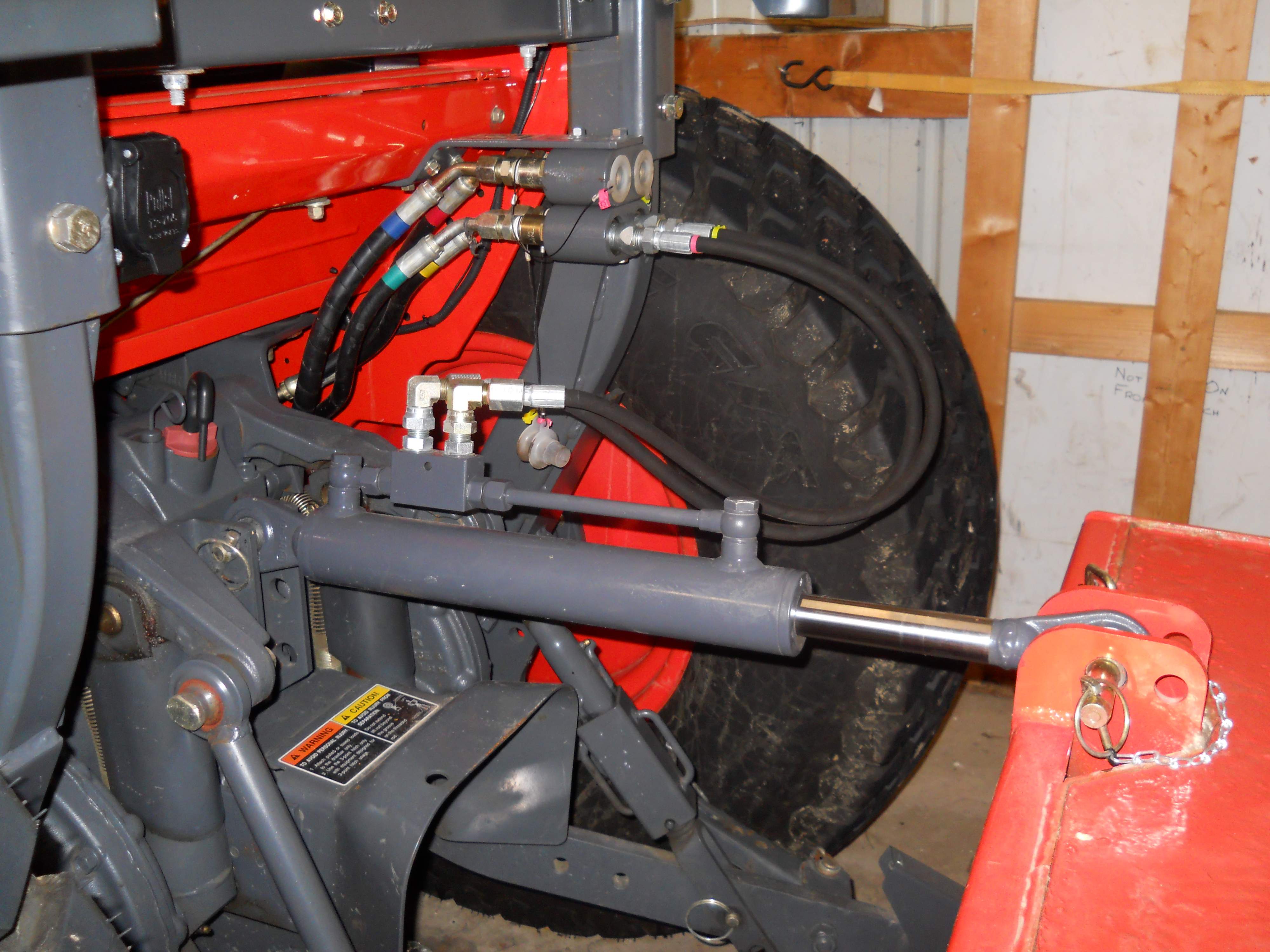

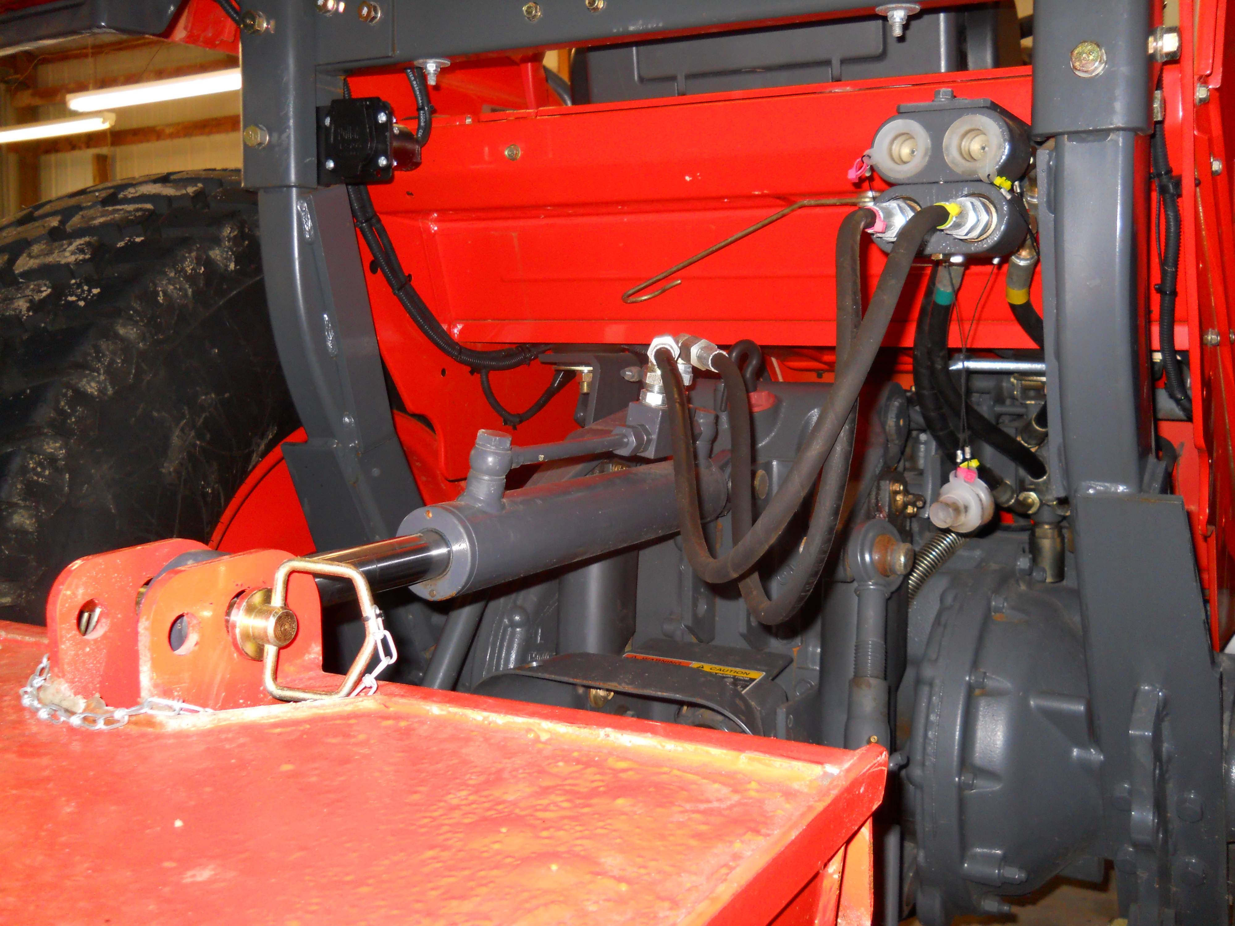

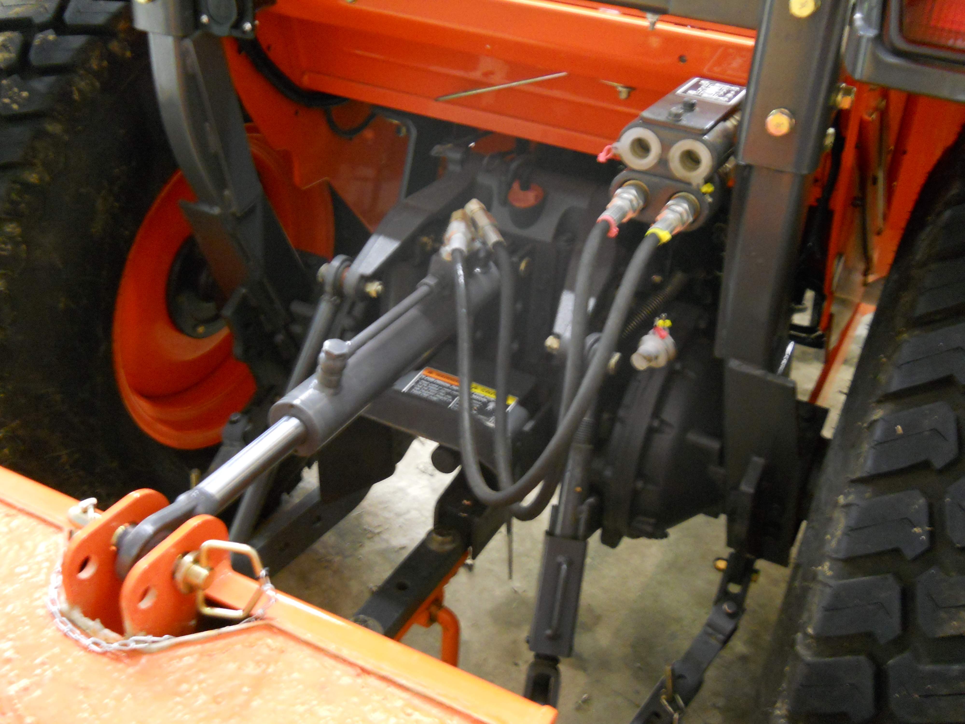

DDT I just bought a L5740 and am looking for a hydraulic top link. Where did you get yours and do you have a picture of it?

I got mine from CCM. Philip.
Phillip what is the PN on yours and what is the length/stroke, I am thinking of replacing mine as it doesn't have the dpcv, thanks.
   / Grand L exhaust #28
Part number and other information is in pic. Hopfully with this info CCM can give you details to replicate. In my notes I have oem center to center range as 21" - 34". Hydraulic top link center to center range is 21" - 32". Don't forget the 90 degree fittings or the banjo fittings on the dpcv. Philip.
