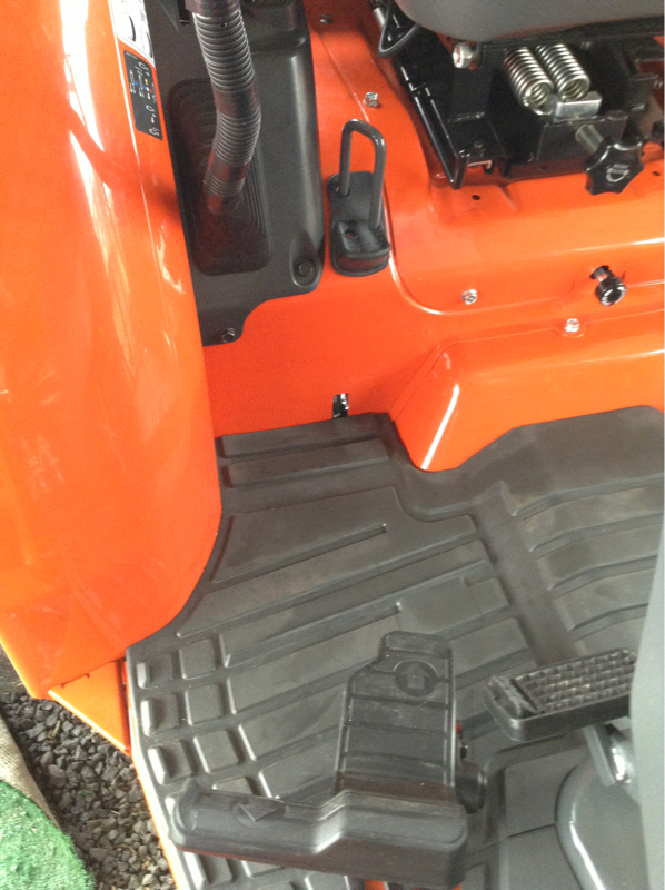

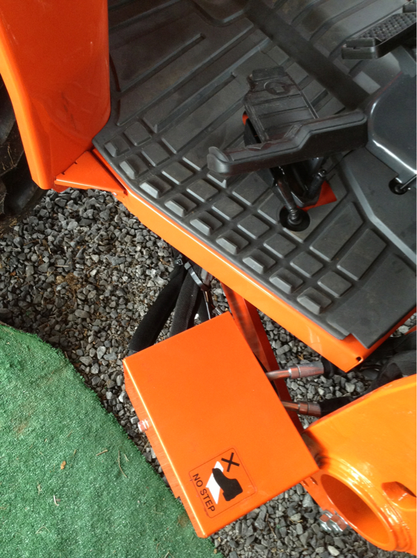

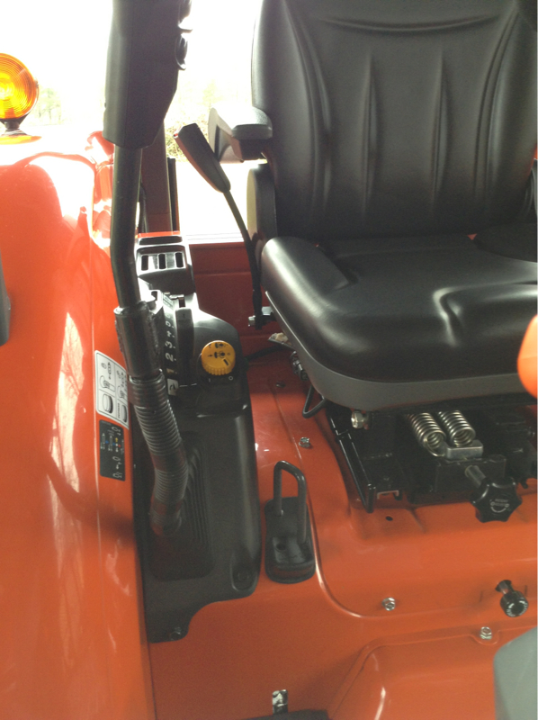

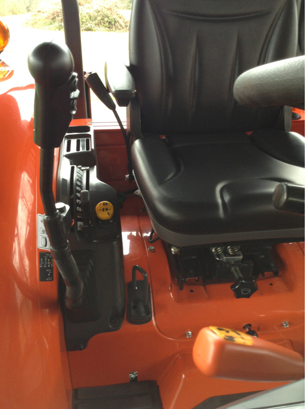

Wanted to follow up with some after pictures. My dealer picked up the tractor the next day after it was delivered and basically did a complete "redo" om the 3rd function valve installation.
This is what the 3rd function valve installation should look like....

Where did the wires go:confused3:
That looks a lot better. I would keep a piece of cardboard under it to be sure it is not leaking.

I have been watching it close....so far very clean...I can tell all of the 3rd function hydraulic connections have been replaced and properly seated this time.

Much better! :thumbsup:
