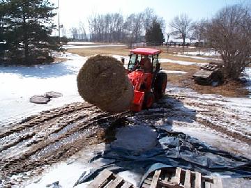

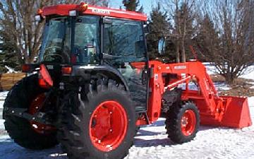

I've enclose pictures of the Grand L 5030HSTC.
Show your wife this picture and tell her that the stereo plays Buddy Jewel really well and the air conditionong will freeze you out. Then tell her that the HST is about as easy to drive as her SUV. Show her the next picture and tell her that if the tractor will lift that bale, it will handle anything you have to do. At this point, take her to the local Kubota dealer and buy one. It's a 5030 HSTC with a LA851 loader.
As far as power drop, you will lose about 3 realtime hp., at the pto. Kubota engines have a really good torque rise and it's the torque figure not the horsepower that will drive the implement during heavy work. People base tractor purchase decisions on pto horsepower alone. The horsepower plays an important factor, but the realtime torque rise is what is important for maintaining implement speed versus ground speed.

another picture, this one of the LA851 loader with a bale on it.

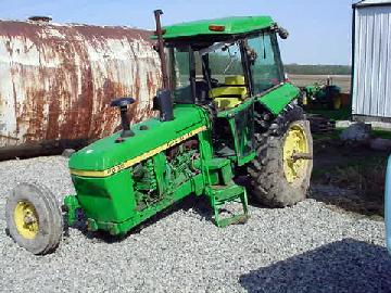

Check out my post under JD Supeersteer Photo's. That's a 4050.
