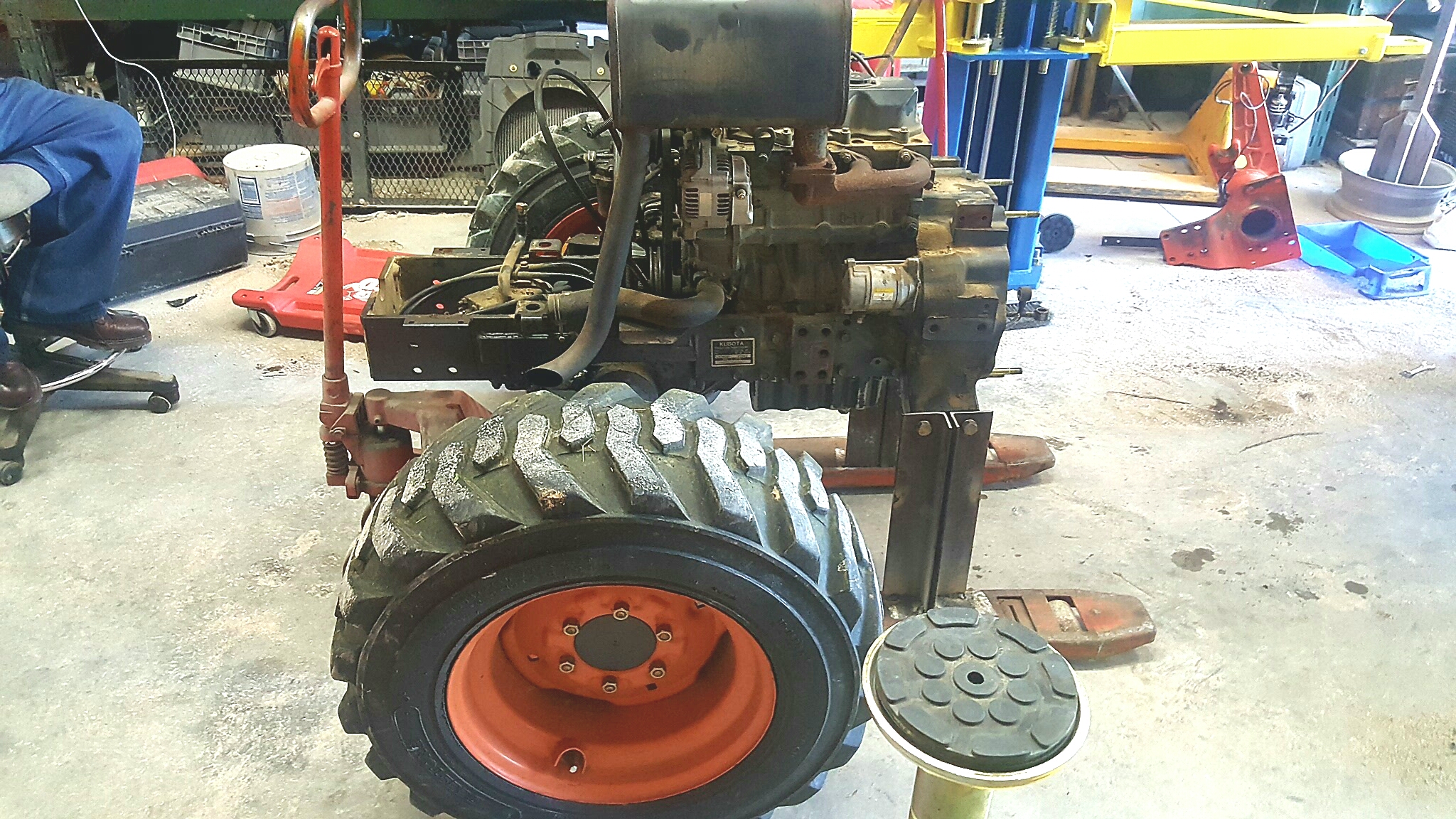

Pallet jack makes a perfect way to do this job. I had to do this job on my 08 L3240 cab. Make sure you replace the bottom propeller shaft seal,sleeve two orings as well as new input shaft, and seal housing gasket. Mine was leaking from input shaft seal. My seal was totally worn out at 1700 hours. I used a pallet jack and welded 2 pieces of channel iron to the pallet jack and it make the split so easy. The hyd lines are the worst part. Take lots of pics and label all bolts with a organizer tray. Job can be done with cab on. Btw my clutch looked new still at 1700 hrs.
   / Grand L4740 hydraulic fluid leak. Ideas? #27
View attachment 496946View attachment 496947
Actually i used angle not channel. But either would work fine.

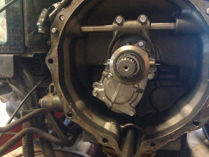

Hello all. The parts diagram I have are a bit deceiving. I cant tell if the snap ring for the propeller shaft is inside the clutch/trans case or behind the trans case to trans sump case? Can I reseal the propeller shaft with just splitting at the clutch housing? I'll also reseal the trans input shaft and housing while apart. Thank you for any help! I have a L4740HST. 09' I believe.
