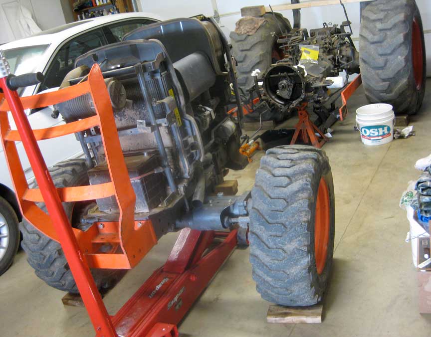

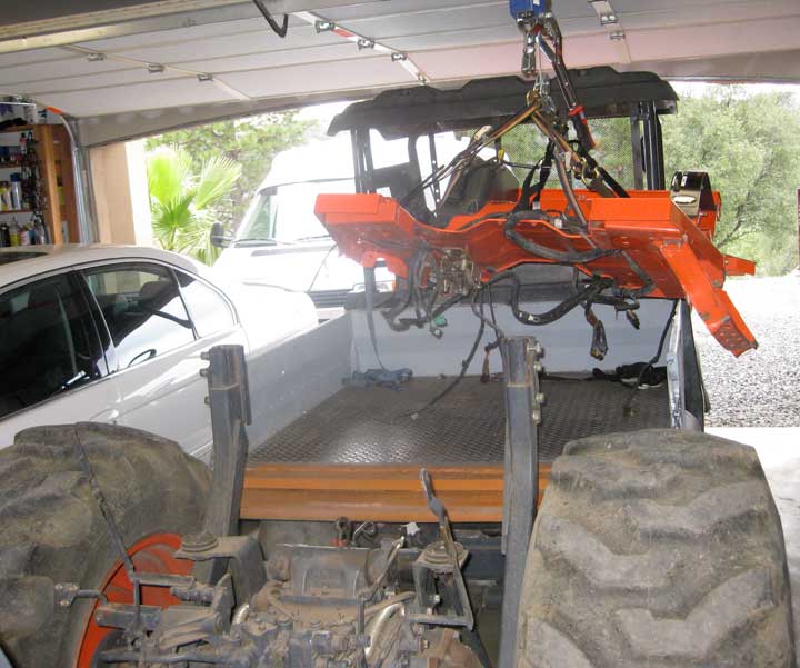

I did a little digging through my Facebook posts and found photos and notes covering my tractor splitting adventure. I'm cutting/pasting below.
Tractor Cracking
Finally got the superstructure off the Kubota today, so it's time to split the clutch housing from the engine and find out what's leaking. Hopefully it's the three dollar seal I have on hand and no new parts will be needed.
Inside Out
The tractor came apart yesterday with surprisingly little fuss and just a little persuasion from hydraulic spreader tool. The front end rolled nicely on the jack, and moving it a few feet forward gave great access to the clutch and transmission. Only problem is I missed a seal when going over the diagrams, and now am waiting on a special order. The good news is that the clutch friction disc and throwout bearing look new, no surprise really since the tractor uses a hydrostatic transmission that does most of what a clutch would do in a "normal" tractor.

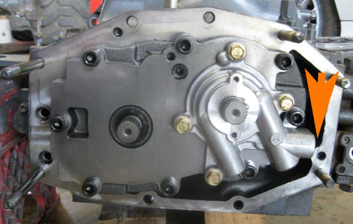

Tractor Trials
The new seal for the clutch housing came in Friday so Saturday I dove in to start on installing it. Quickly found that the old one wouldn't come out until the shaft it rode on was removed, and the manual said the shaft came out the back. But the back was attached to the transmission housing, so that meant separating the clutch housing from the transmission. What it didn't mention was that a hydraulic system feed pipe in the side of the transmission engaged a port in a pump inside the clutch housing (see orange arrow in photo), effectively locking the two together. Unfortunately, the porta-power unit did a very nice job of separating the two anyway, bending the feed pipe in the process. So the new seal is in place, and the clutch housing is back on the transmission, but reassembly is stalled waiting on a new feed pipe. Two steps forward, one step back. Gotta be more careful reaching for big hammers!

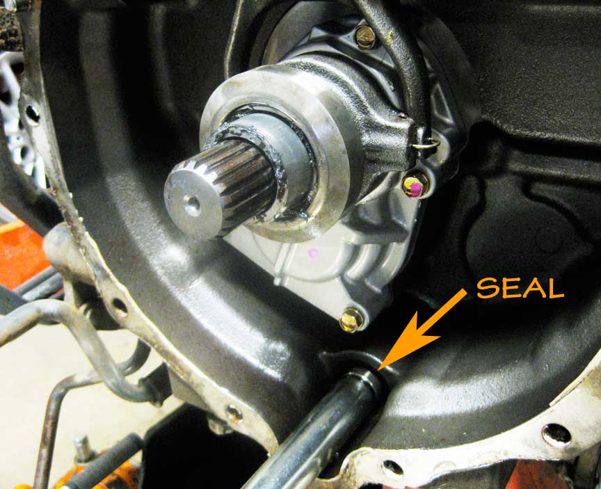

At Last
This is the leaking seal. It prevents transmission oil from migrating up a splined shaft that drives the forward propeller shaft to the front wheel drive. Oil that leaked past this seal flowed to the bottom of the transmission housing and out the drain hole that Kubota put there to let out any water trapped during creek crossings and such.

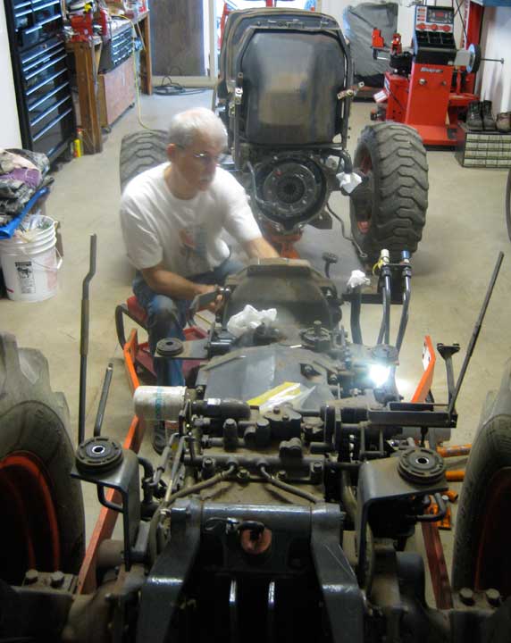

Flying the Floor
Got the floor installed on the tractor today with a little help from Mr. ComeAlong and his RatchetStrap buddies. I hate lifting stuff with a come-along, but it weighed less than a hundred pounds and there was no helper handy. Also got the hydraulic lines re-plumbed, and about half the wiring harness reconnected. Probably a couple more days 'till the thing makes brummm brummm noises, as I'm fixing previous owner secret broken stuff as I find it.

Wow! Thanks, Scot. A picture really is worth a thousand words! Your description has given me a much better idea of what I am up against. I truly appreciate all the info and the pictures.

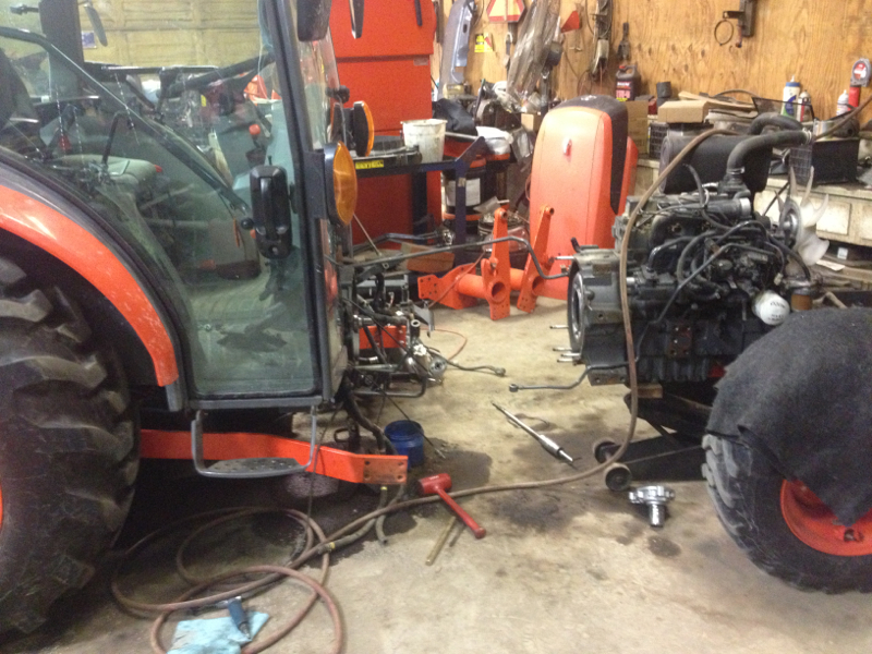

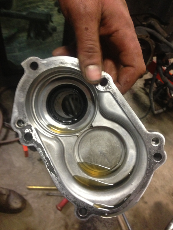

Thanks for taking the time to share this info with the rest of us, it is very helpful. I do have a few questions before I move forward with this repair. I have a leak coming out about half way down the propeller shaft. There are some seals in the shaft itself along with the seals that you replaced. How can I tell for sure which seals are causing the leak? Is it possible the seals in the saft itself are the only ones that need replacing? I just wanted to double check before tearing into it. I have attached a pic of where it is leaking. It's not running down the outside of the shaft and dripping, it's actually coming from the inside of the shaft and dripping out where its coupled together. I also wanted to know if there are any specialty tools needed to replace the seals shown in your posts in this thread? Thanks again for all the help.
