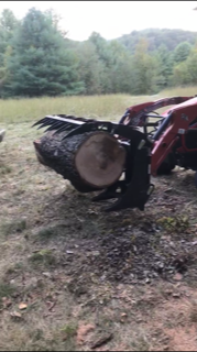

RK55guy, I initially purchased the Granite Grapple with my RK24 & have nothing but good things to report on its use. I, like you, primarily use it for cutting firewood & it has worked perfectly. Hopefully, I can get the image to upload correctly(not the most tech savvy individual here) but the pic shows a 4' section of red oak that's basically 22" in diameter. As I lifted the tree section with the grapple, the RK24 didn't even "grunt." Hope this helps!https://www.tractorbynet.com/forums/asset.php?fid=556478&uid=347838&d=1580438402
