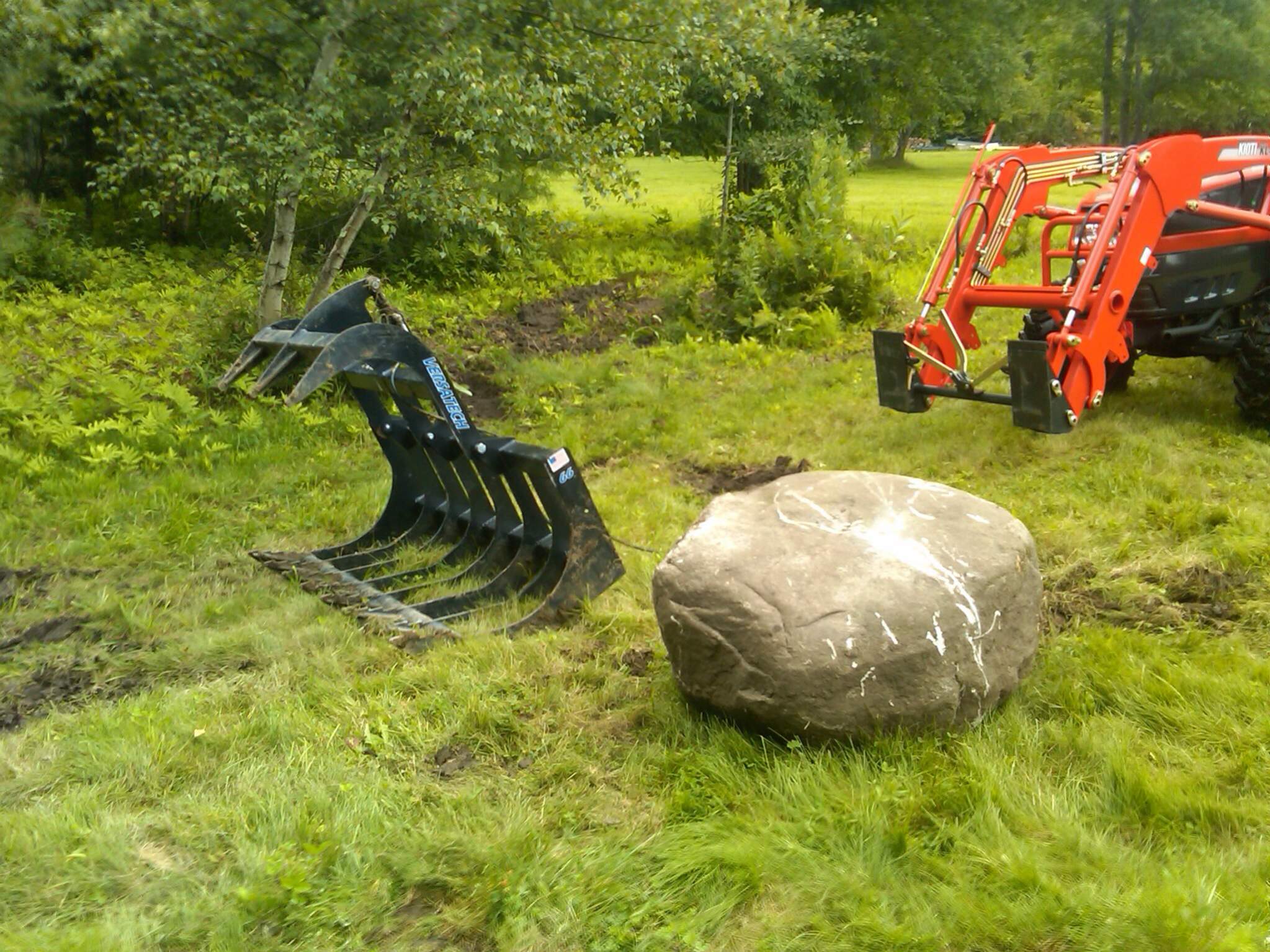

I've got a single, use it much like you state (except I have been known to dig a rock or two out) and have not needed two. Yet.
/ Grapple --- 1 Lid or 2
Wow, that's a huge rock to dig out with a grapple and the grapple looks undamaged. Either a well built grapple or excellent operator skills. Maybe both.:)
/ Grapple --- 1 Lid or 2 #4
Very nice rock indeed. :)

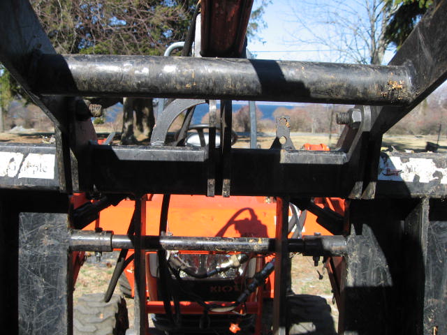

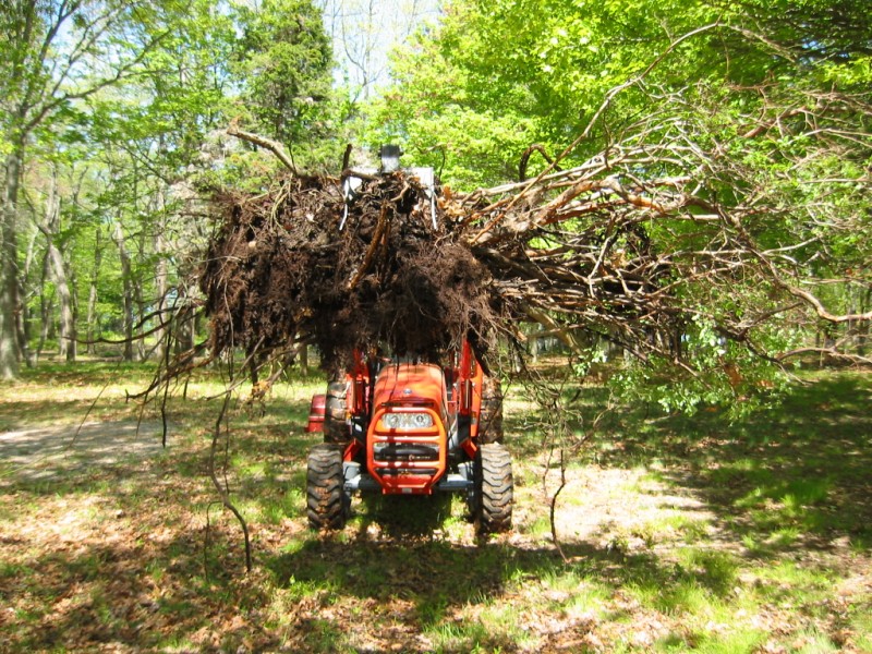

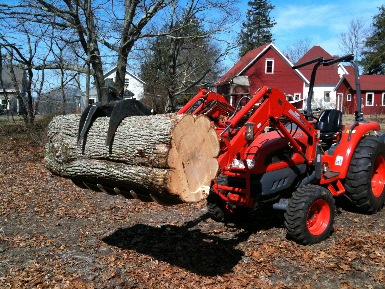

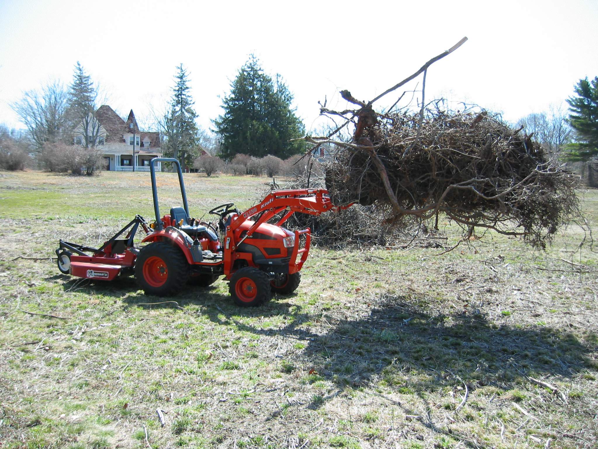

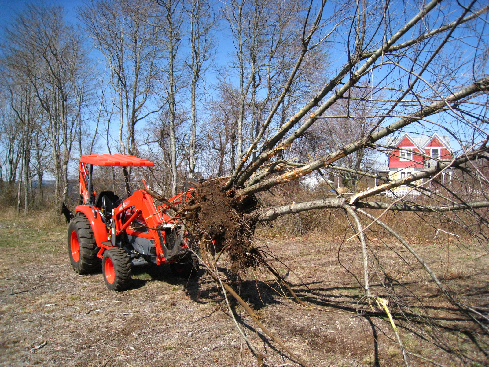

I have used my grapple extensively. Mainly for clearing debris, cleaning up chain sawed trees, digging up trees and moving them, clearing areas of brush and trees up to 6" diameter, etc. I have a strong opinion a narrow one will do all of that great. And one thumb works just fine. It will hold anything I grab easily. Mine is 48" and heavy duty steel, 1/2 " thick. A wider one will also do most everything but dig. If you just need to scoop up debris, a 60" or greater works fine. But if you need to dig up trees, or uproot them, which I do a lot, a narrow one is far superior. My analogy is that if you manually dig up a shrub, you use a pointed shovel, not a wide snow shovel. Same principal. And for grabbing debris, the width doesn't really matter. Limbs and such tend to interlock with each other so it's not necessary to support the whole pile. It still gets picked up.
So if I do any uprooting at all, I would make it 48" wide with heavier steel, one thumb and cylinder. Advantages are that it saves weight over a wider one allowing for more lift capacity and breakout force, more simple, cheaper, and it will out dig a wider one hands down. And to me, it still works just as good as a wider one to scoop up debris. The thumb really doesn't do that much. It just clamps down on limbs as you transport them. For big rocks the thumb does even less. the weight of the rock keeps it in the grapple. A single thumb is plenty to hold it in place. I see no advantage of two thumbs unless you have a grapple 6 feet wide or bigger. But then, you lose the digging ability.
/ Grapple --- 1 Lid or 2 #9

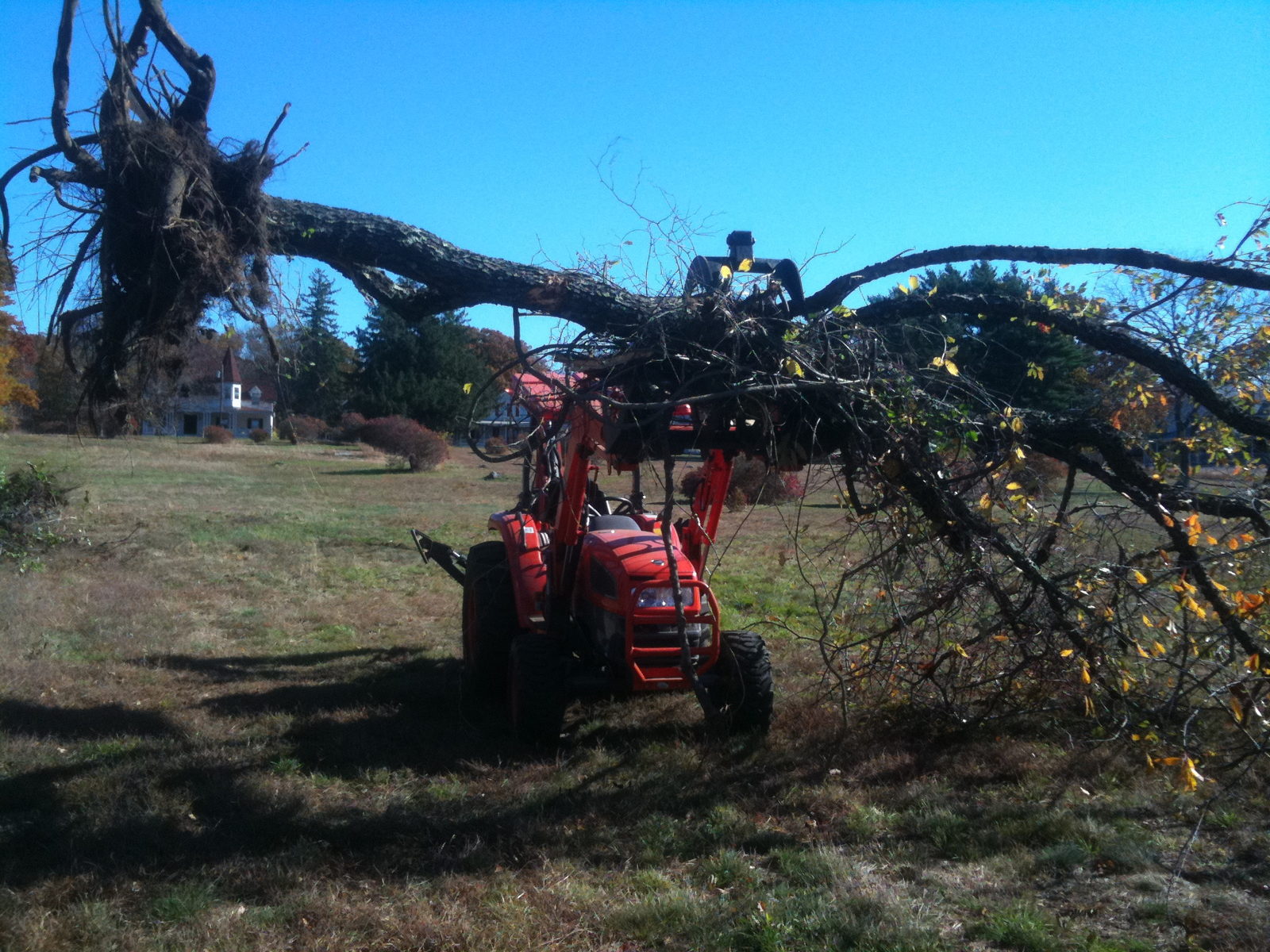

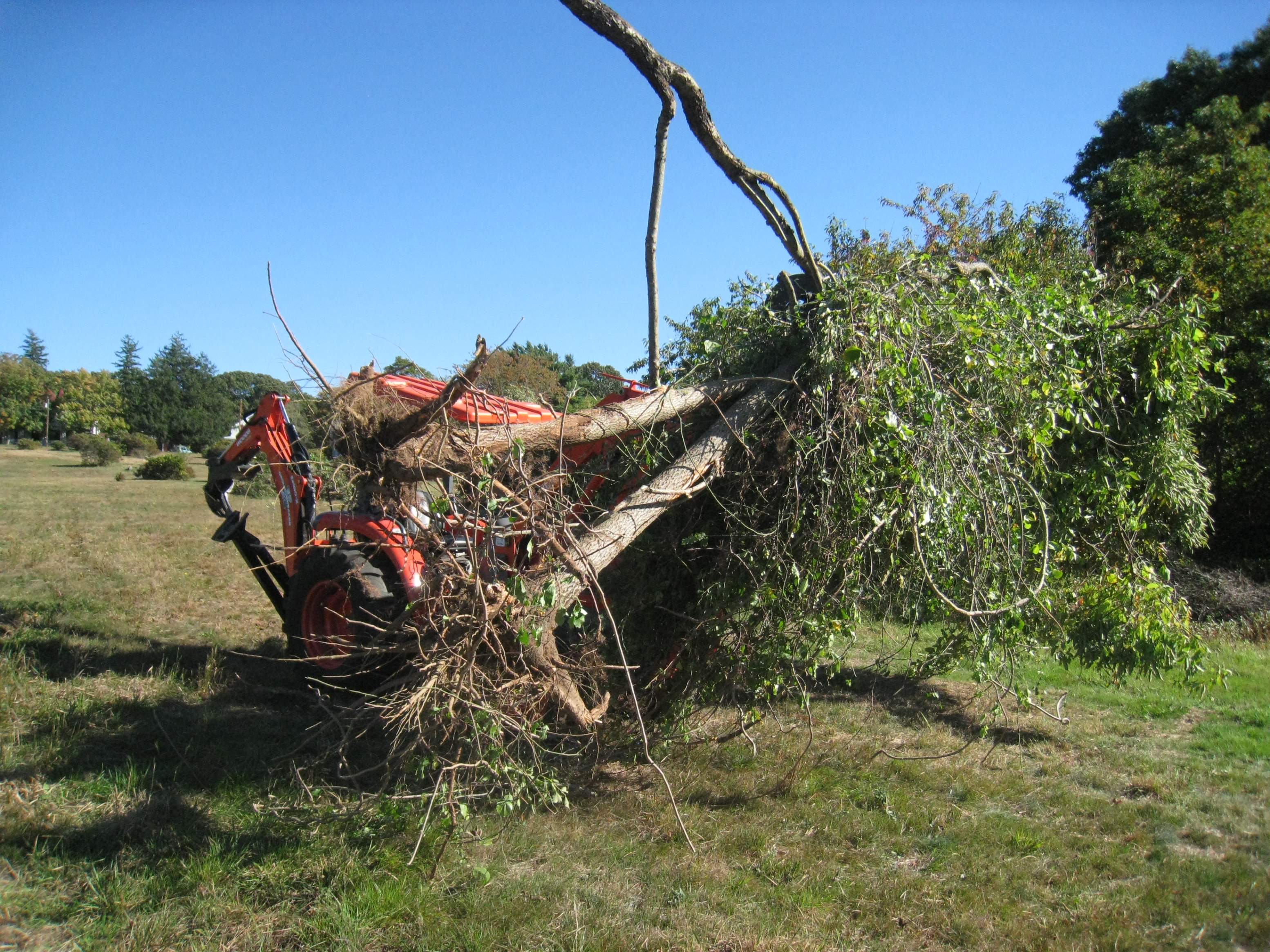

One more comment. Protect your grill and radiator. See my home made grill guard? Whatever design you choose, when moving limbs, one will find its way into your tractor front end. I found out the hard way, twice!
And I think spend more time designing the teeth and cutting angle and less on the hydraulic thumb. It just isn't that important. Any thumb or two will clamp what you pick up. 95% of the work is in the digging, scooping, scraping with the teeth. The final clamping is just an afterthought, and is not critical at all

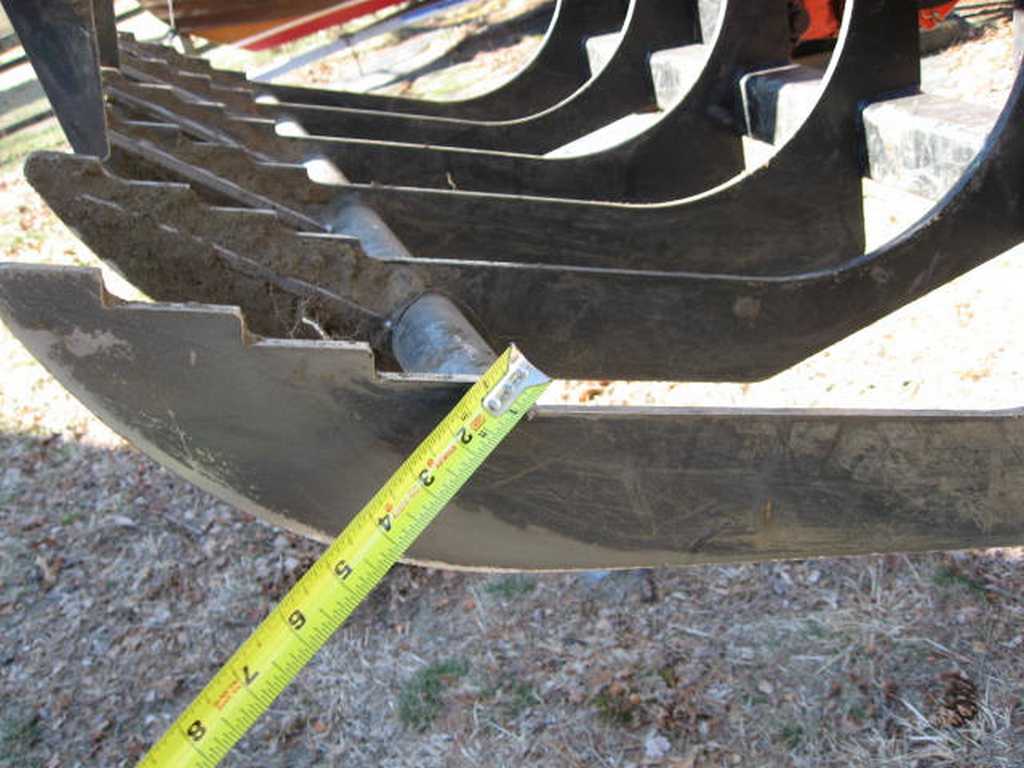

Thanks for the feedback everyone.
HCJtractor;
Your grapple obviously gets a LOT of use and seems to be holding up just fine. One more question if you don't mind. What is the length of your tines, from the end to the front face of the frame?

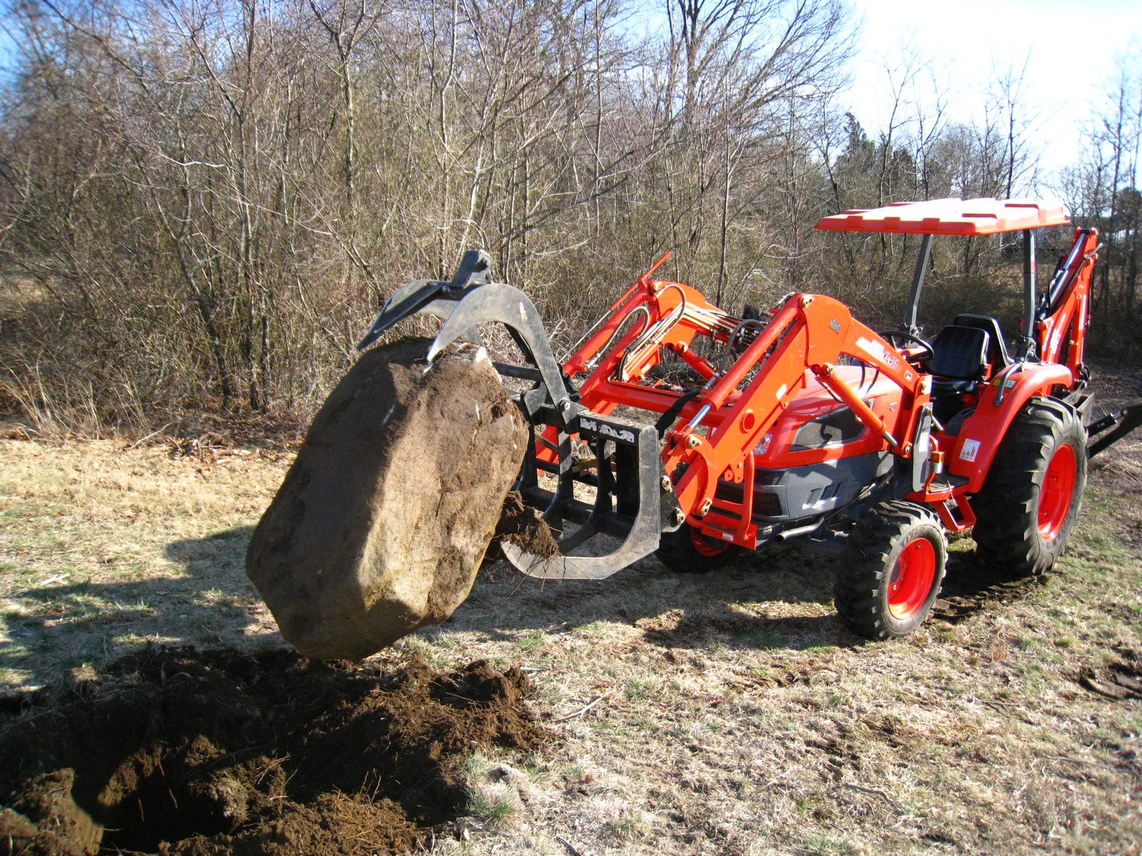

I have a single lid. Never wanted two lids. Just adds cost and weight. Never had any load that I couldn't secure with one lid. In an open bottom grapple, the lid is typically just holding the load from bouncing around. Pulling out rocks is a bit different but is best done with single lid as load will be centered not offset.
I've also pulled big rocks out of the ground with the 48" light duty grapple.

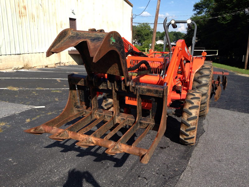

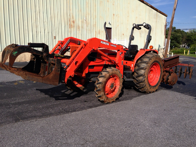

I'll go to my farm this weekend and measure, and take some close ups. This was made by Markham Welders who is now out of business.
/ Grapple --- 1 Lid or 2 #13
I'm glad Island Tractor jumped in. He was my source of info when I was shopping and he always had great advice! I've read most grapple threads here and he knows his grapples!!!
/ Grapple --- 1 Lid or 2 #14
Markham is out of business but I believe the shop is still producing grapples under another business name. Same grapple basically as I recall. Markham was in Denton NC. I know if you google grapple and Denton NC you will get at least two or three manufacturers. Gotta believe they are probably related to the old Markham shop.

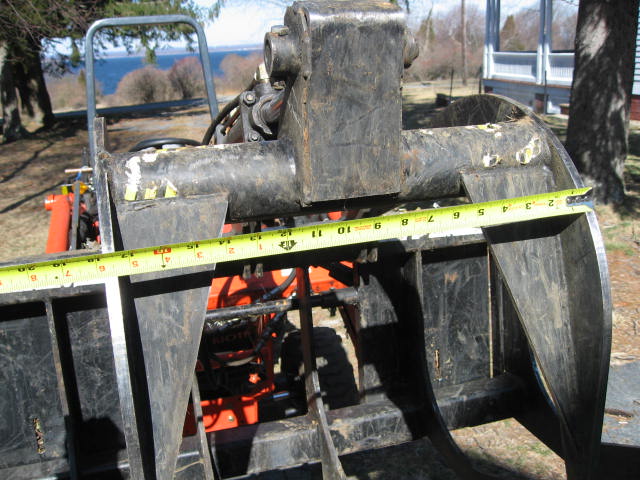

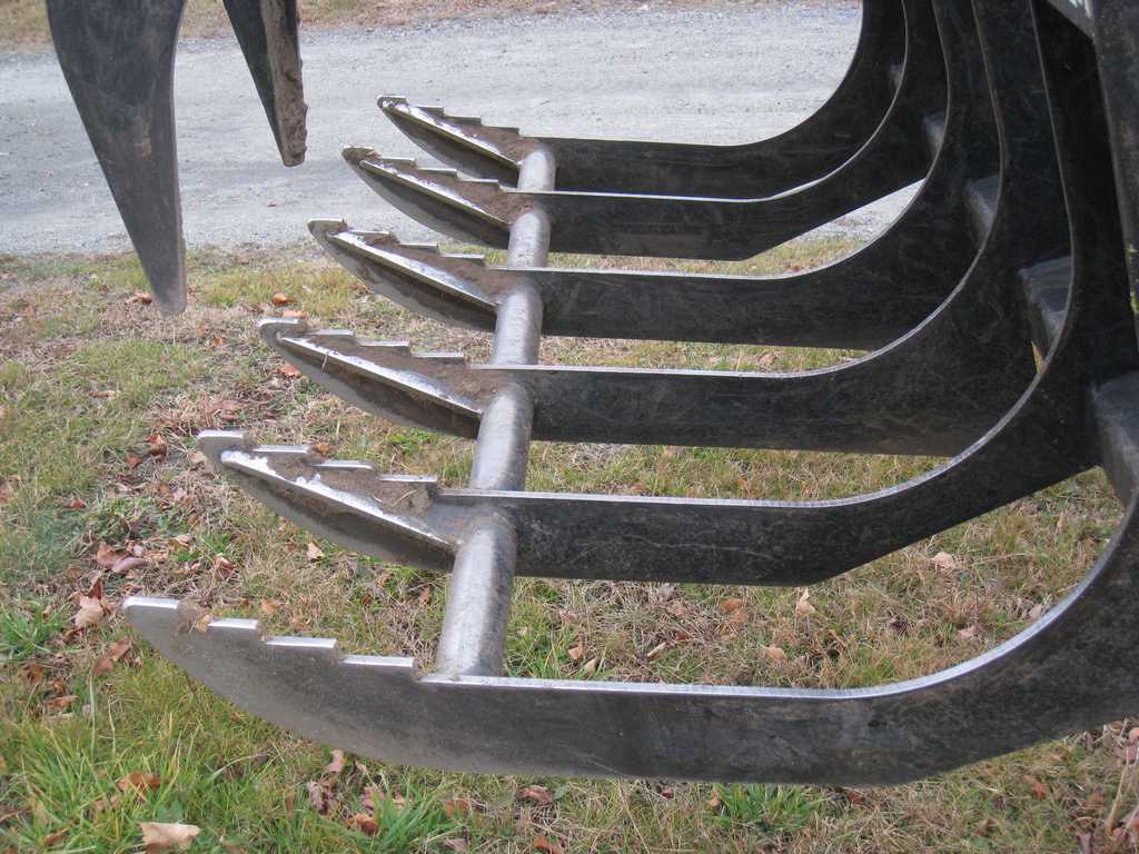

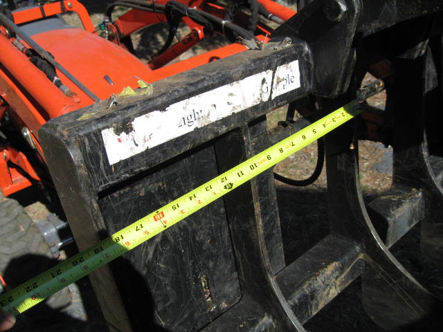

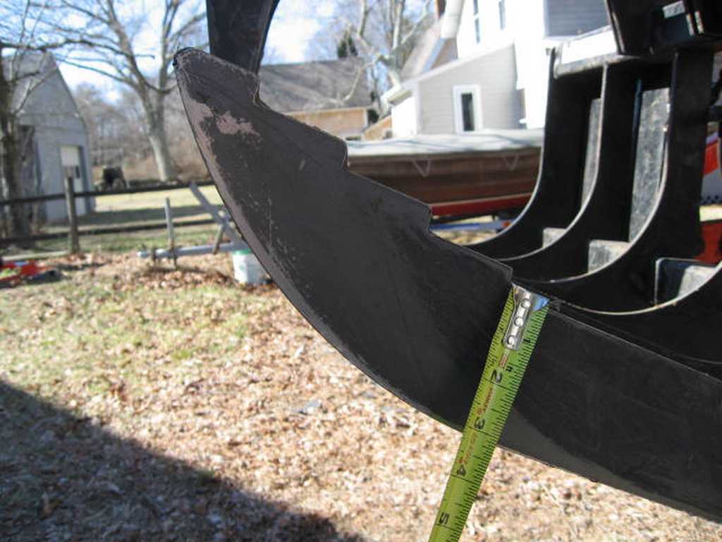

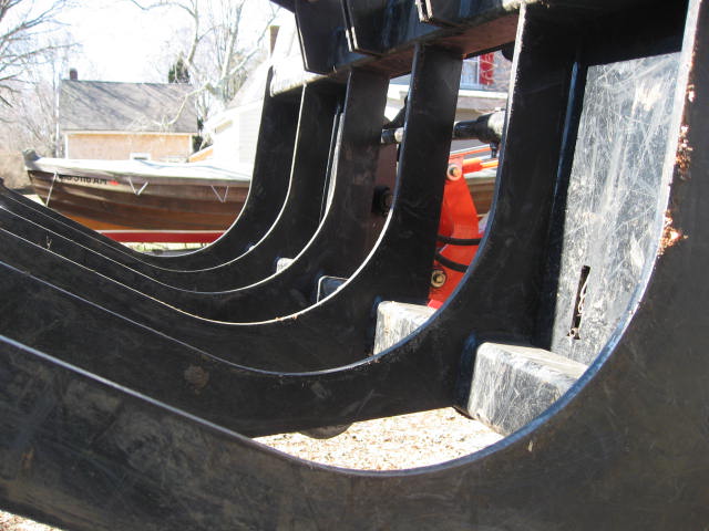

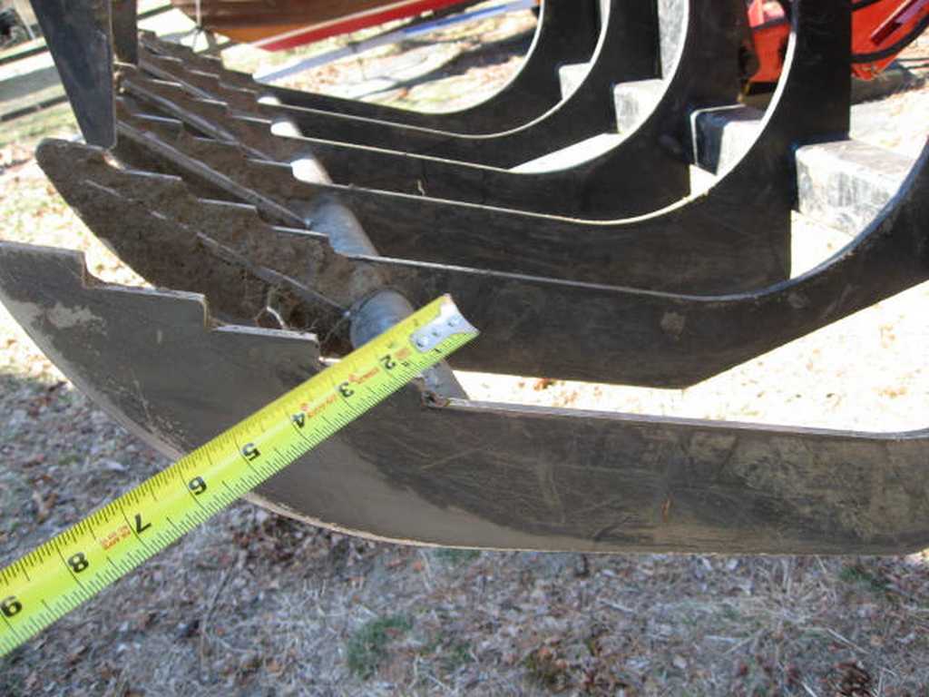

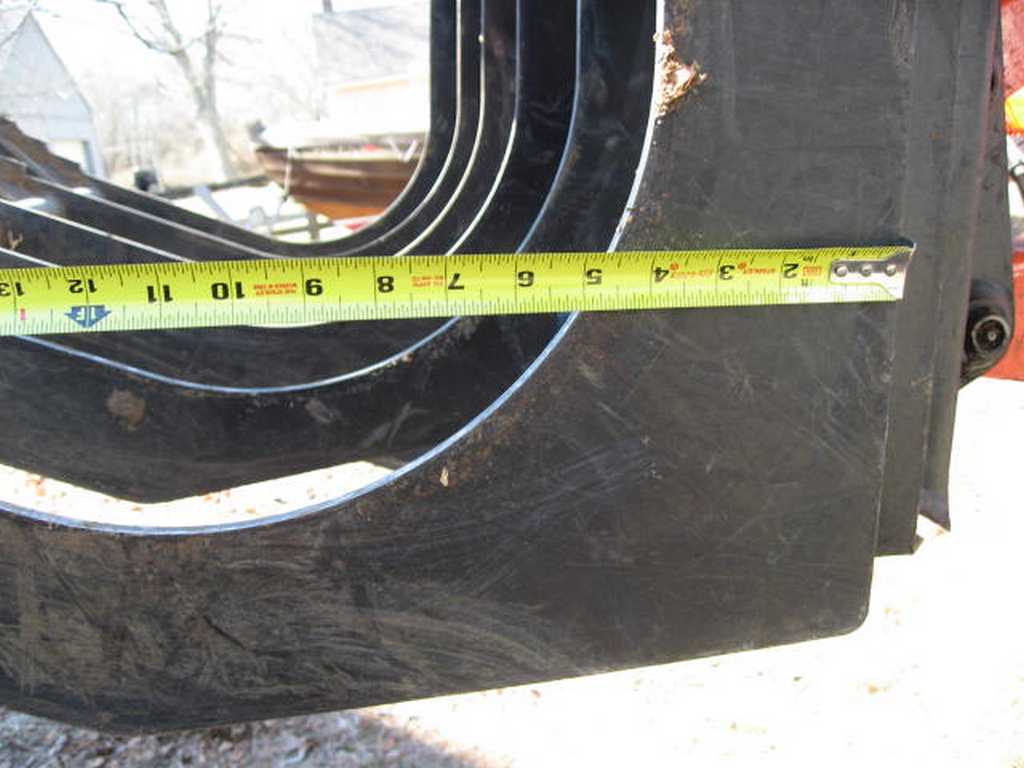

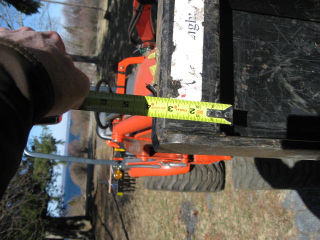

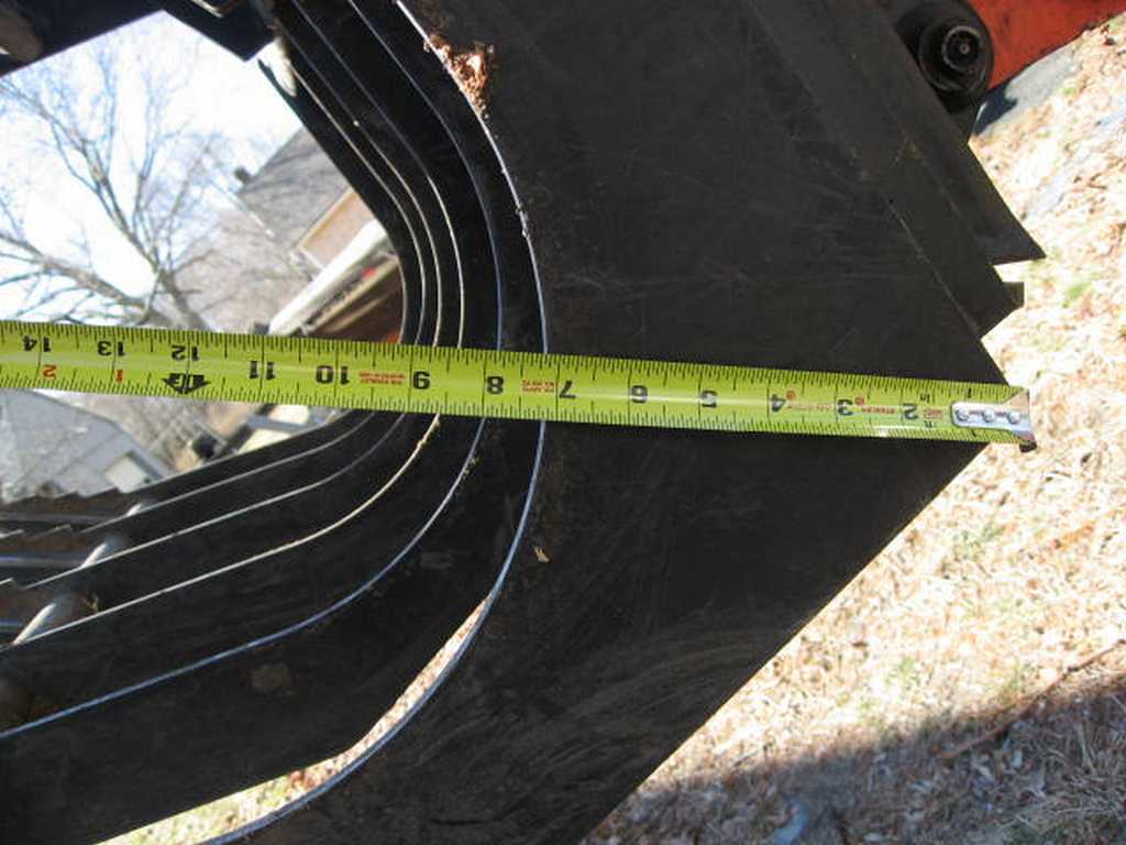

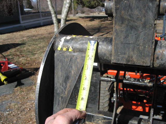

Here are some photos with measuring tape that I took of my grapple sometime back. I do like the slight curvature of the bottom tines. I'd beef up the upper jaw though, especially if you are planning to dig out rocks with it. Mine got a little snaggle toothed so I had to heat, straighten and add gussets. Bottom is fine after 8 years.
I think it looks pretty much like HCJ's Markham grapple. Pretty standard design.
Lack of skill actually, when I got it loose and grabbed it, I ended up getting it jammed oblong in the teeth, and had to cut the grapple loose to go get my counterweight on. Then it was lifting the loose grapple with a chain, to slip the rock out!
Fun day indeed.

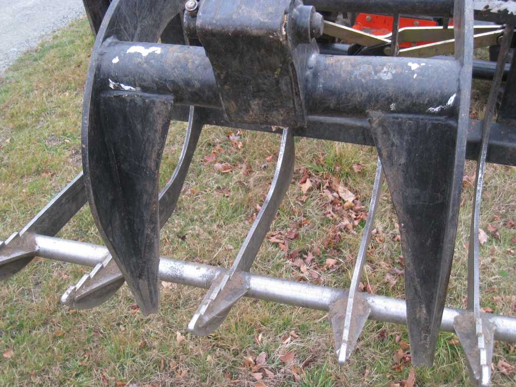

Island Tractors pictures are good and clear. I had Markham add some additional steel in between the tines to close the gaps.
/ Grapple --- 1 Lid or 2 #18
Excellent idea. If the intermediate tines are just below the surface level of the main tines, they could be 1/4" and still do a great job for keeping smaller rocks and sticks from falling through. Easy to add after purchase too.
