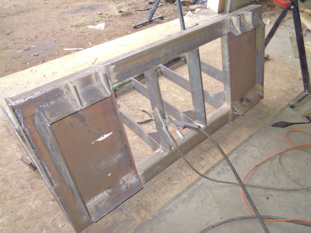

Didn't get much done today but I did get the gussets in. Had other things that needed attention.

Looks really good Hilbilly. If you have not thought of it already I would suggest deciding how to run the hydraulic hoses through the frame before welding on the grapple mounts. This is how the hoses on my grapple are run.

Dirt Ditch, I like the way your hydraulic hoses are run but I think I will do it the simple / easy way for now. It looks like the back of the upper frame has been cut out to gain access to the inside of the cross tube. If I have problems with the hoses in the future, I could still do the same thing.
k0ua, thanks for the compliment.
I'm still learning a lot with this build, plus I'm getting better with OA cutting (lots of practice). Still not good with the stick welder but just love my wire feed. I thought I wrecked it at one point because I couldn't keep a weld going. It would just kind of fizzle and not produce a proper weld. So I was forced to use the stick and man those welds don't look very nice. I did find a rod that was easier to use though. It was the 7014. I eventually realized what was going on with my wire feed and got it going again. For some reason the drive roller tension wasn't tight enough and wasn't feeding wire properly. It's all good now.
Today I tackle the lid and hopefully the mounting brackets. It will take some time though since I need to drill a bunch of big holes in 3/8" material and get the hole locations precise. For that I will need to extend and retract the cylinder and I'm not sure I have the right fittings for it. May have to run into the city (there's most of a day shot).

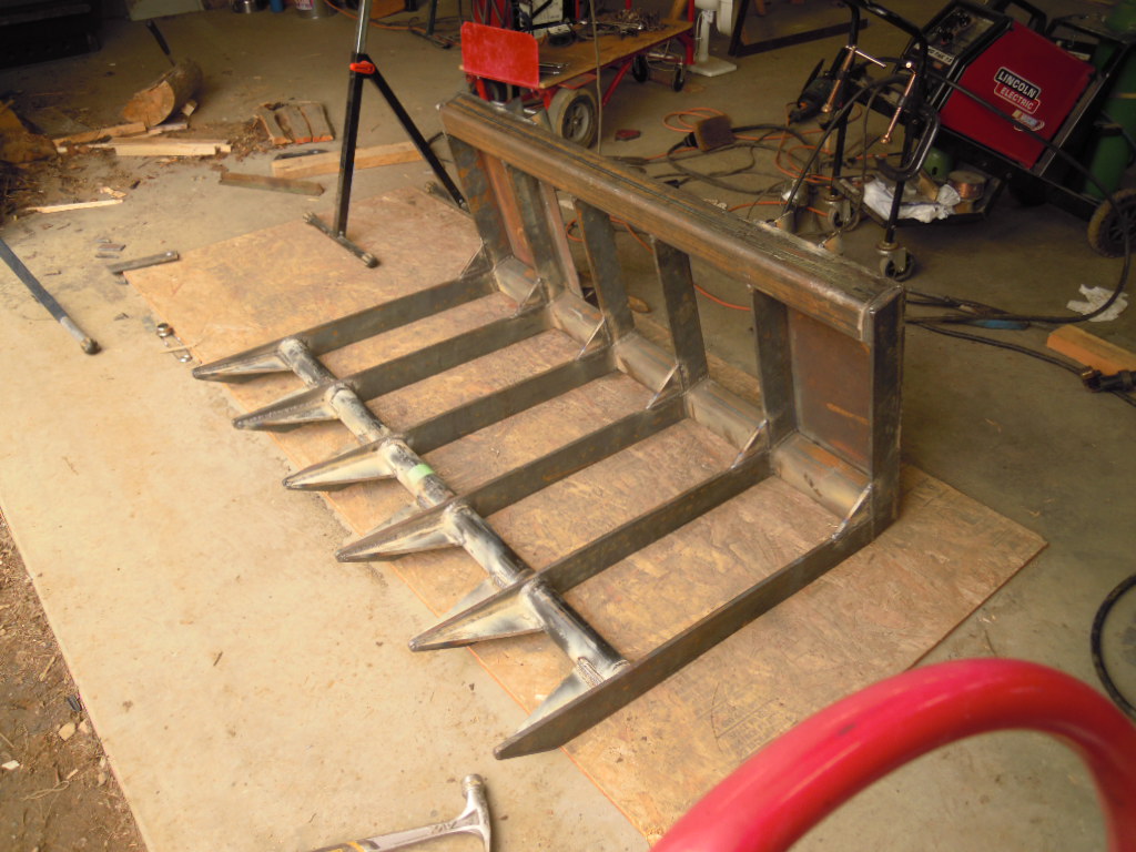

Almost done with the fab work.
