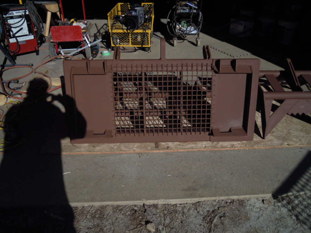

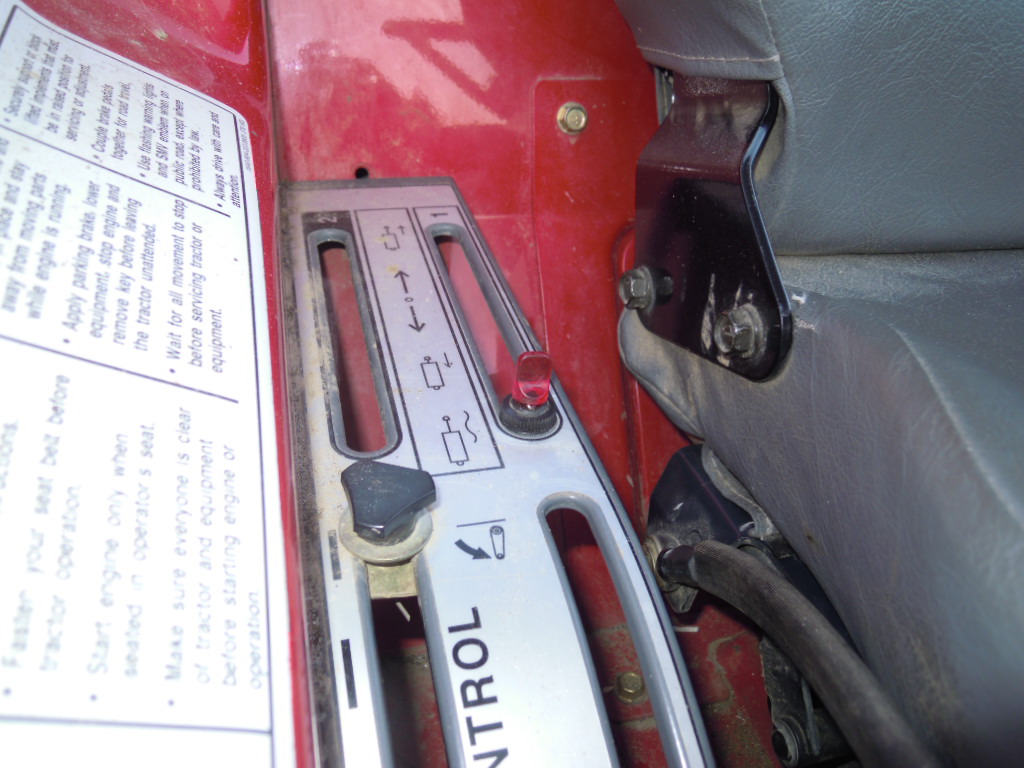

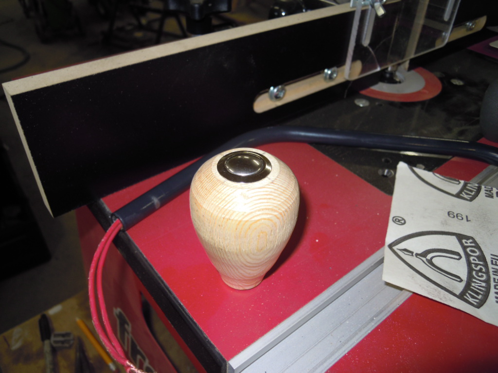

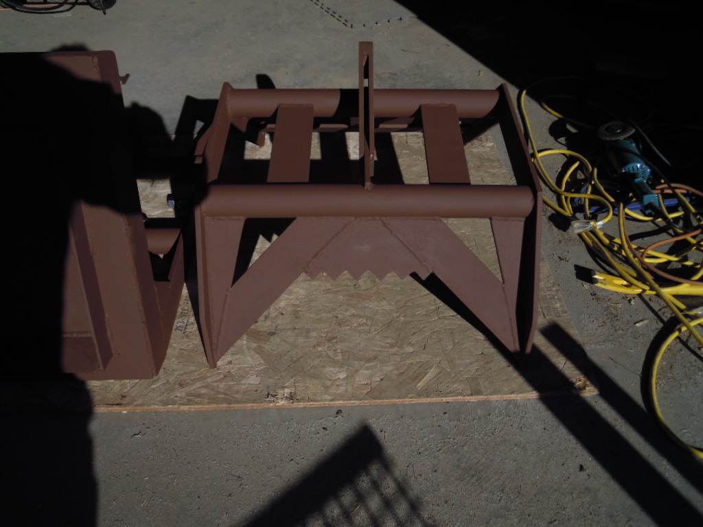

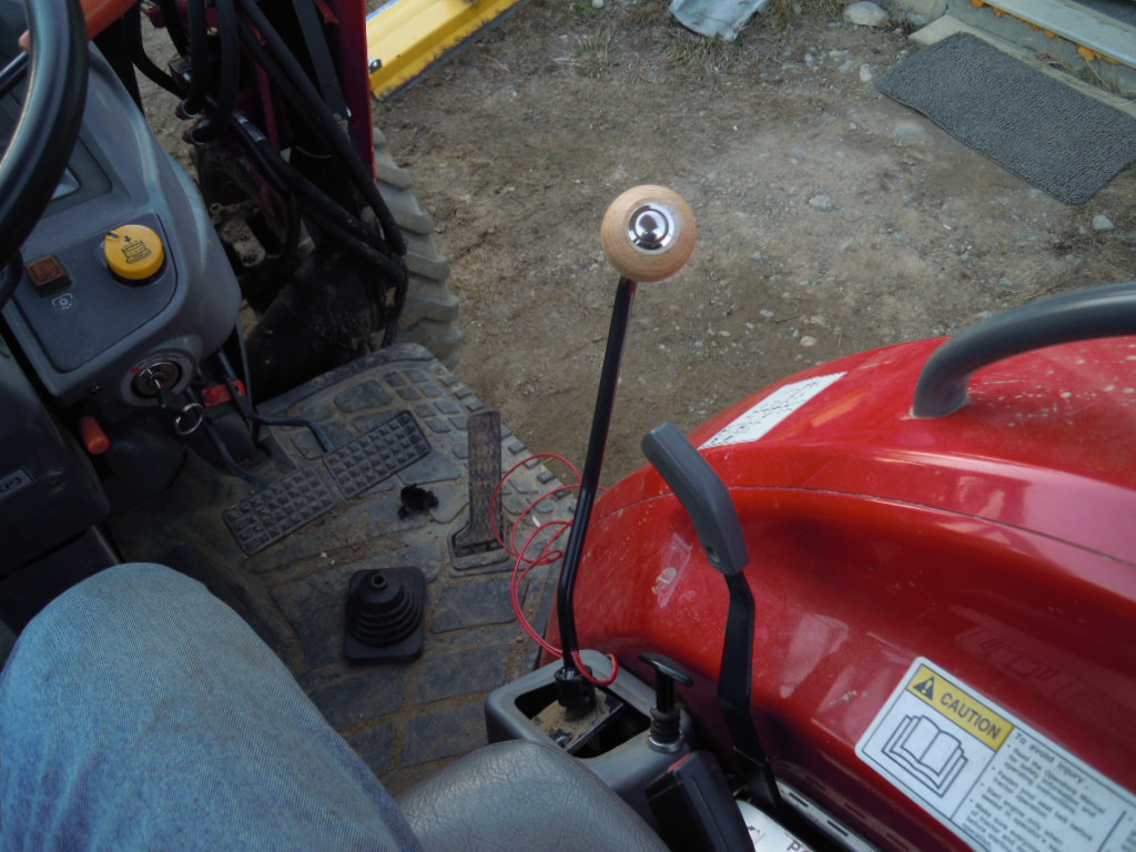

Had to go to the city to get the screen for the back of the grapple but at least it's done. Got the screen on, some teeth added to the lid and the primer done today. Then I figured out what to do with the diverter valve switch. One pic below shows the current (temp) location and the other shows the wooden joystick knob I made on the lathe. I mounted the switch on the end of the knob and the wires run down, inside, of the joystick. This will be much better. I just hope the wooden knob lasts for a while.

Now you will have to name it and market it. "Wicked Grapple" is already taken. How about "Gruesome Grapple"?

Hey I like you switch.. Urethane it well, and stick it on.
Gruesome Grapple?... That isn't half bad.
Great idea! I was trying to figure out how to treat it so it would have a fighting chance. I'll have to use spar varnish though. Regular Urethane doesn't do well outside. Don't ask me how I know.

Sorry, I haven't read every page in this thread, it's become quite large. But to the OP, if you still have the original question in mind: I built a grapple to go on the bucket of my L3301. Just a single lid. I'm still trying to find time to do a write-up on it (and several others). Its not pretty by any means, but its very strong. Stronger than I thought actually. The other day I needed to move a propane tank. I'm not sure exactly how big or how many gallons, I would guess nearly as long as the tractor. Definitely longer than the bucket is wide. Probably wasn't the best thing to do, but I scooped the bucket under one end and clamped the grapple down onto it and lifted it up and away I went. I was able to drive across my 10 acres, bumps, ruts and all with little issue. I have often wondered if I would like a double lid grapple. But I don't think that would have worked here. The seam between them would have been right where the tank was, putting quite a bit of sideways stress on both lids.
This applies allot of the time with larger stumps and whatnot. But then there are other times that I scoop things, such as uneven loads of large rocks or something, that I wish I had 2 lids to hold the load in better. In a perfect world you would have both. Personally I think There are always going to be instances where the one that you don't have would seem to do the task at hand a little bit better, no matter which one you go with. But all-in-all, I'm quite happy with the single lid that I build.
