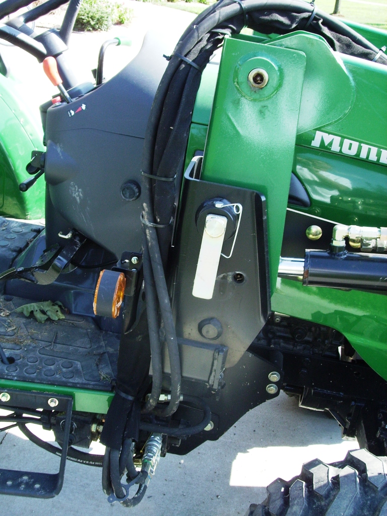

I have enclosed a couple pictures of my tatro grapple attatchment. I added a 2.5x2.5x1/4 tube on the bucket to attatch the grapple to. I also ran hydraulic Hoses from the back quick couples that are already on My Montana R3644. This this really works well.

To answer a couple of questions about my Wiko setup---
Skipro3, I could have used my top & tilt remote for the grapple, but the choice was between having to use both hands to operate the loader and grapple simultaneously, or being able to steer and move forward but only operate the bucket tilt or grapple alternately. I operate the diverter via a thumb operated pushbutton on the loader stick and I prefer this method, but it took a little while for it to become a natural motion.
Brahmus, I haven't noticed a visibility problem with the grapple removed, but the grapple itself is a little annoying when I am doing a lot dirt work. A lot of what I do requires both working dirt and using the grapple so I don't take it off very often. It is easy to remove (1 long pin, two quick disconnects, and the occasional bungee for hoses) and the side bucket mounting frame is very sturdy.
