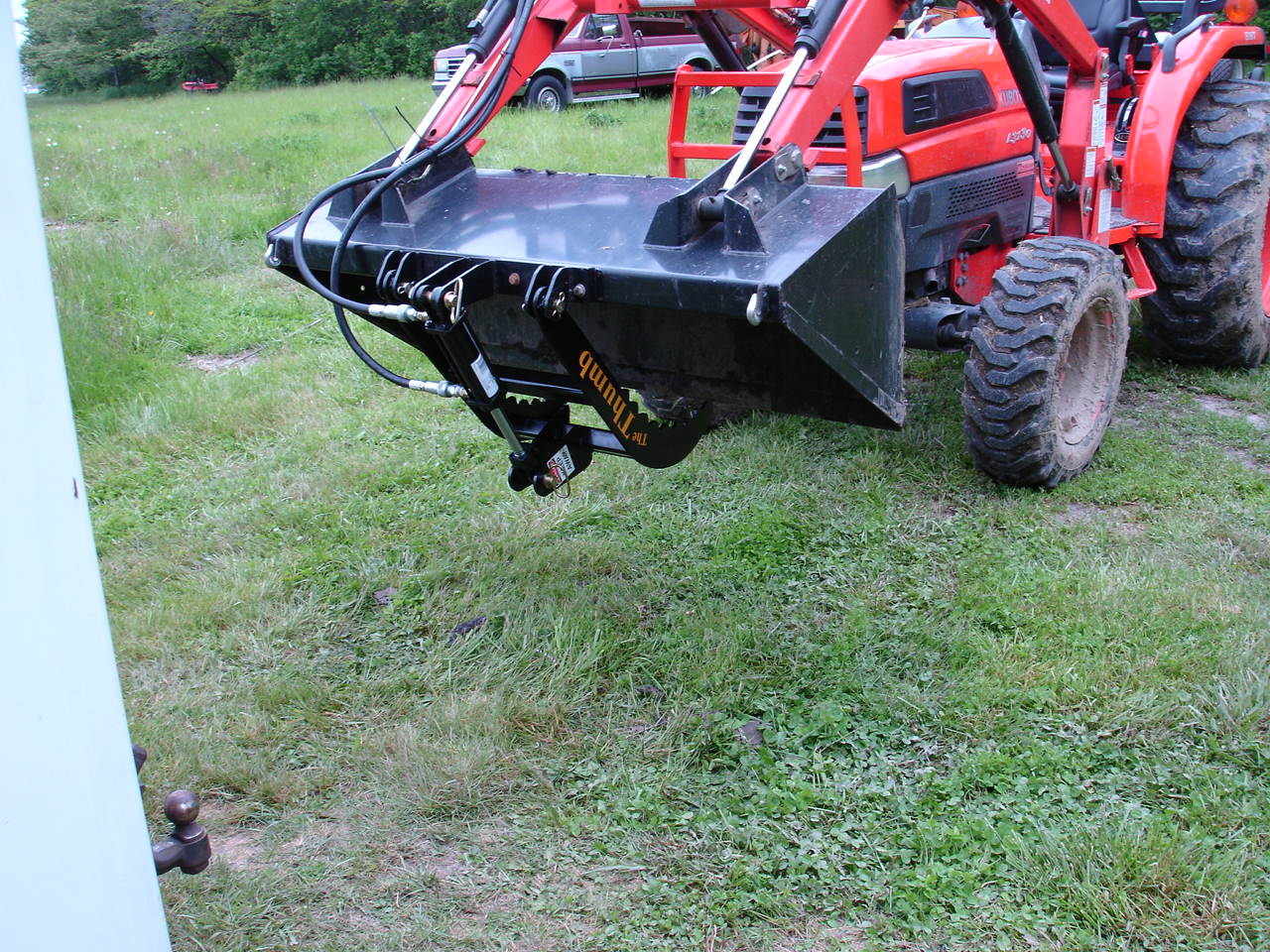

Bill the photo looks like you're in the process of installing it. How has the grapple worked out for you? I have a few trees to move and some brush work to do. Right now I'm waiting till I can justify a millonzi grapple, but those look pretty nice. (and inexpensive).
Wedge
I looked a long time, this one was little more than some around 350.00. Also it was close to me and was fun talking to John, 3rd or fourth generation owner in same shop. Green welding does a nice job and much heavier than all I looked at. The grapple is like a hand, one of the tools you wonder how you did with out.

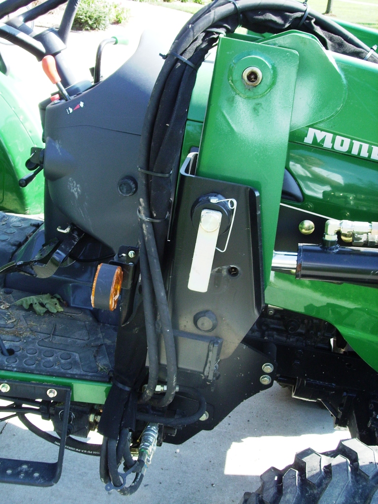

If you have a top n tilt then you have everything other than the longer hoses you'd need to operate a grapple with the rear remote. I used that set up for a couple of years with a grapple and found it perfectly efficient. No problem at all with longer hoses, you just need to route them and secure them so they don't get damaged by brush etc as they must pass below the operator's platform. You'll need to measure carefully (I used an old garden hose) to figure out exactly the length you want. The only caution I would make is to be sure that you can naturally reach for the remote lever. Same as learning to naturally reach for the 4 on the floor shifter in a car without looking for it. It has to be in a fairly natural place so you can drop your hand from the FEL joystick to operate the remote without needing to take your eyes off the grapple/bucket. At first it does require some looking but so long as the remote is conveniently placed it won't take long before it is as natural as shifting gears on a car.

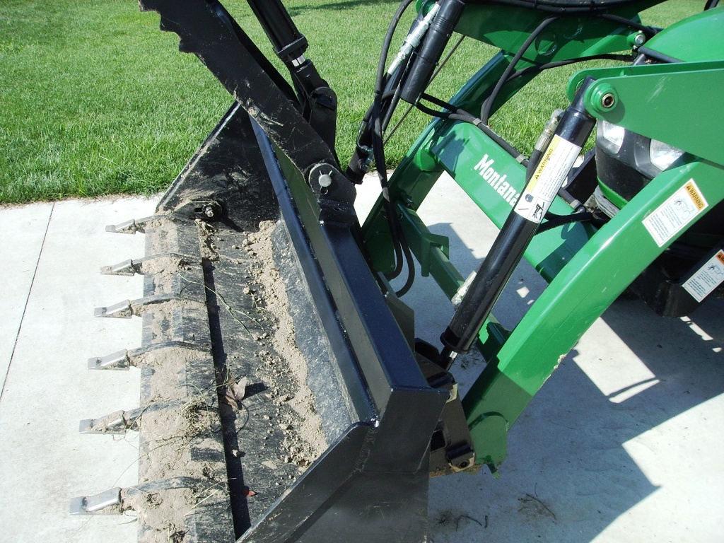

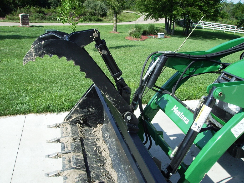

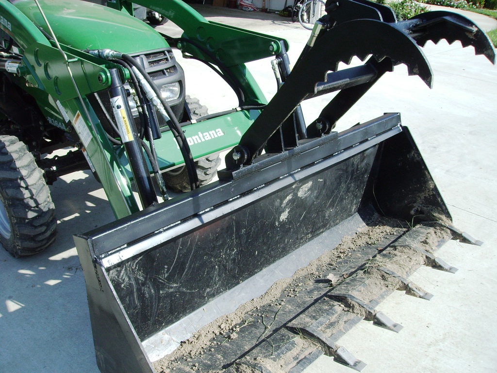

I just added one of andy tatro's grapples to My montana 3644 and used the the existing rear hydraulic connections with hydraulic hoses under the tractor to the front. Worked great and you don't have to fool with tapping the hydraulics as the extra remotes are already there. Also the lever to operate the grapple is built in to the tractor platform so it is very natural to use. I put one on about two weeks ago and the things just work great for moving downed trees. You don't have to cut much up as you can grab a whole tree and move it ( if its a relatively small tree <10" in diameter).
Just be aware that if you use the bolt on style, that the top of the bucket isn't heavy enough to take the grapple and you will need some reinforcement. I welded a 2.5X2.5x1/4 tube on the top of my entire bucket and mounted the grapple to it. Works great.

God to meet you Jerry. I'd say the two are almost identical. I did get the standard 26.5" model from tatro. The tatro is $430 with shipping, but comes un painted. If I had it to do over again, I would spend some extra to get the Powder coated Model (i E the thumb) . The painting with preparation and multiple spray cans is well worth more than $20, and the powder coat is a much better coating. I actually didn't find the thumb until I had mine already ordered. I also have a teeth bar on my bucket and it matches pretty good end of grapple to end of tooth bar. If i had to choose, i would get the 28". The grapple arms are 3/8" steel. I think the width is 26". The cylinder is a 2X6, and the hoses i had made up are all 3/8" with quick connects at the rear, and at the edge of the loader. I had each of the hoses made in two pieces, so i could quick disconnect the grapple on the bucket and the cylinder and leave the hoses connected to the tractor underneath. Make sure and get 90 degree fittings for the cylider hoses. The total cost for all the hoses and quick connects were about $140. I had my local tractor dealer make them up for me. He has all the fittings and hose and had them pre-maid becuase he sells montana's and checked the length. Use plenty of Plastic Zip ties to connect the hose to your tractor and loader, it makes for a slick set up.
The grapple is absolutley wonderfull what you can do with it on your tractor. the only limitation usually is the lifting of your back tires. Mine are loaded and I always keep my 6 foor box blade on to have more ballast. it still get a little light, so you just have go alittle slower. I will get some pictures on hear later of my installation on my 3644.
