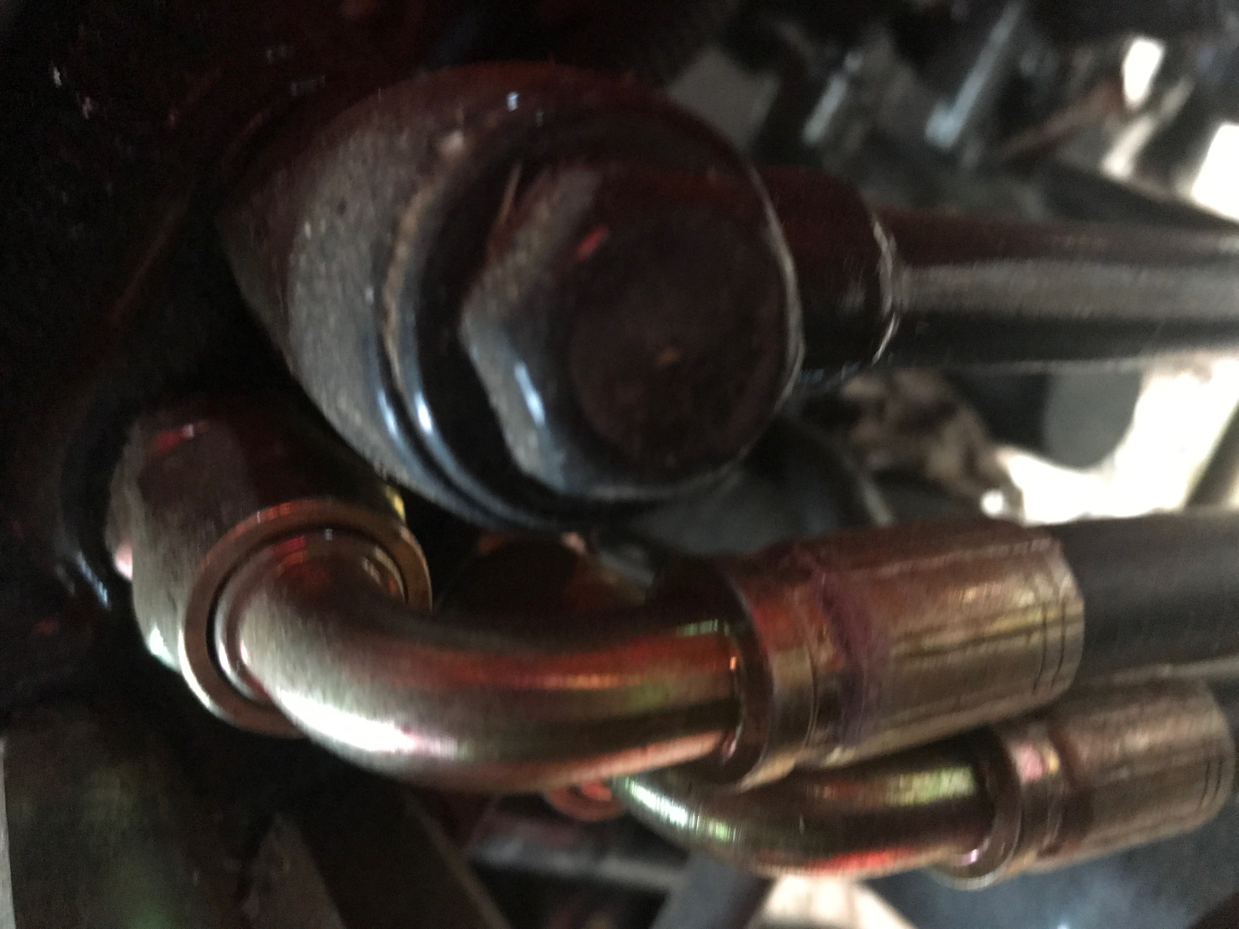

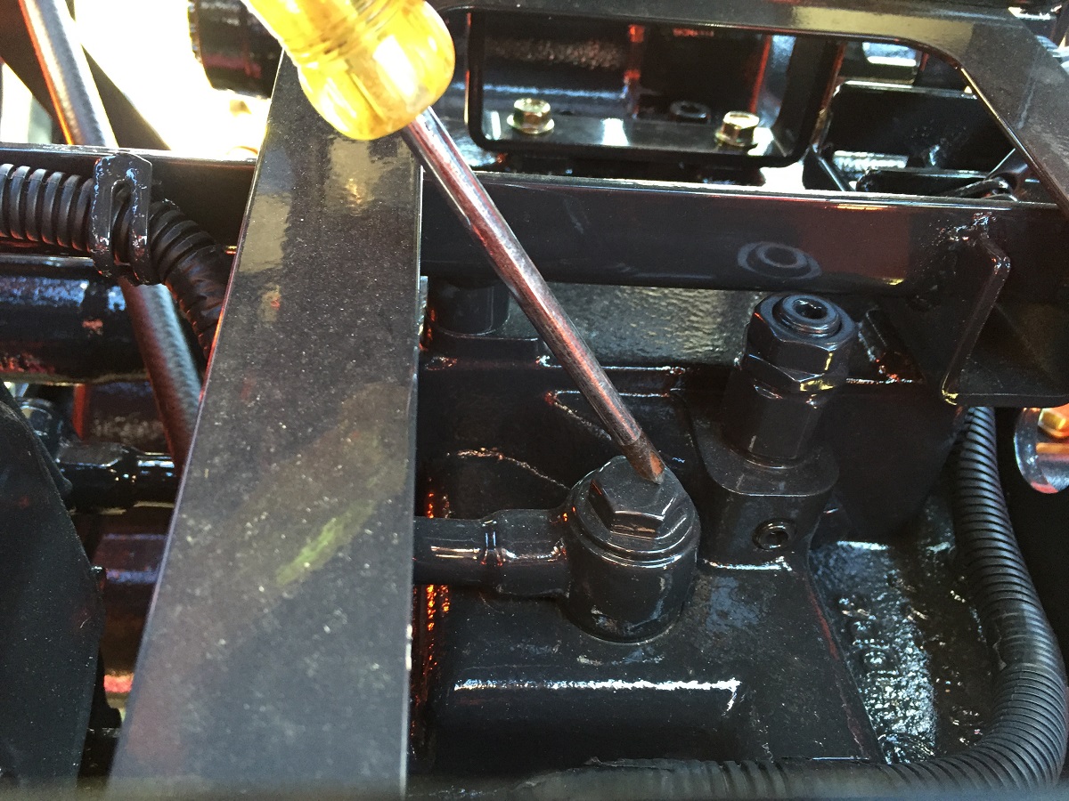

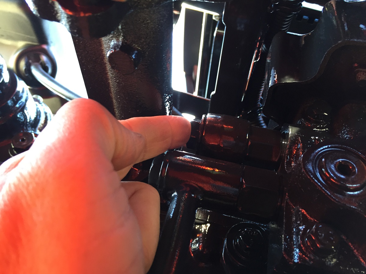

According to W R Long my tie in point (Forget the term so help me out) is under my seat in near the FEL operation lever itself. It a metal line. Even though the Third function valve mounts right next to my other four function hoses that where I tie things together. They didn't seem willing to provide me with a set of those instructions.That would have helped for sure. But they looked at them for me and spoke to me about them. They are rather dealer centered.
He said its one of the easier straight forward kits to install.
At this point it appears I am at a cross roads as to it appears important to chose the grapple in order to have the kit be compatible with that grapple though. My my... what to do.
