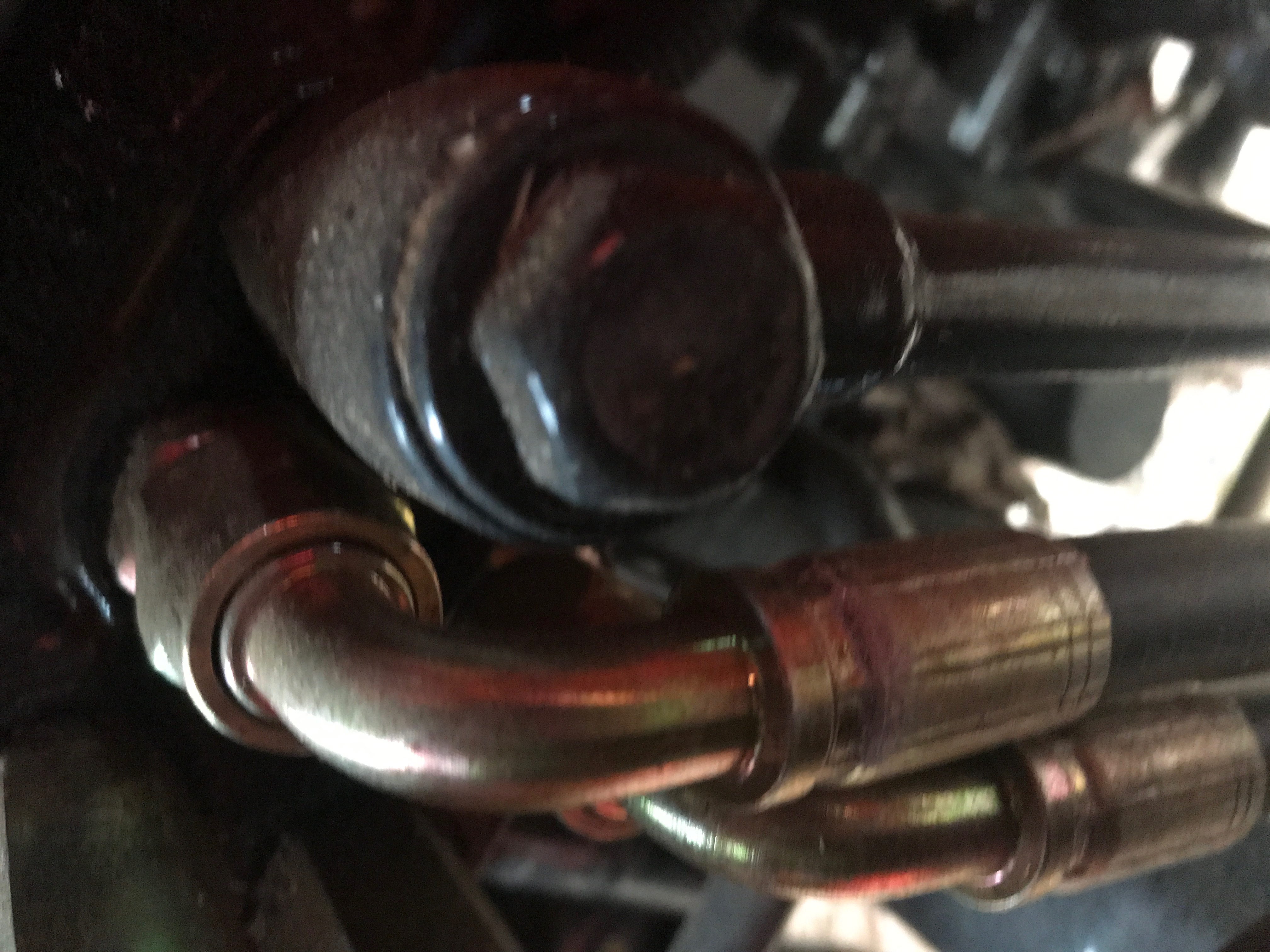

Is this perhaps the Power beyond port , the black banjo bolt looking thing on the right. This valve is located just below the FEL joystick. Its the only hard pipe I see coming from this valve in this general area that Josh seemed to be describing.
I don't know what exactly I do with this info once I find out. I expect I remove this end and tap into it but don't know where the other end goes or what I do next. Replace it with flexible in the kit? Reuse it somewhere? I suspect the later but its all sort of unknown.
Once I know if Im on the right track I will follow that line out and see where it attaches and ponder that bit of info. Ill slowly get a metal picture I think.

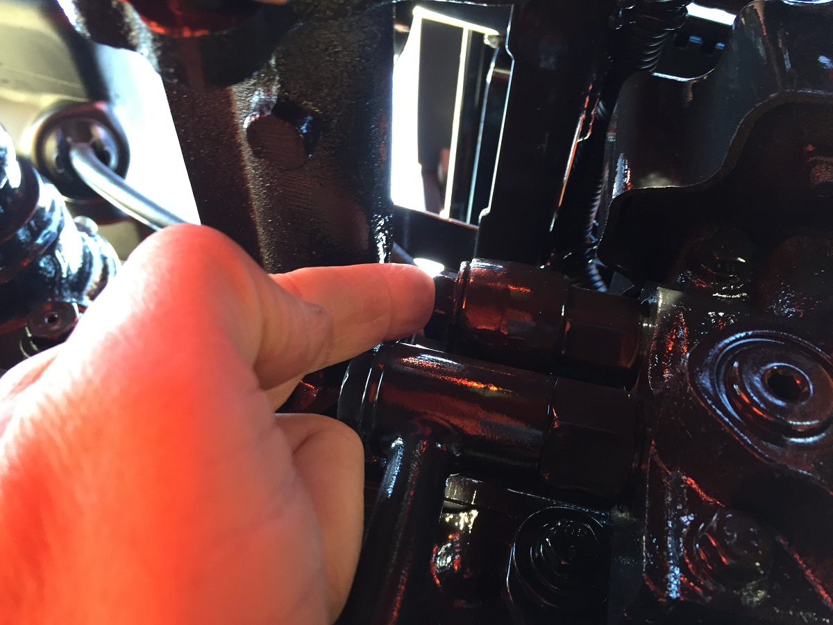

In this pic, the finger is pointing to the PB port on the loader valve.

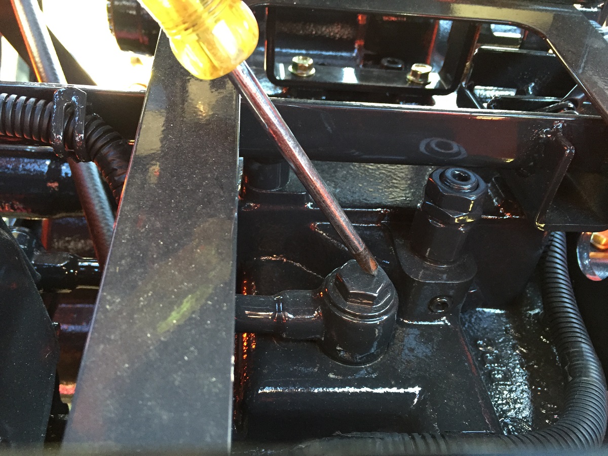

In this pic, the screwdriver is pointing to the PB port under the seat.
The kit comes with adapters to convert both banjo to JIC fittings. You'll replace the steel line with hoses provided.
The other end of the hose you install to the port on the loader valve plugs into the P port on the WR Long valve.
The other end of the hose you install to the port under your seat will connect to the T port on the WR Long valve.

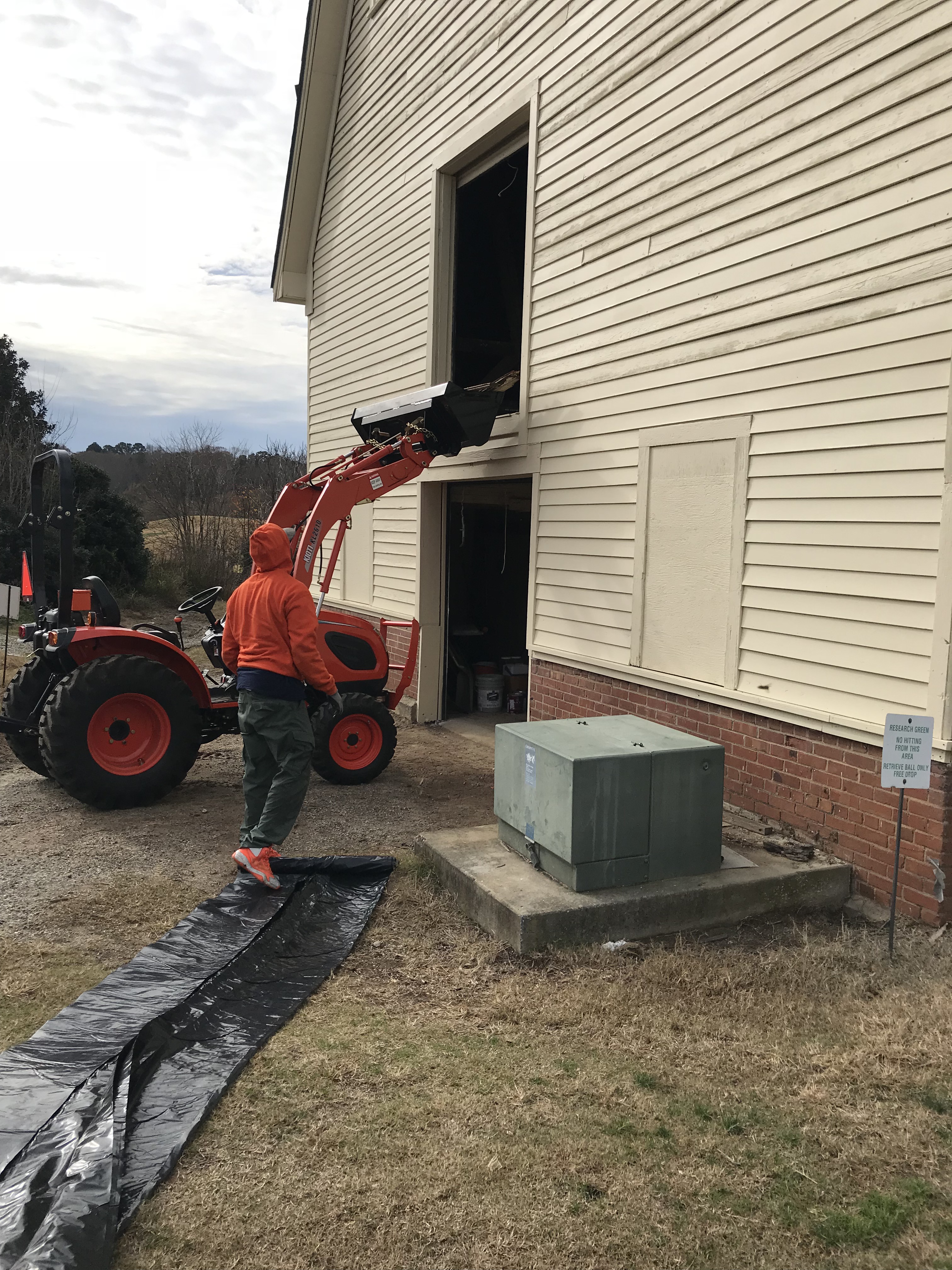

Here is something might interest you. My Kioti on a job site today. This is the old "Yellow Barn" at Clemson University. We are extracting old boards with Lead Based paint on them from the Hay loft. I used my tractor to lower them down to be drummed up.
