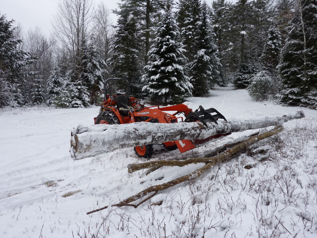

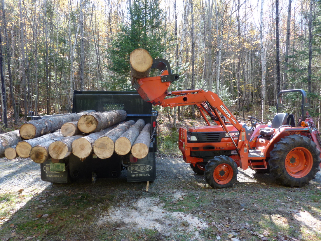

I am not exactly sure what you mean by grapple bucket but this is what I have and it works fine holding logs. ATI bolt on grapple on 5' heavy duty bucket.

Al, as I am sure you know the lift capability of the loader decreases with height. I have the LA482 loader which isn't the strongest one in the world. At max height it is spec'ed at 1060 lbs at the bucket mid point and 1225 lbs at the pivot pins. I always role the bucket all the way back as I pick a big log (as in the pic) to get the weight as far back as possible. I figure after I subtract the bucket and grapple weight I can lift a 700 lb log that way. To put it perspective if your talking 10' logs thats about a 20" pine, 18" fir, or 14" hard maple.
So to answer your question, yea there are logs I can't lift. :D
That was true even before I had the grapple and used chains and hung them behind the pivot points if they were big.
Edit: If you look a the winter picture in post 3 that is a maple. I could grab and hold it with the grapple but that is as high as I could pick it up. It was about 18" at the stump.

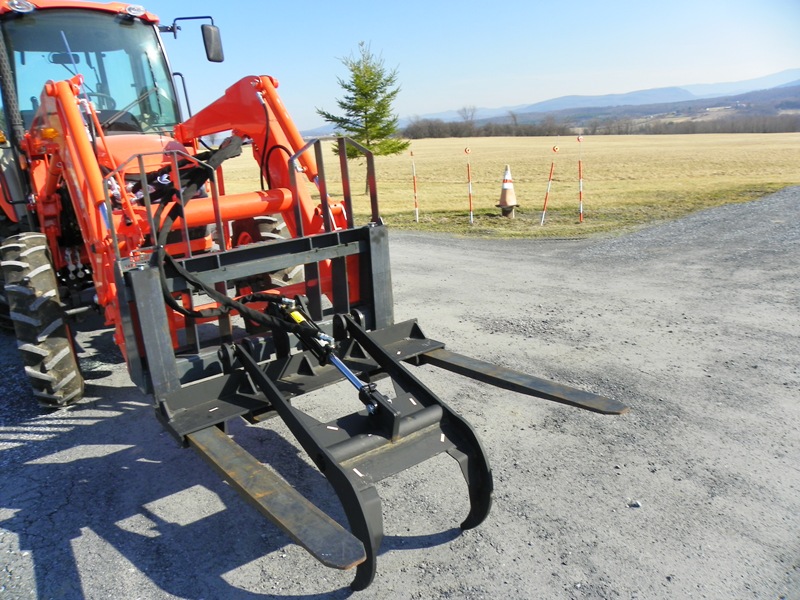

I put the web-site on here above for the Pallet Forks Grapple. Here are some photos of it on my Kubota M7040.
/ Grapple Bucket for cutting logs #19
Dave- I saw that one when I was thinking grapple. I ended up buying a bolt on grapple (The Thumb) and building the slide for my forks. I can move logs, brush, and hold the logs so I can cut to length. Second handiest thing I ever put on the loader tractor. Handiest was the fork attachment I built. Third would be the snowpusher. Tree puller is nice, too. Don't use the bucket more than once or twice a year now.

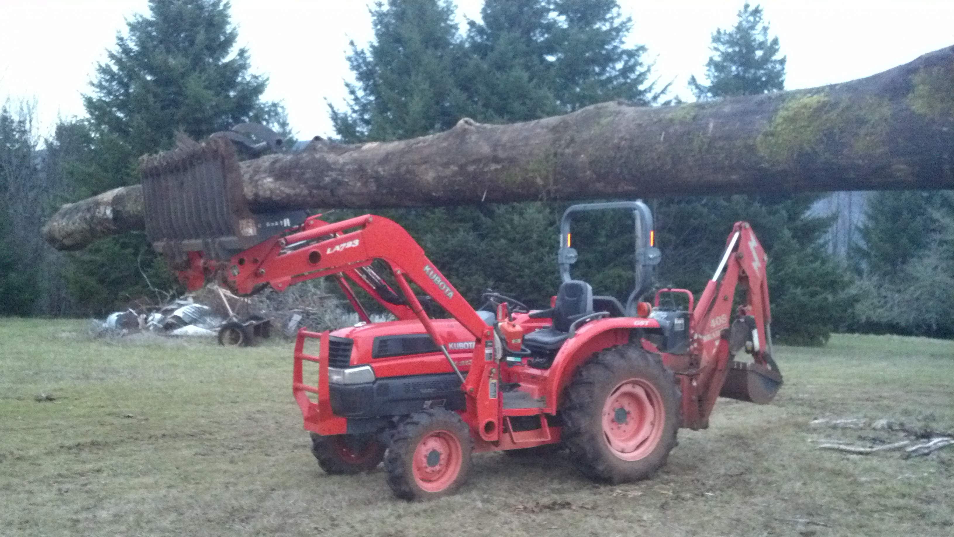

Have ATI grapples on regular bucket, Bradco grapple bucket and thumb on backhoe of the L3130. For large logs holding them in the grapple bucket is ok, but having to regrip thew logs and worry about hitting the loader with the saw too time consuming. What I like to do is to lay 2 logs out and stack all the other logs on them and most times can cut several logs at once as I have a large saw with alot of power (039 Sthil). If I am stocking the wood shed I will have the pile close and just scoop with the BX to move. If it is farther, will stack the wood in the RTV.
