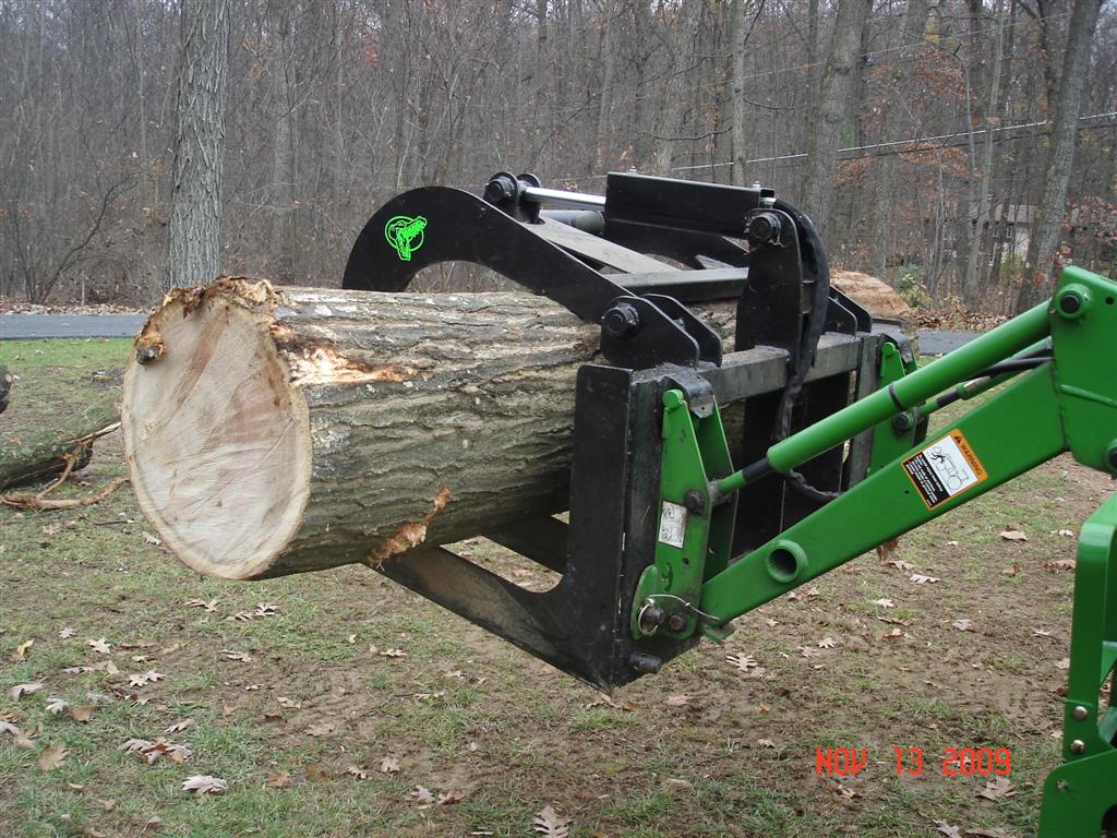

I have an 09 4320 with a 400X loader. I want to put a grapple bucket on the loader to help clean up some wooded areas around the house. I have looked at "The Thumb" online, is this the best solution? Or does Deere make a grapple bucket that I could just "change" out? Which is the best? Give me some advice......

In my opinion, the "best" is a dedicated grapple, not a add-on "thumb"

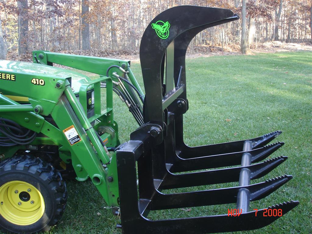

I have the Markham LD-48, cost was right at $1k delivered...it's a great deal.

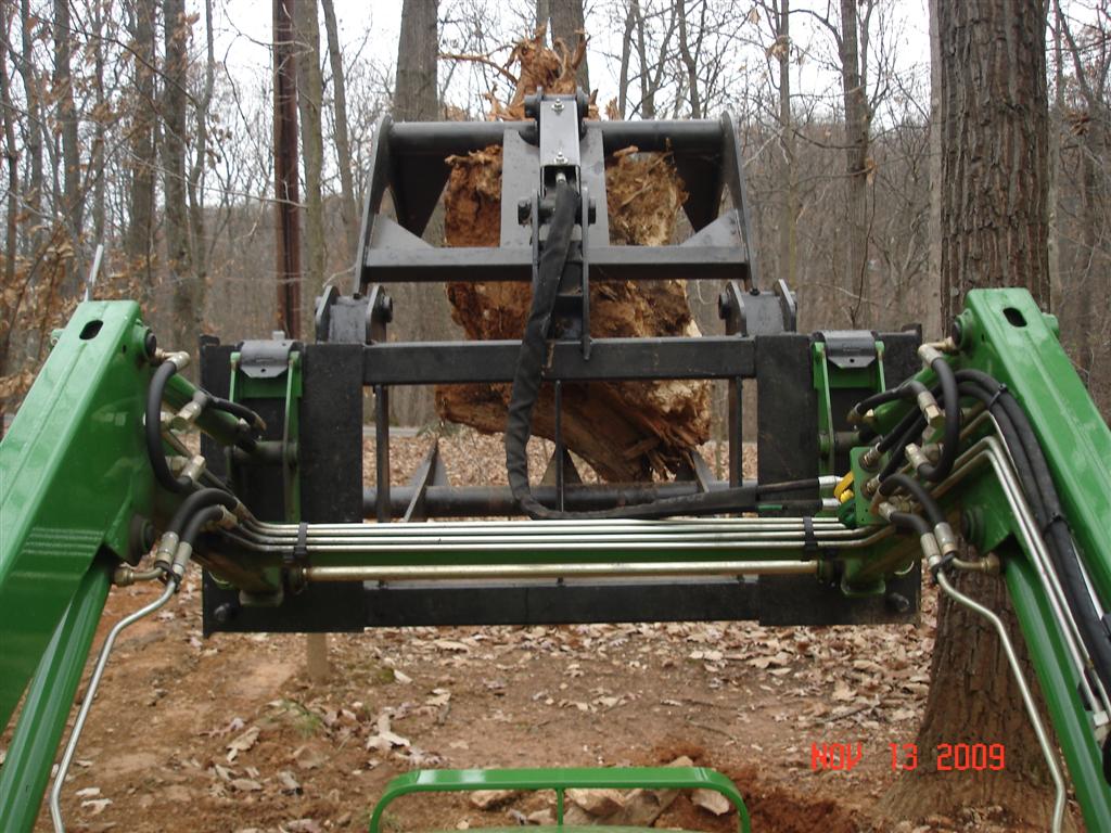

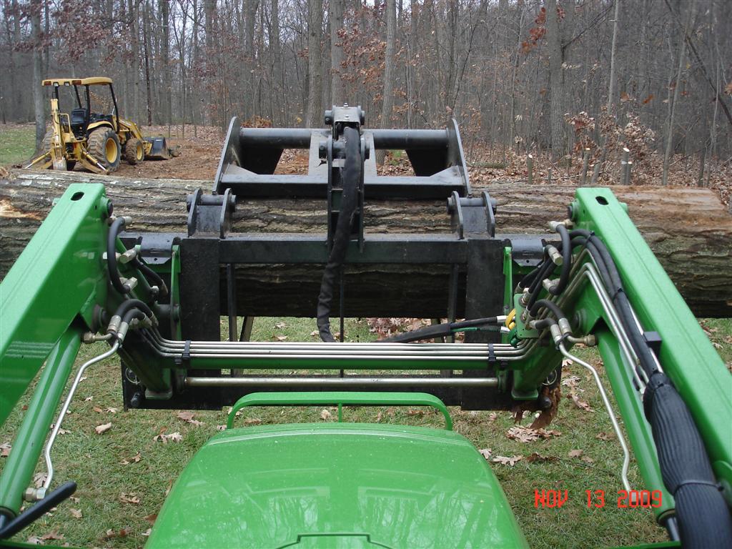

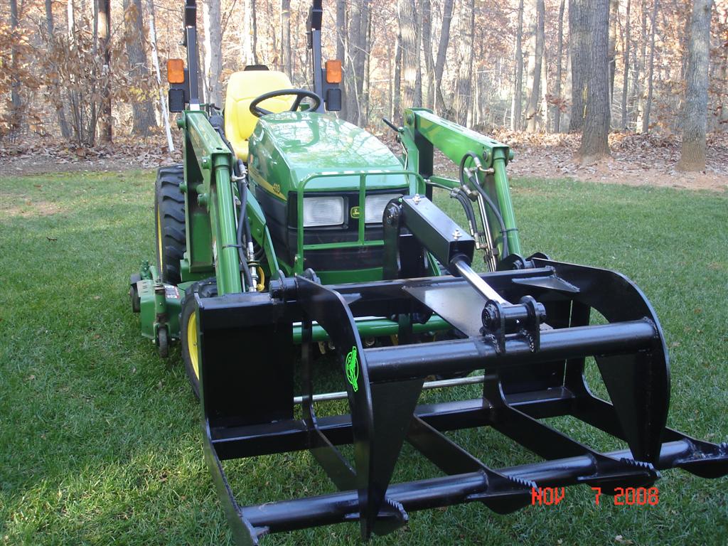

A few more pictures:

you have to have 2 auxiliary hydraulic valves on the FEL

You need the 3rd scv installed and the hardline kit that runs to the end of the loader arms.

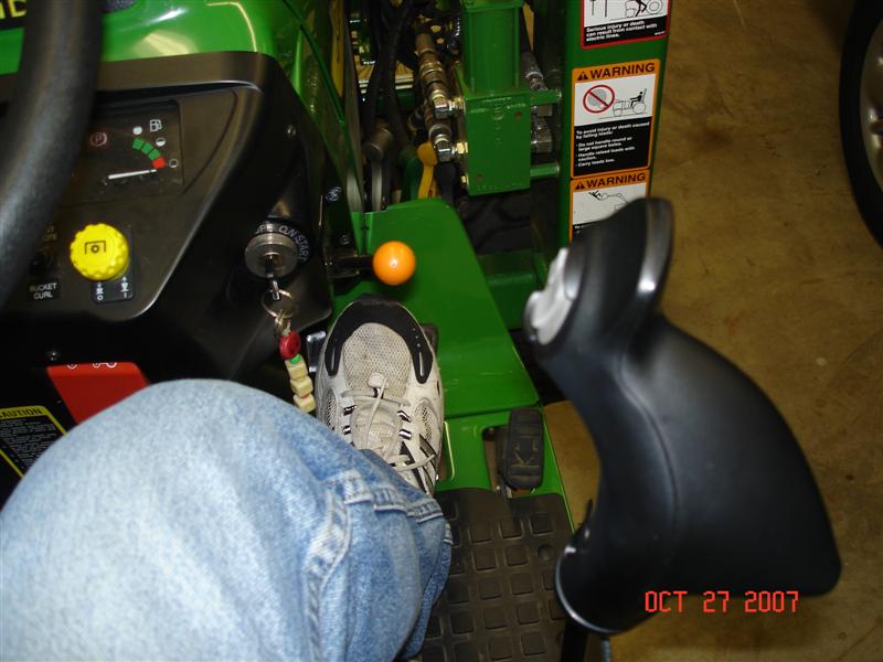

this is what I have to operate the grapple

Frontier grapple bucket around $2300,diverter valve - $350,less if you get at surplus center,control handle for loader - $70,hydraulic lines from john deere - around $250-300 for kit

There is a kit from JD to extend the rear remote coupler up to the mid section where the FEL couplers are, and then up the loader boom. It's a complete bolt on kit and very easy to install.

yes,I know you could use the rear remotes.I also have that kit but for me,it's easier to use the control knob on loader handle.

Where did you get that handle for $70? I paid $175.00 for mine!

The knob was from a takeuchi mini excavator which I modified to fit the tractor
